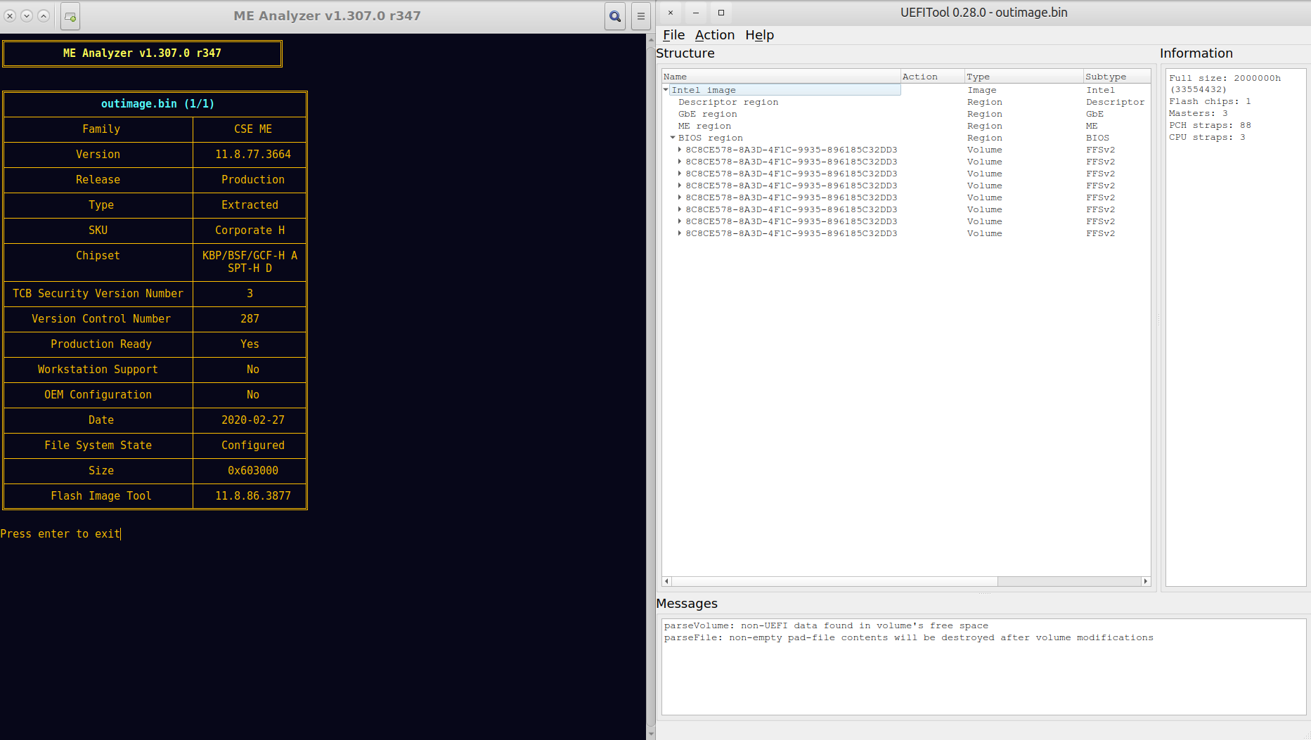

      I have to be very surprised because no one noticed that the original BIOS uploaded here is total junk.
      The user should first learn to correctly read out and compare a BIOS file.
      But now he has already overwritten his BIOS, which is very bad because he no longer has a functioning original.
      Everything that was patched is based on its bad original BIOS.
      And now they say it doesn't work, now it can't.​
        Blaze Tech and hoaca388 carried out the patch correctly, it just won't help because the initial BIOS arrived here already damaged.
        The patching doesn't check the correctness of the original BIOS file.
        I just want to make it clear, not that anyone feels insulted.

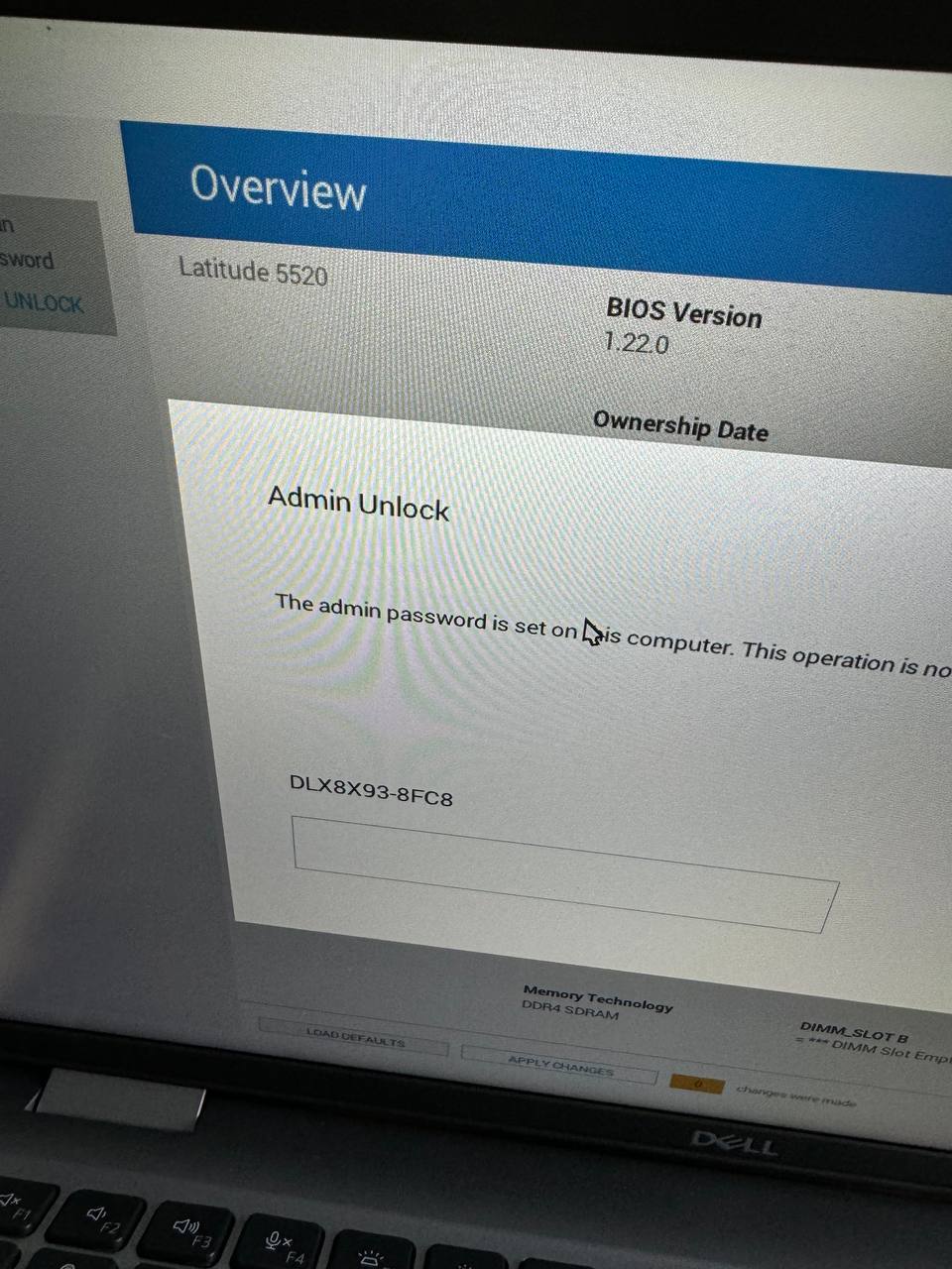

            Dell Latitude 5520 Bios Password 8FC8
            Please help me unlock. Tks so much.

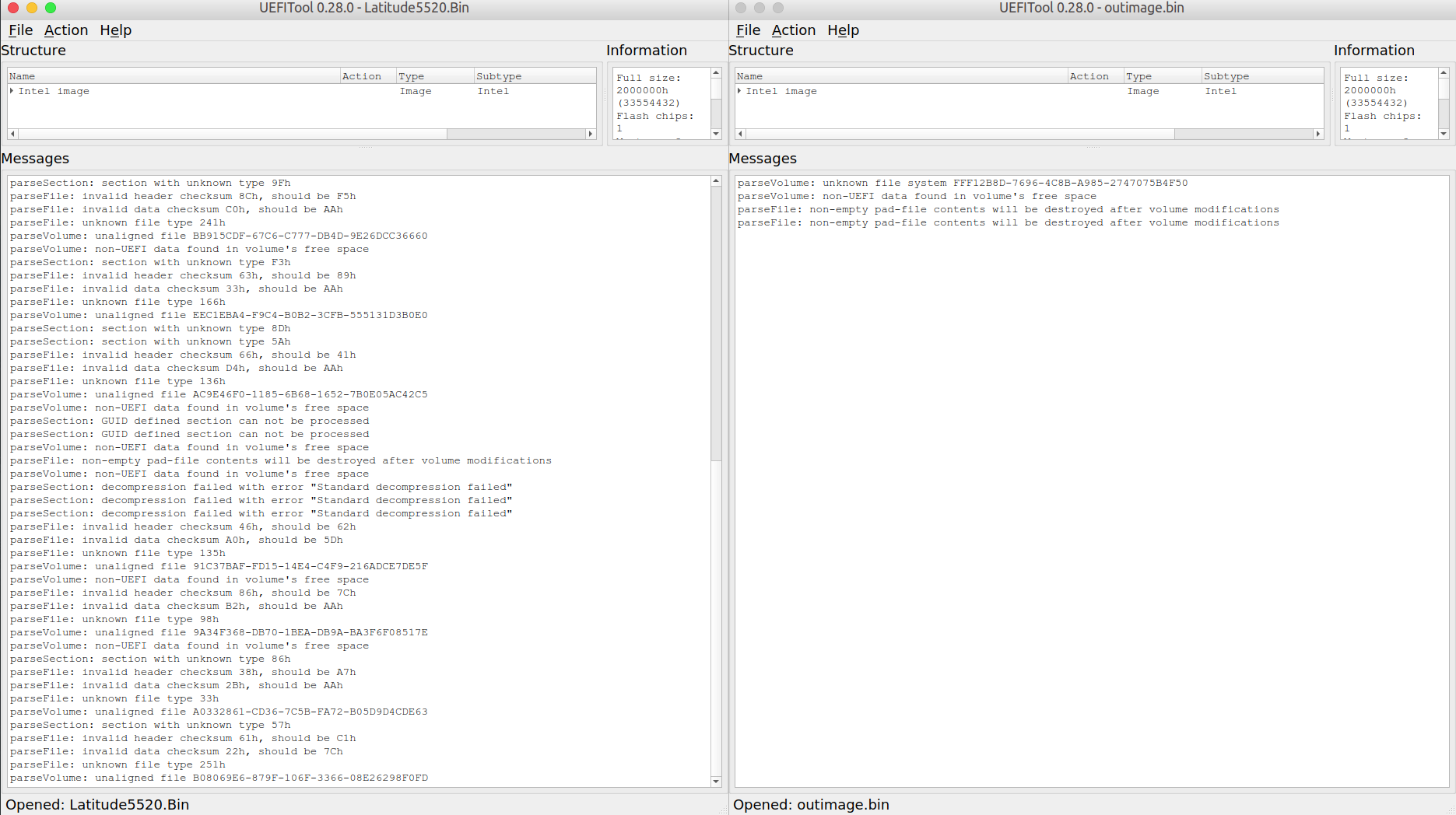

                  Unfurtunelly no post. I think something go wrong when i read the bios chip ,becouse laptop did not post with unlocked bios and did not post with original dump. Can anybody help?

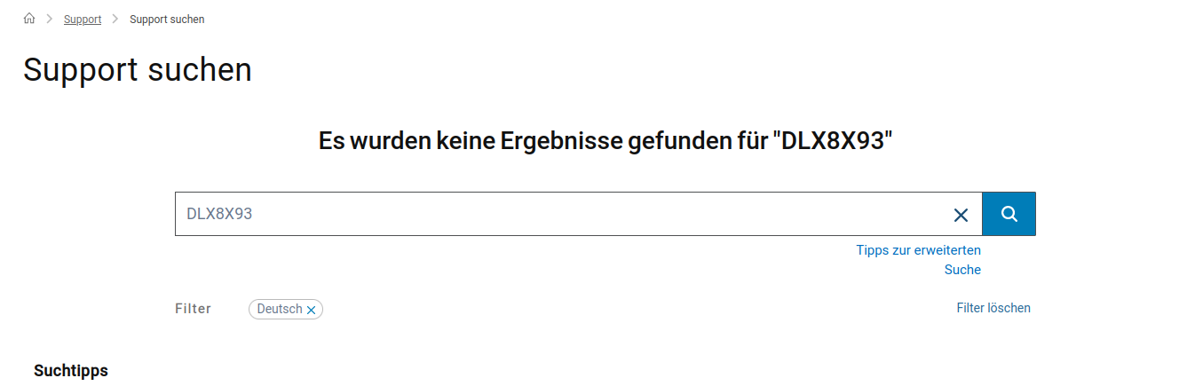

                      Can't find anything at Dell under your service tag DLX8X93? It should look like this.​
                        I am also surprised but I took a photo before flash bios

                            I try this dump on 3 different bios chip but laptop did not power on.

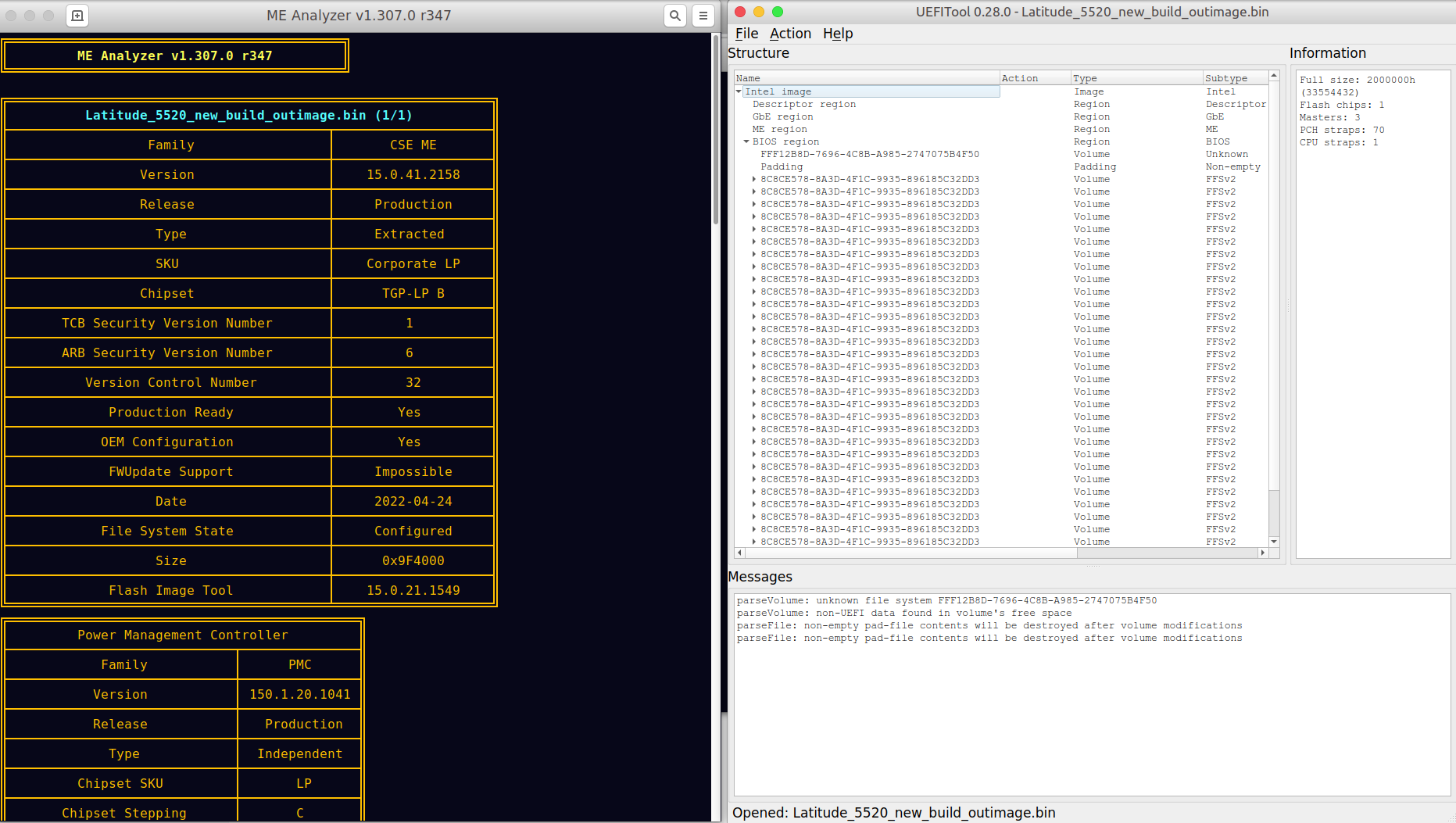

                                Oh there seems to be something mixed up, ME region of outimage.bin = 11.8.77.3664 that doesn't match a Dell 5520 notebook that has version 15.0.41.2158

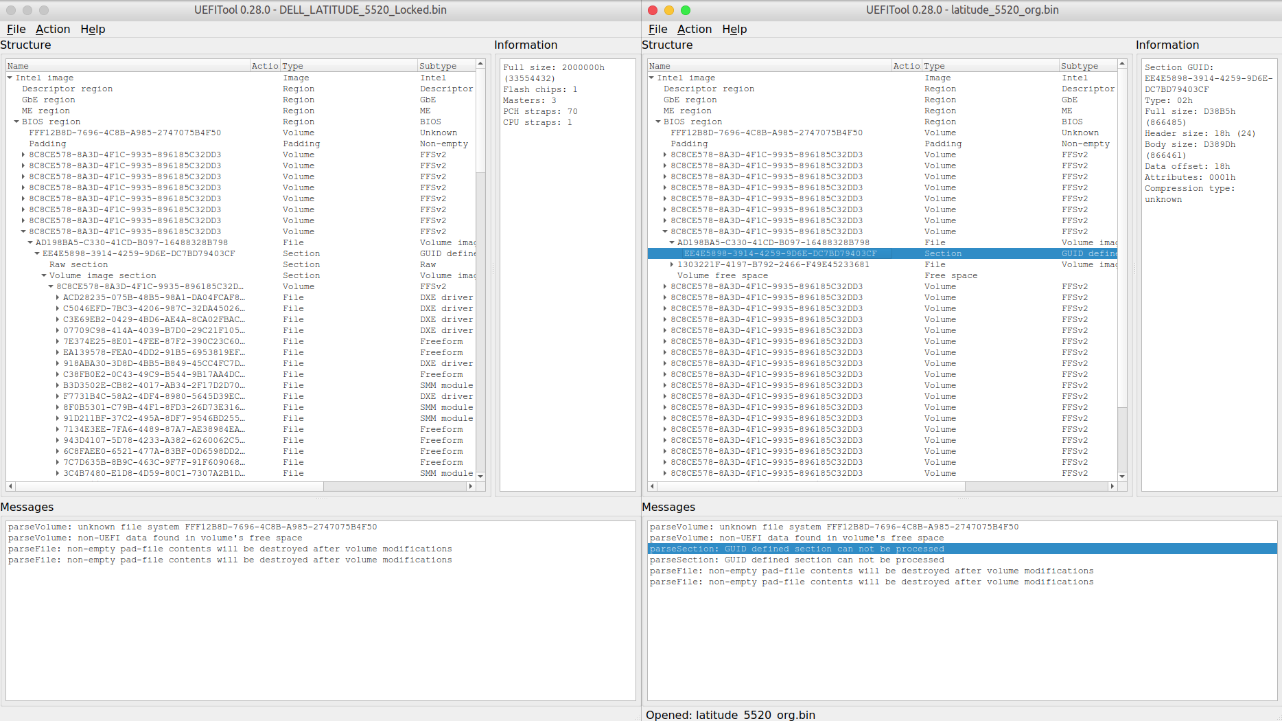

                                    try this one
                                      It works!!! No password, clean service tag. Thank you!!! .This laptop loves me 3 days . You is my saveour
