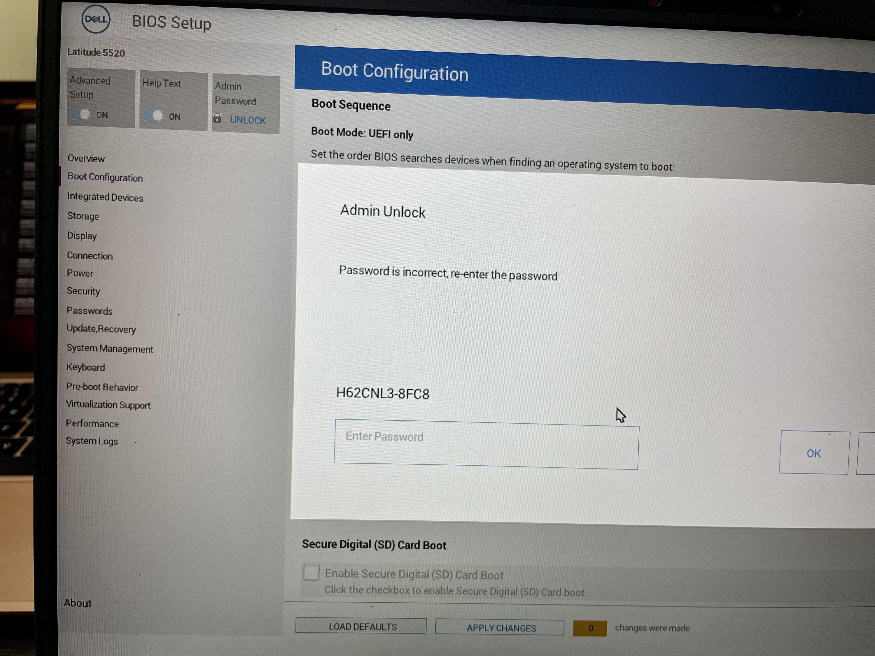

                      #270
                      Re: Dell Latitude 5520 Bios Password unlock
                      Hello geniuses, I have a Dell Latitude 5520 with an admin lock on the bios that I want to remove.
                      Service Tag: H62CNL3
                      In the bios the Admin Unlock says H62CNL3-8FC8
                      Please help me unlock this and possibly remove the password. Thank you

                        #271
                        You need to dump your bios file and post it right here

                          #272
                          Ok, how do I do such a thing?
                          I'll be honest, I'm nowhere near as smart as you guys. Could you please direct me to something I can read that will tell me how to dump my bios file

                            #273
                            I've done some research. Am I correct in the assumption that I would need a CH341a programmer in order to dump the bios and flash it again?

                              #274
                              Yes, you are right.
