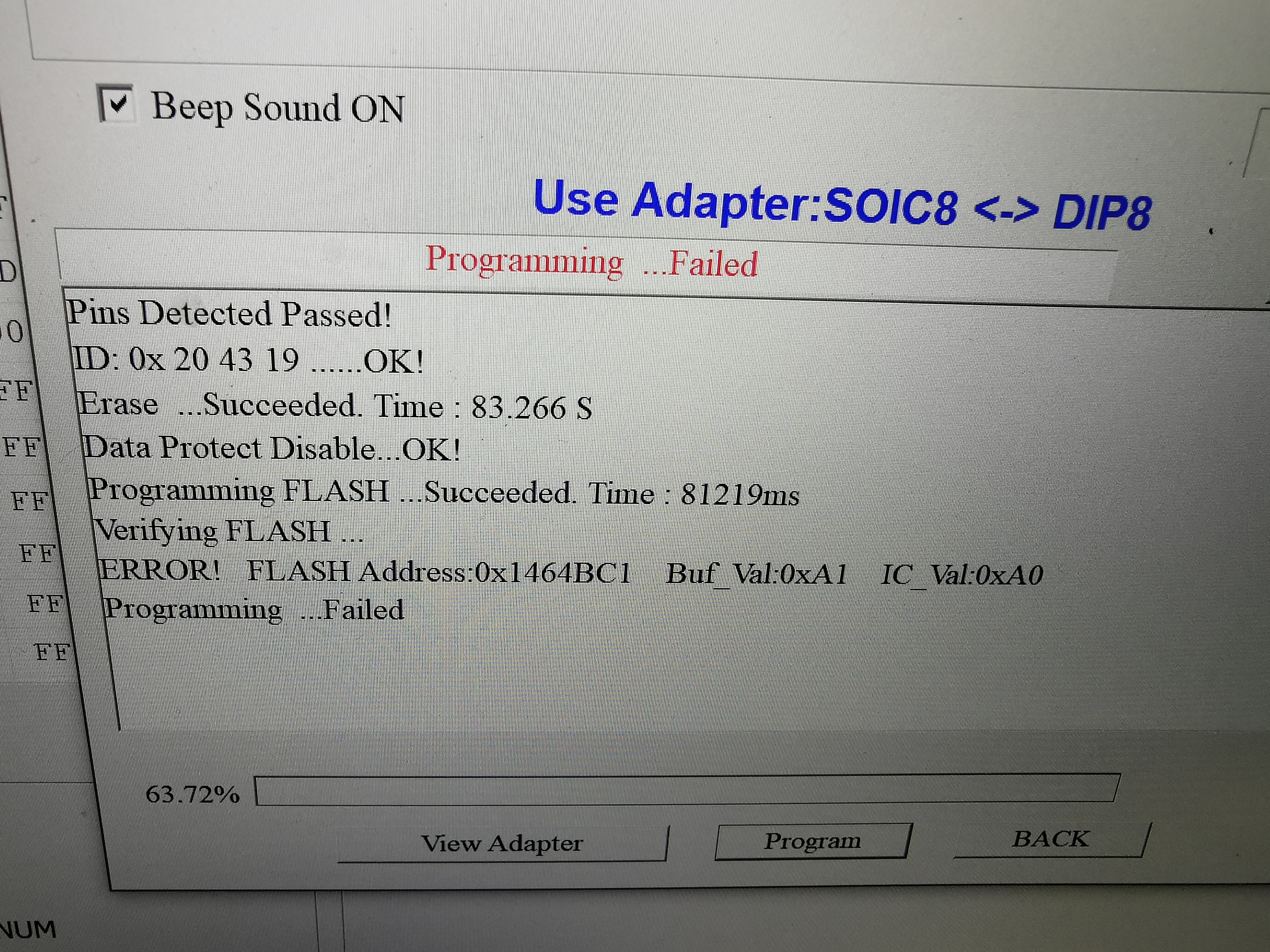

                #707
                Originally posted by SMDFlea
                Read the dell password topic, try the patcher https://www.badcaps.net/forum/troubl...33#post3693133
                thansk but after patch i have error
                • Stefan Steff
                  • Mar 2024
                  • 401
                  • Romania
                  #708
                  ...then try to program this patched dump.
                  If error persist then desolder the chip, program it and solder back.
