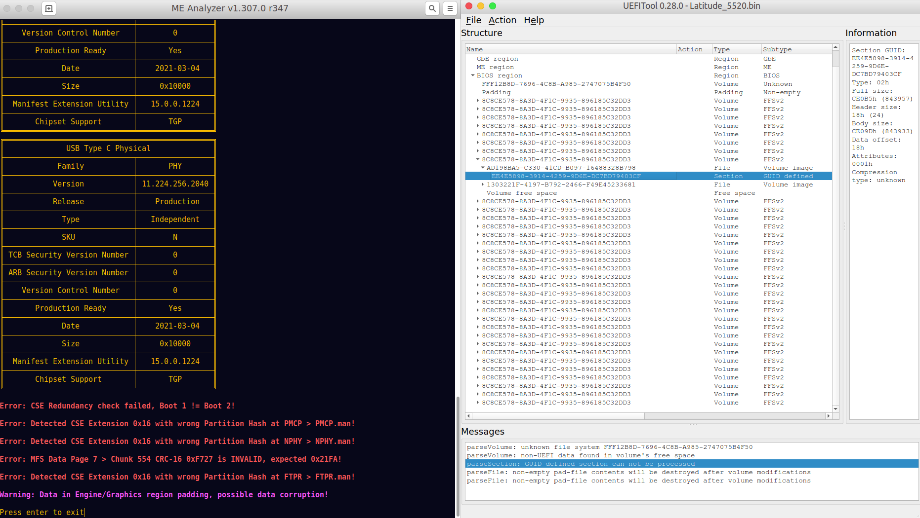

      Well, I don't know, but it's better not to check it first, I wouldn't program it like that.
      The original is already incorrect and so is the answer.
      This won't start anymore.​

        oh my god , you are right mybe its not correct i read it by siberia programme
        what ishould do now ?
        look at this binary file
        thank You

          The only explanation I can think of is that something goes wrong during the readout and this causes this error.
          parseSection: GUID defined section can not be processed
          Same result.
          Don't reprogram.
          Which programming do you use? CH341A​

            yes sebiria CH341
