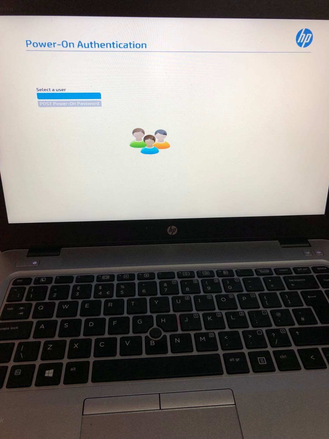

                                HP EliteBook 745 G4 TRAVOLTA-6050A2834601 MB A01
                                i have issue with Power-on Authentification
                                here are my original main and EC bios bin, please anyone can clear for me
                                THX

                                  #1336
                                  Re: HP BIOS unlock tool
                                  THX
                                  SOLVED
                                  i attach the working bios clean
