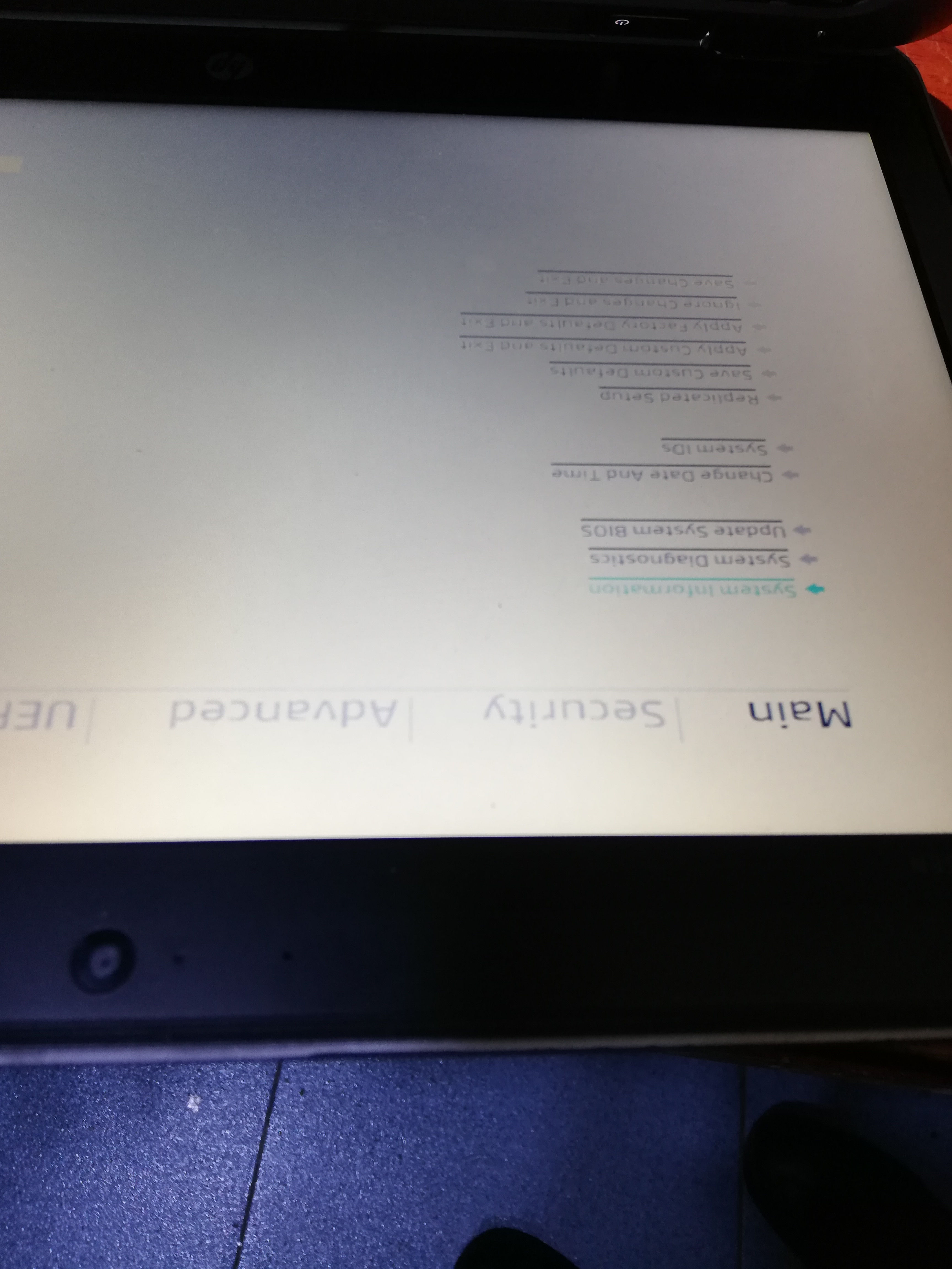

                    Thank you man !!! It worked perfectly with my HP elitebook 725 g3.... I have flashed the bios( 25Q128BV not the one near ram slots which is 25Q64BV) with the generated bin file after using HP Unlocker v_1. And here is the file if it cloud be helpful for someone.
                    • Titonic2020

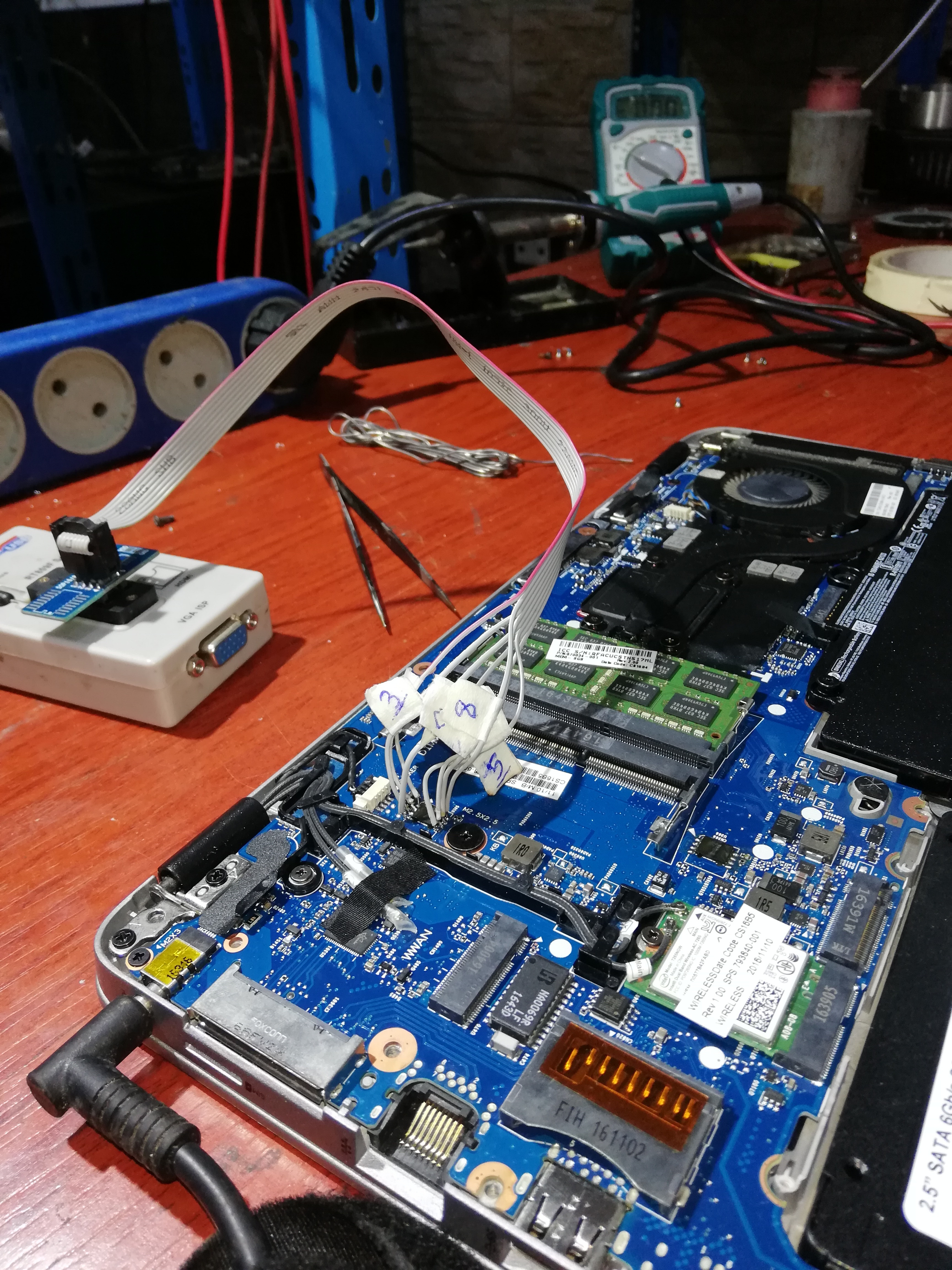

                        I cannot unlock the Bios of an HP EliteBook 840 G1 :
                        - With RCunlocker I got the error message "missing unlockable content" (However, I operated correctly on the 16 Mb Bios chip - Winbond 25Q16DVSIG - I can also read the serial number of the computer on it).
                        - With HP-unlocker, I have no error message, but the output _.unlocked.bin file is identical to the original file (same checksum).
                        I add that I started again several times.
                        Thanks.

                          I answer myself: I had simply chosen the wrong chip; for an EliteBook 840 G1, you must operate on the “Micron N25Q128A” chip.
                          I was able to unlock the computer with RCunlocker.​
