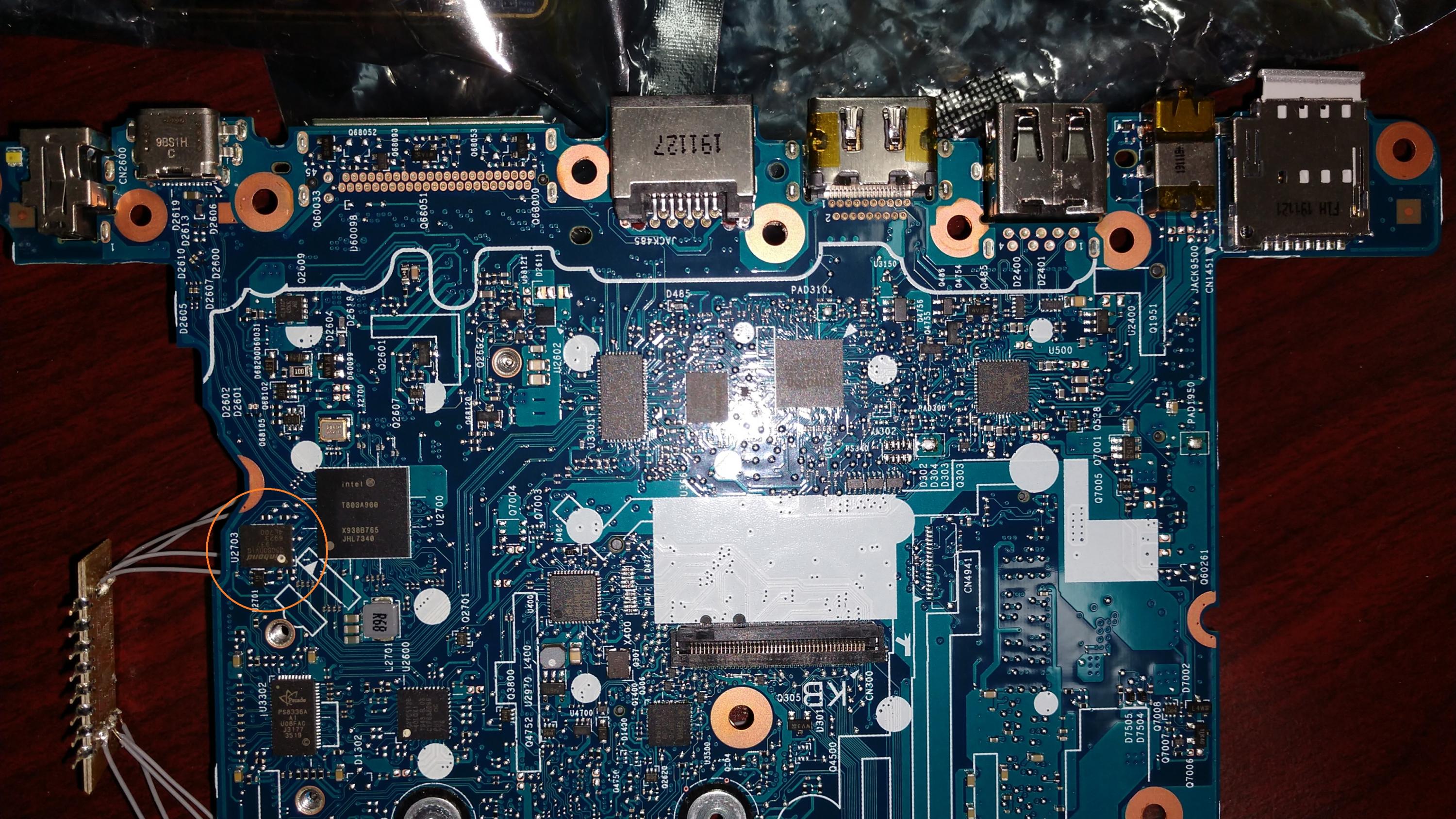

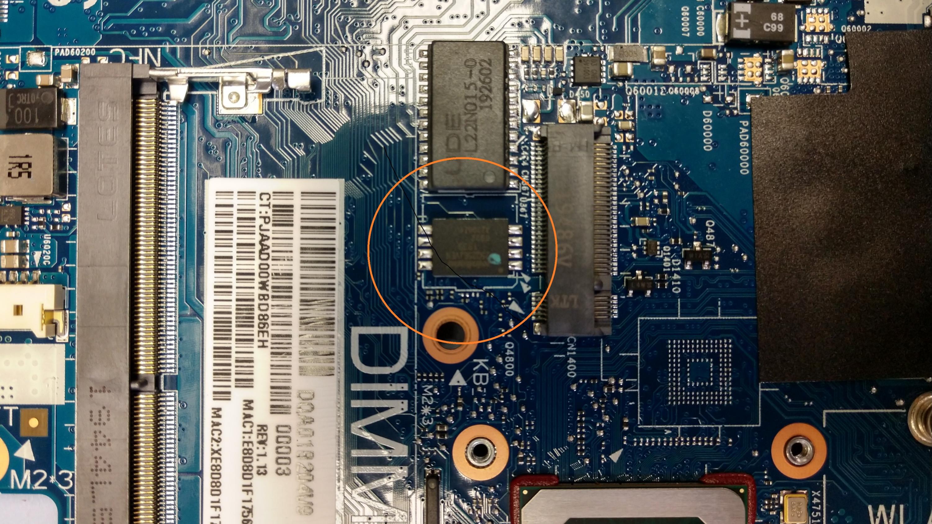

                      I need help with My HP 830-G6. I posted a few months back and now getting back to this project.
                      Can someone tell me which Chips on my HP 830-G6 I need to take off and read-back? I actually have 3 WINBOND EEPROMs on the board and I have no idea which ones are the BIOS. I believe one the main on is on the FRONT side and is the one with the BLUE dot but there are 2 additional EE's on the board and I'm not sure which one I need to read.
                      There is a 256Mb EE (BLUE Dot) on the FRONT of the mother board near the MEMORY, and there are 2 EE's on the BACK of the motherboard, one is U2703 (8MB) and the other has no reference designator but is also 8Mb. Pictures are attached.
                      Any guidance on which ones to de-solder and read out would be greatly appreciated.

                        #631
                        Re: HP BIOS unlock tool
                        check post #2 i think he have given number of both bios chip
                        https://www.badcaps.net/forum/showth...ight=HP+830+G6

                            #633
                            Thanks qayyum786.
                            Can someone check and clean the attached file for Elitebook 830-G6 from my 256MB WINBOND EE?
                            • RethoricalCheese
                              • Mar 2013
                              • 1519
                              • Estonia
                              #634
                              Thanks qayyum786.
                              Read and post the other bios chip.

                                        • Kilroy2020
                                          • Oct 2020
                                          • 7
                                          #640
                                          Both files are attached.
                                          I really appreciate the help!
