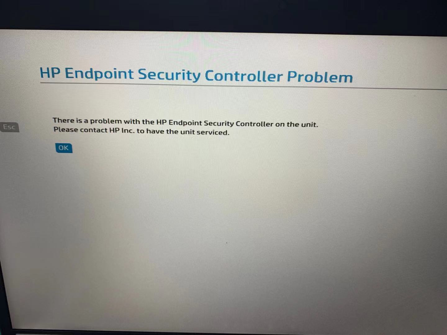

      Re: HP BIOS unlock tool
      Hi
      The original BIOS BIN file wasn't read properly from us for some reason, so we did it again and verified the one is correct this time. Sorry for your time and thanks again for your help.
      HP Elitebook 840 G6
      Error message:
      "HP Endpoint Security Controller Problem
      There is a problem with the HP Endpoint Security Controller on the unit
      Please contact HP Inc. to have the unit serviced "

                        HP BIOS unlock tool
                        Hi
                        Can you please help on the below:

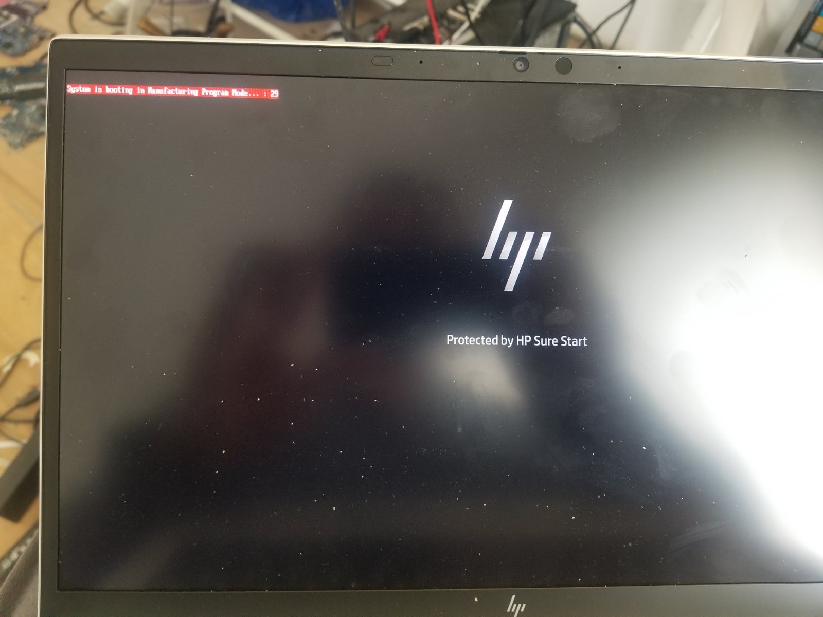

                        HP Elitebook 840 G6
                        Error message:
                          Originally posted by vk123
                          Hi
                          HP Elitebook 840 G6
                          Error message:
                          Hi, thanks for your try. But it's still doing the same after reprogramming with your modified BIN file. Can you please advice how to do next?
                          Cheers!

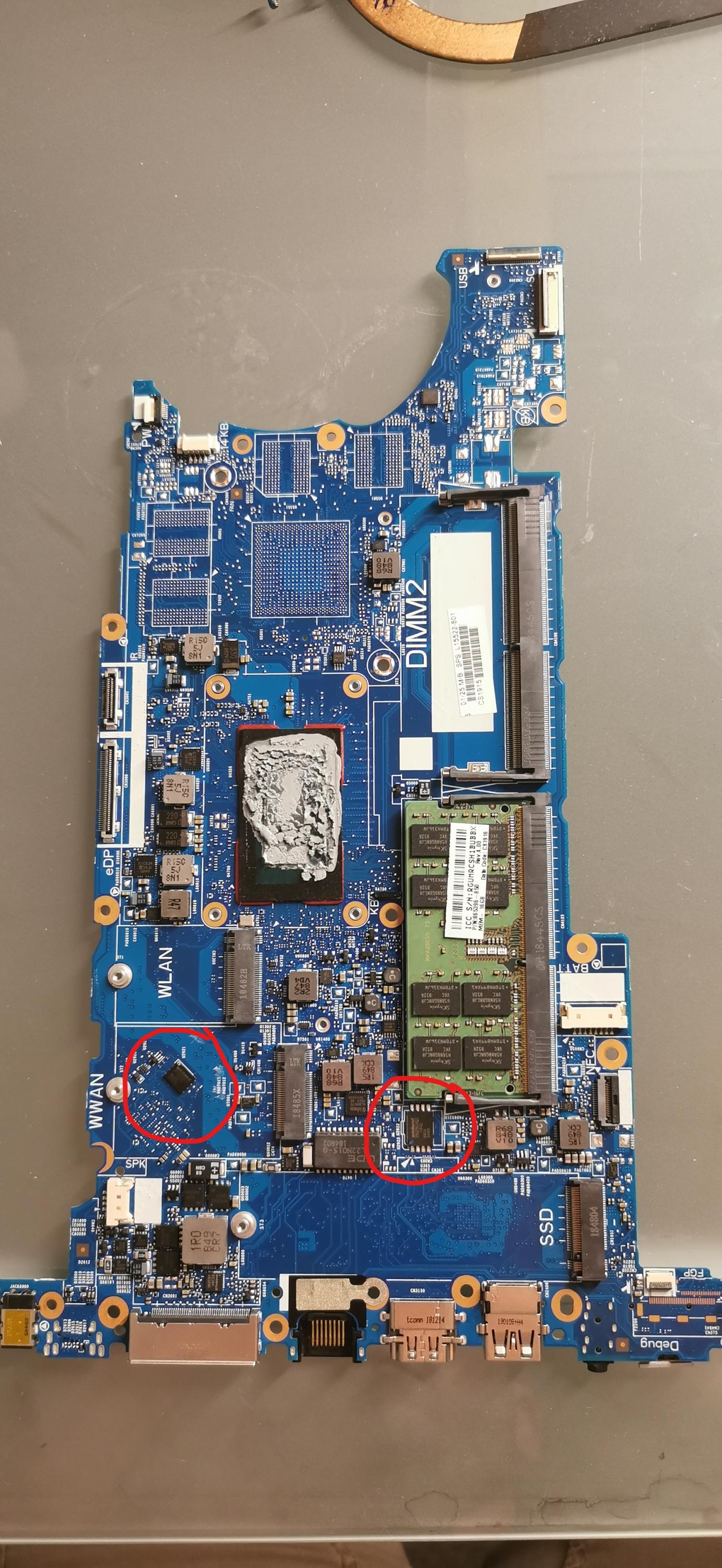

                            #833
                            • leva2407
                              • Jul 2016
                              • 89
                              • tbilisi
                              #834
                              Originally posted by peste
                              try this ..you still have a 16MB bios chip on the motherboard..make a copy check it with the HxD program and write the 16MB bios chip sent .. look for the 16MB bios chip on both sides of the motherboard ..
                              after programing this dump

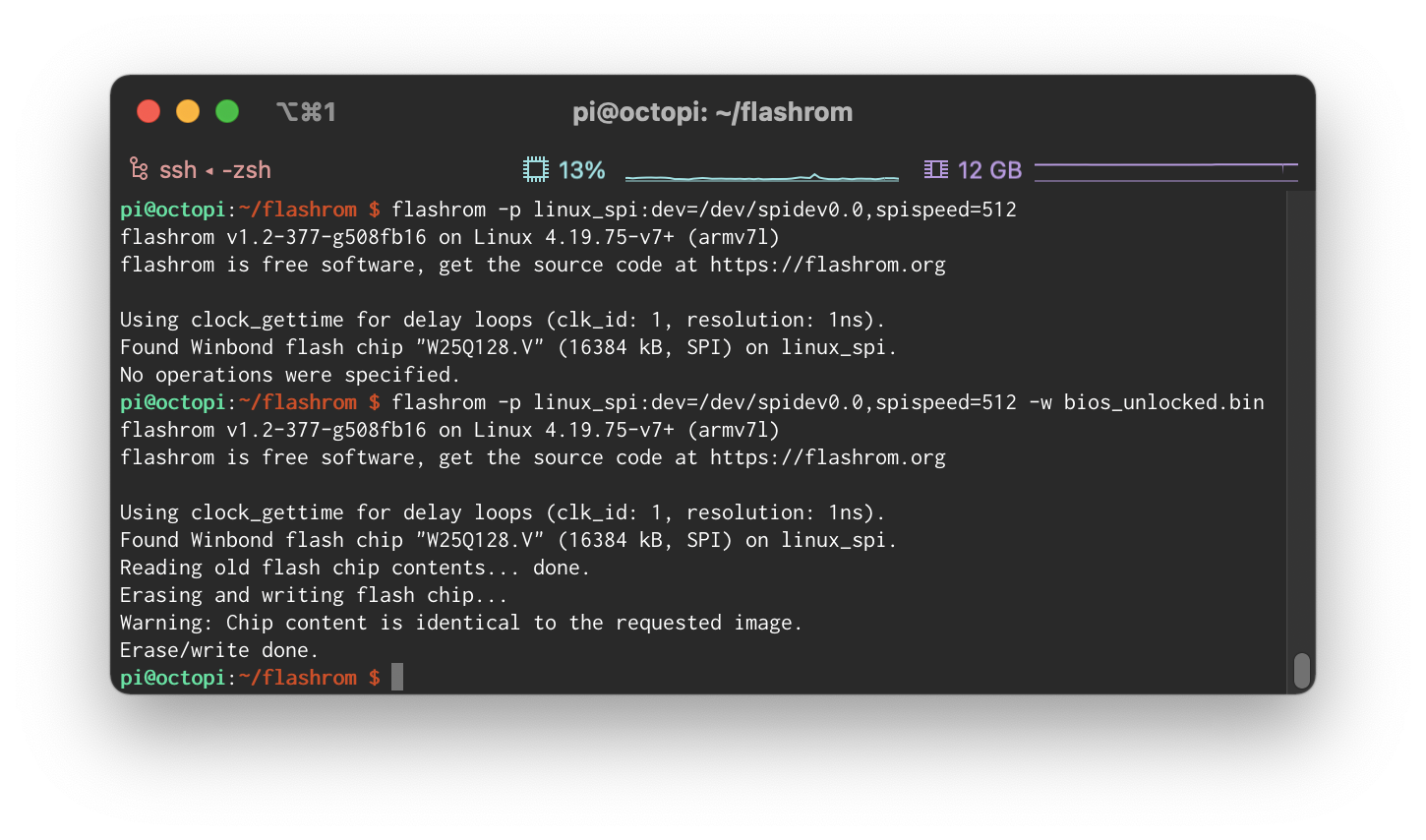

                                    I have a HP ZBOOK 15 G3.
                                    BIOS Winbond 25Q128FVSQ chip
                                    Battery, BIOS Battery and Power Supply Disconnected first.
                                    I used the following Programmer: CH314 mini programmer black with the clip.
                                    ASprogrammer 1.4.1 version
                                    Read bios, Verify, use unlocker tool, Erase bios chip, Write unlocked version
                                    Connect power supply & BIOS Battery, after 3 restarts it worked..
                                    Thank you for all the information.
