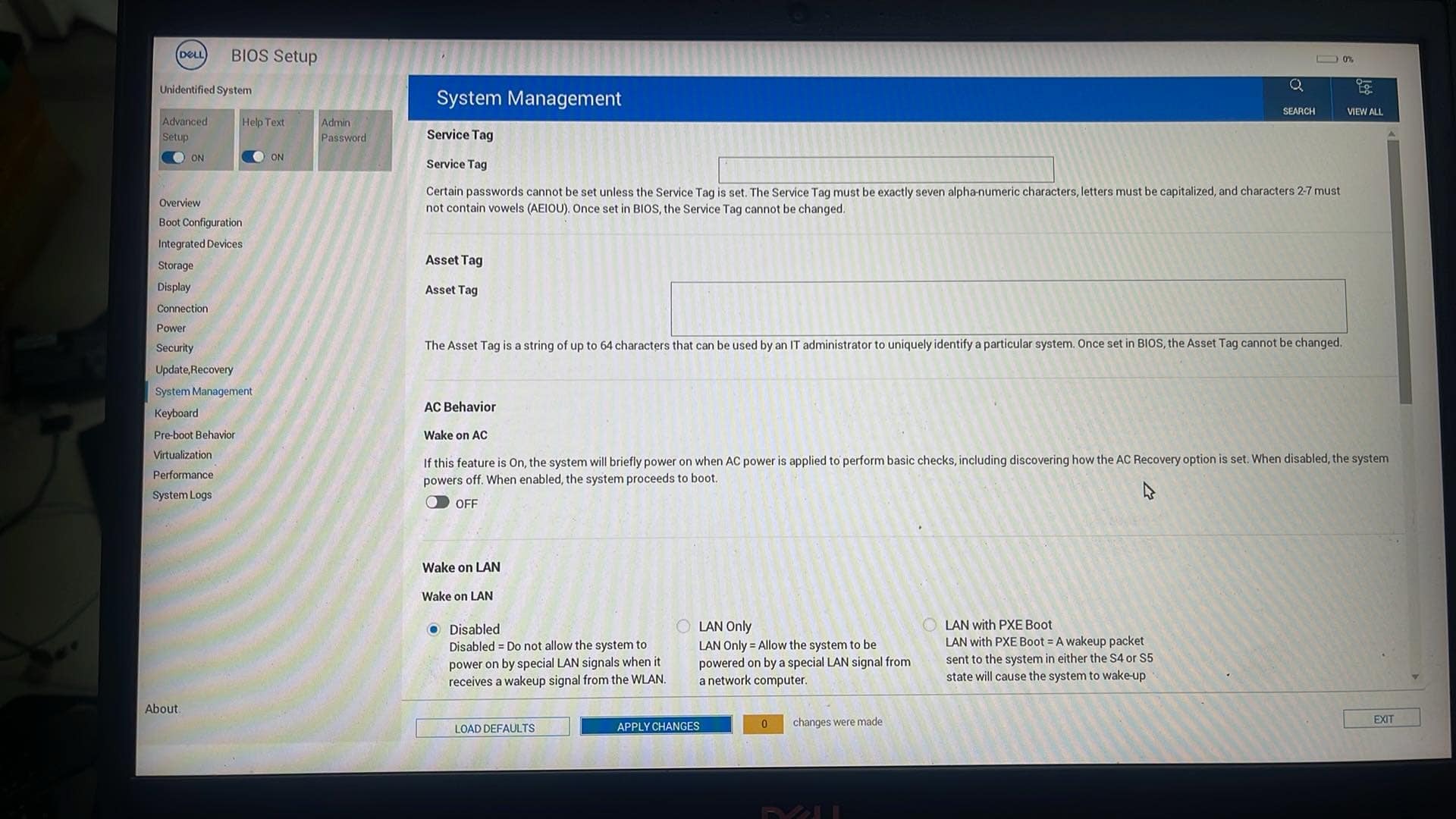

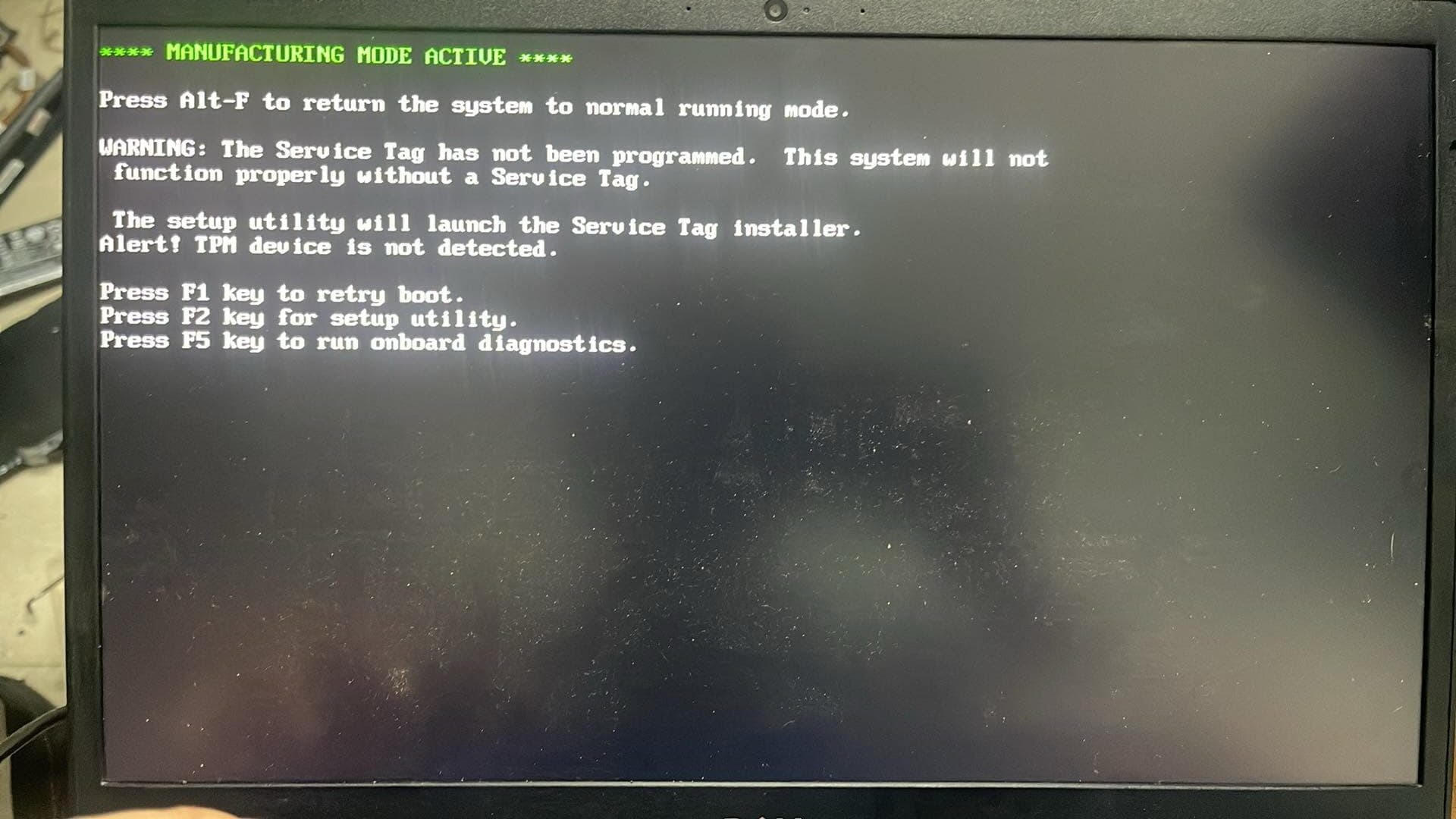

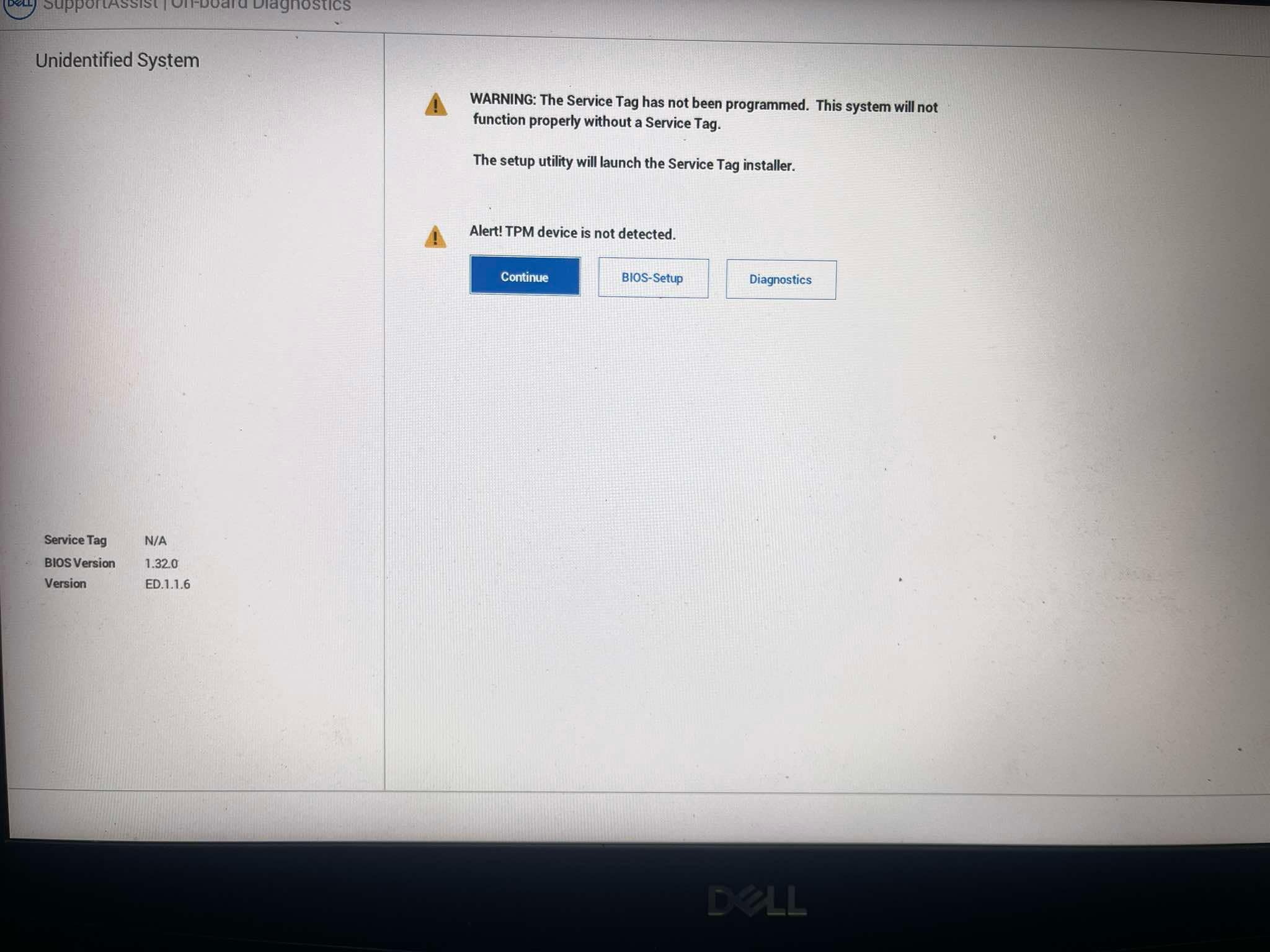

                              Originally posted by danito
                              try
                              it can not save svtg and fan full
                              • qayyum786
                                • Aug 2018
                                • 1958
                                • INDIA
                                #177
                                Add service tag manually from bios setup save
                                next boot press Alt+F to exit manufacturing mode
                                • tonnum2
                                  • Feb 2018
                                  • 5
                                  • thailand
                                  #178
                                  How do I flash it? There's only one. not have 2 file 8mb and 16mb
