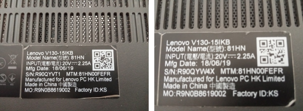

                      I got two Lenovo V130-15ikb laptops from a small elementary school; I'm going to try to get them up and running again.
                      When switching on, only the capslock button is permanently lit and the power button, fans turn but no image
                      the 2 shells with their labels and serial numbers R90QYVT1 and R90QYW4X have been separated from the motherboards in the hope that there won't be a third laptop in the game.
                      I tried to extract the S/N by myself with tools (ifrextractor/UEFIextractor) but it's way beyond my skills.
                      Thanks for welcoming me and I hope to find some help here.

                          #132
                          Thank you
                          V130-15IKB Laptop (Lenovo) - Type 81HN
                          S/N: R90QYVT1
                          MTM: 81HN00FEFR
                          S/N: R90QYW4X
                          MTM: 81HN00FEFR

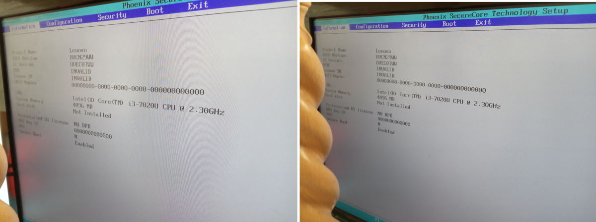

                              #134
                              Hi peste, I've never been so excited about a BIOS screen; these 2 screens will soon be putting smiles on the faces of pupils (and teachers, of course); I think there's now one last step for the indispensable Windows licenses.
                              Click image for larger version  Name:	IMG_2025-05-14-10-36-56-681.png Views:	0 Size:	687.3 KB ID:	3636799
                                • 22293
                                #135

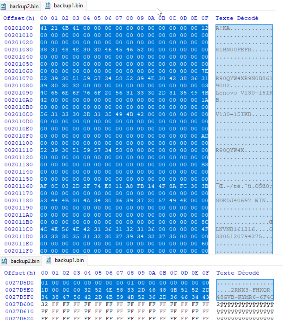

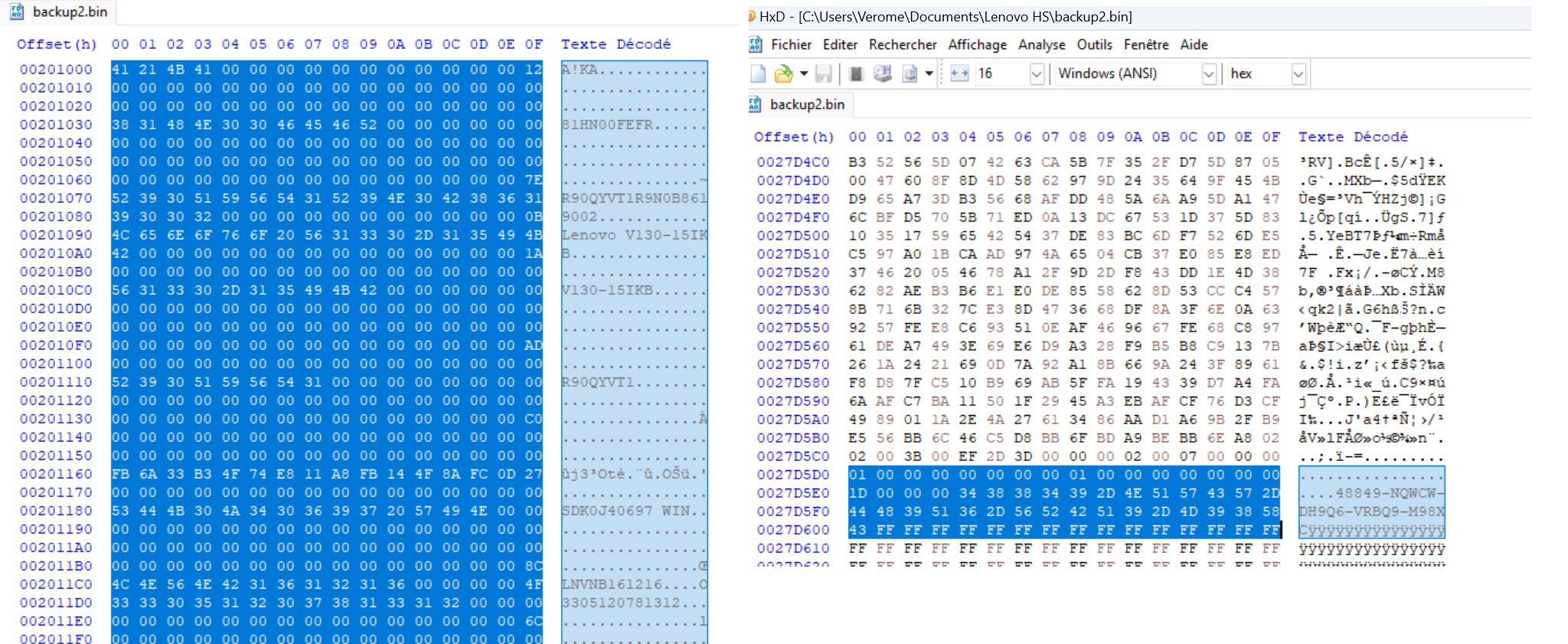

                                  #136
                                  Originally posted by SMDFlea
                                  Use this macro script to copy the DMI (win key, serial etc) from your backups to the new bios https://www.badcaps.net/forum/troubl...55#post1774855
                                  Thanks for your help.
                                  Here's what I think I understood: I dragged and dropped the official bios update 8vcn31ww.exe file into innoextract.exe, which generated 8VCN31WW.cap.
                                  Following your instructions, I don't understand what I'm doing or what I should do now.
                                  I'm lost, but by re-reading the forum I've finally discovered the important lines 201000 (S/N) and 27D5D0 (Winkey). I see that I'm pretty close to the result, but I'm much less agile with a computer than with a chisel and sledgehammer on the vault of Notre Dame de Paris.
                                  Would you please be more didactic and suggest a bios for me to test?​
Name:	SN_WinKey_HxD - [backup1.bin].png
ID:	3636946 Click image for larger version
Name:	SN_WinKey_HxD - [backup2.bin].png
