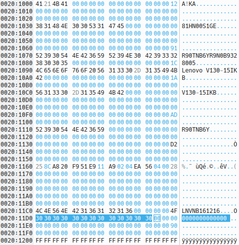

            Hello everybody!
            There is BIOS in the attachment, which don't work (only CapsLock LED after power on).
            I've tried to use BIOS from this thread (Orig+8VCN29WW+outimage+DMI) with my DMI, but my laptop was without pre-installed Windows and binary data at the offset 0x27D5D0 is very different from the sample file.
            Could somebody help me with this BIOS?
            Thank you in advance!

              #66
              Re: Lenovo V130-15IKB bios dump
              Originally posted by Sergii
              Hello everybody!
              Try this file and let me know.

                #67
                Unfortunately, now even Caps Lock does not light up when you turn it on.
                The notebook does not respond at all

                    #69
                    Originally posted by hoaca388
                    Try this file
                    The same: laptop does not start at all.
                    If I press power button for more than ~5 s, then LED near power cable switched off and on again (it was also with firmware from previous message).
                    Is it possible, that my DMI section is broken (see selected 000..00 in attached file) and I should use image with empty DMI?

                      #70
                      Program back your original backup and see if the caps lock blinking as before or the device still dead.
