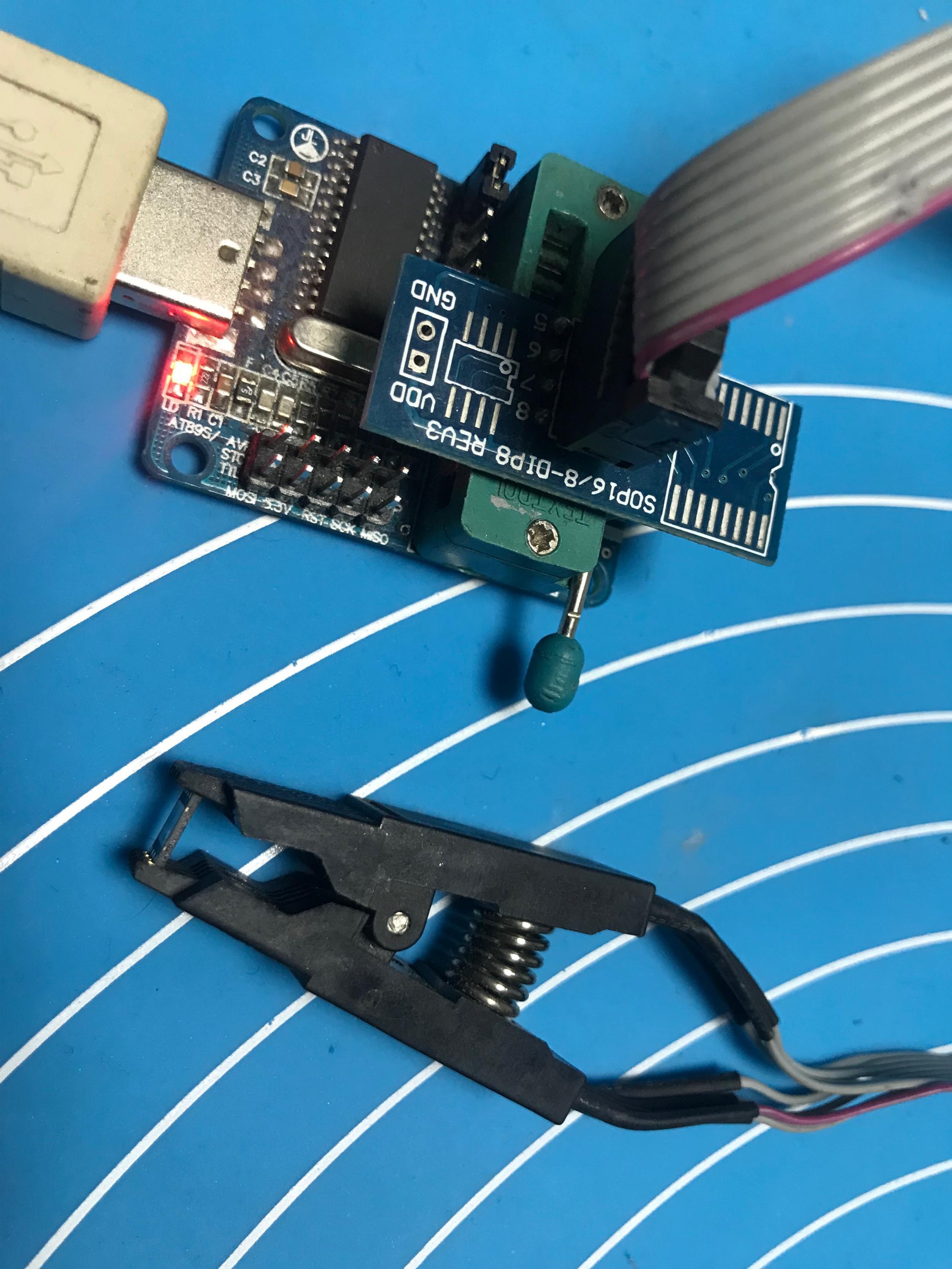

    Good afternoon!
    I'm sorry, I really don't know how to generate the dump file?.
    Do you recommend any procedure?
    Thank you again for your attention
    • lapfix
      • Mar 2020
      • 2765
      • my workshop
      #42
      Re: Dell 7300 locked bios
      Originally posted by senhorodrigues
      Good afternoon!
      you must have a programmer , take a look here maybe it help you to understand more
      https://www.youtube.com/watch?v=Ta_PPndnCTk&t=169s

                      When I read the IC that looks like a bios chip on the motherboard the programmer identifies it as a Winbond W25Q80DV... but when I read the chip and save the data the file is only 1MB!!
                      I see the other posts are apx 10MB!
                      Am I reading the wrong chip? Or what else am I doing wrong?
                        • 22216
                        #51
                        Yes its the wrong chip. When you do find the right ones post them along with the service tag. https://www.badcaps.net/forum/showthread.php?t=103570
                        • martinnigm
                          • Aug 2023
                          • 2
                          • norway
                          #52
                          it's the WSON8 chip UC5, right? Need to wait another couple of weeks for a suitable adapter, then.. cause trying to attach the SOP8 clip will just end up breaking it...
