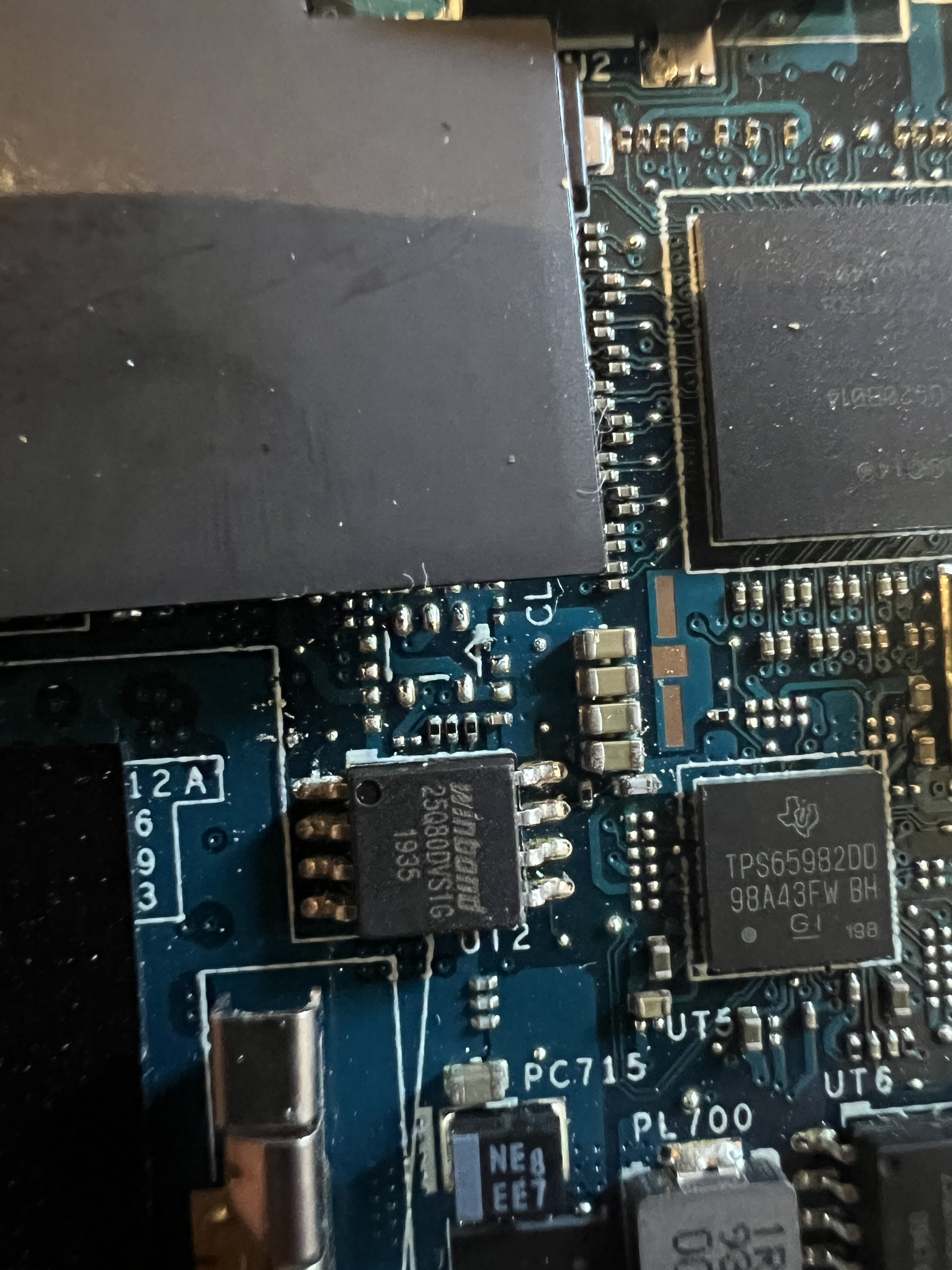

                can you unlock this file plz
                service tag 99VYY2
                  Yes, but you must add service tag to your post, this is forum rule.
                      sorry service tag
                      D99VYY2​
                      Files corrupted or wrong chip . Your bios file is 32MB , look for the chip with number 256 , for example 25Q256JV...
                        this is the chip?
                          this is the chip?
                          No, this chip only holds 1MB of data. Read the post above.
