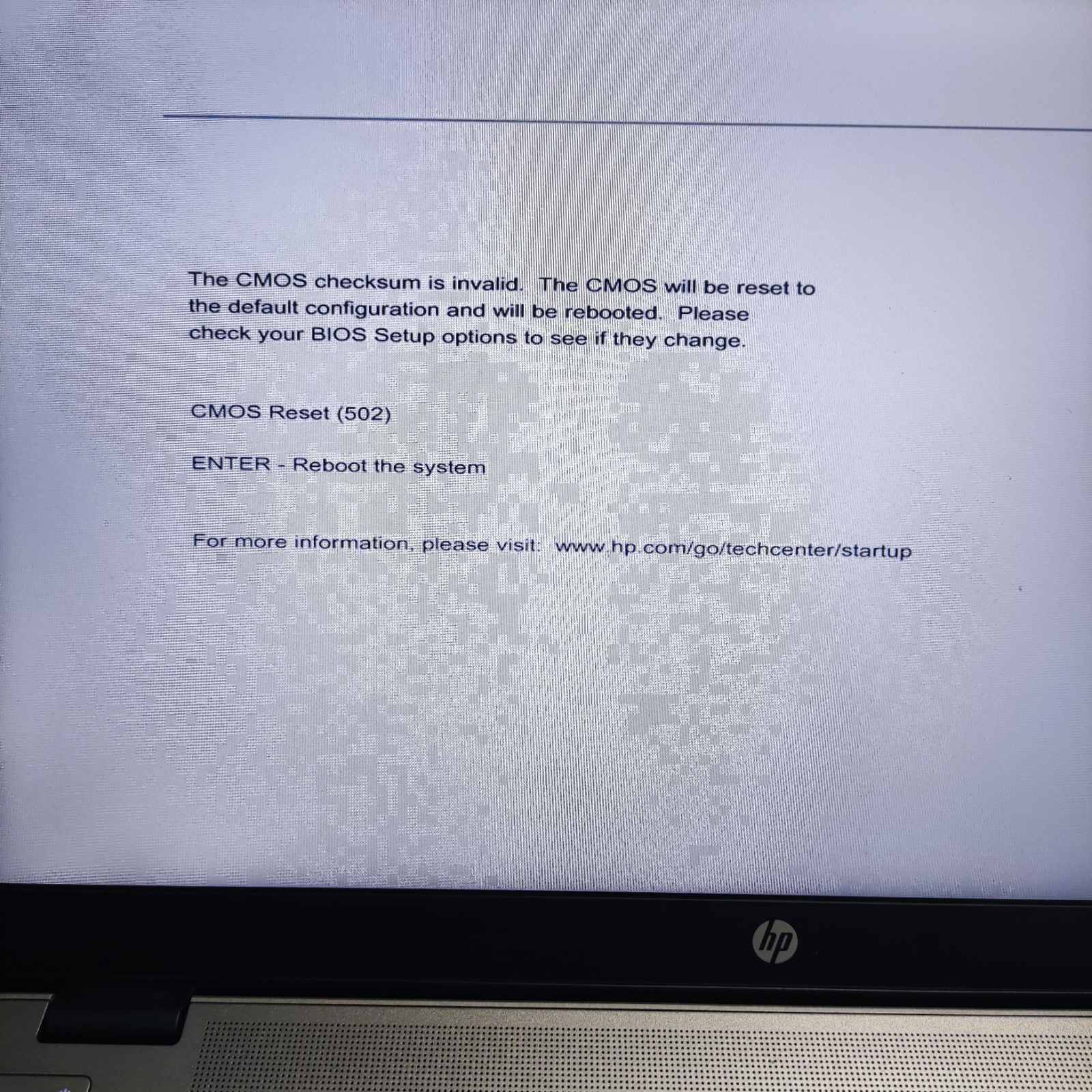

      Re: HP 850 G1 - Unlock Password
      Originally posted by peste
      if it doesn't work try this ..
      You didn't tell me,did you do anything with it? I mean the first one you posted was from Unlocker HP tool ?
      (It was the 1st thing that i did before opening the thread).
      So should i try the newest you have post ?

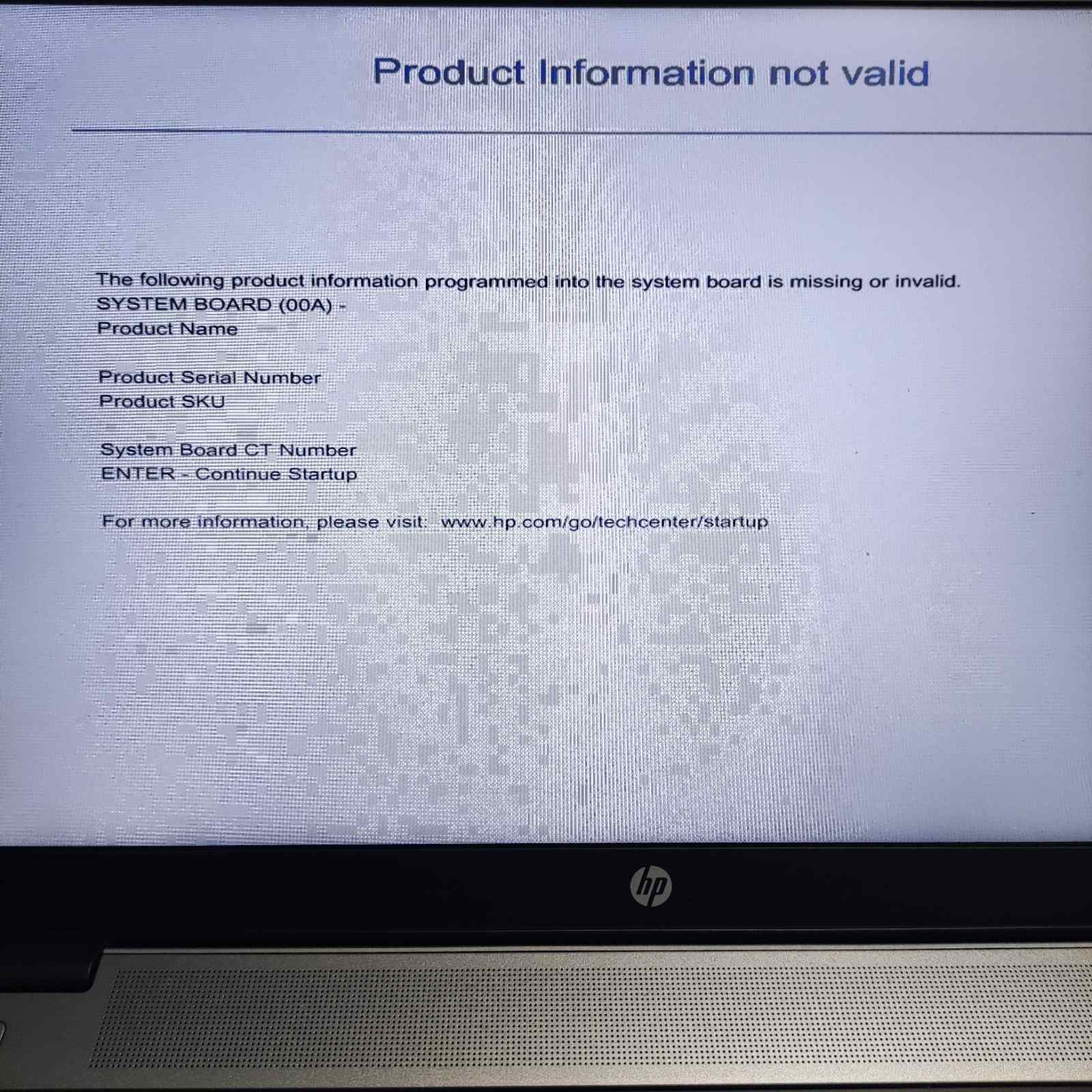

        We opened and all the , options are NOT grey any more.
        But i have lost everything in Serials etc.

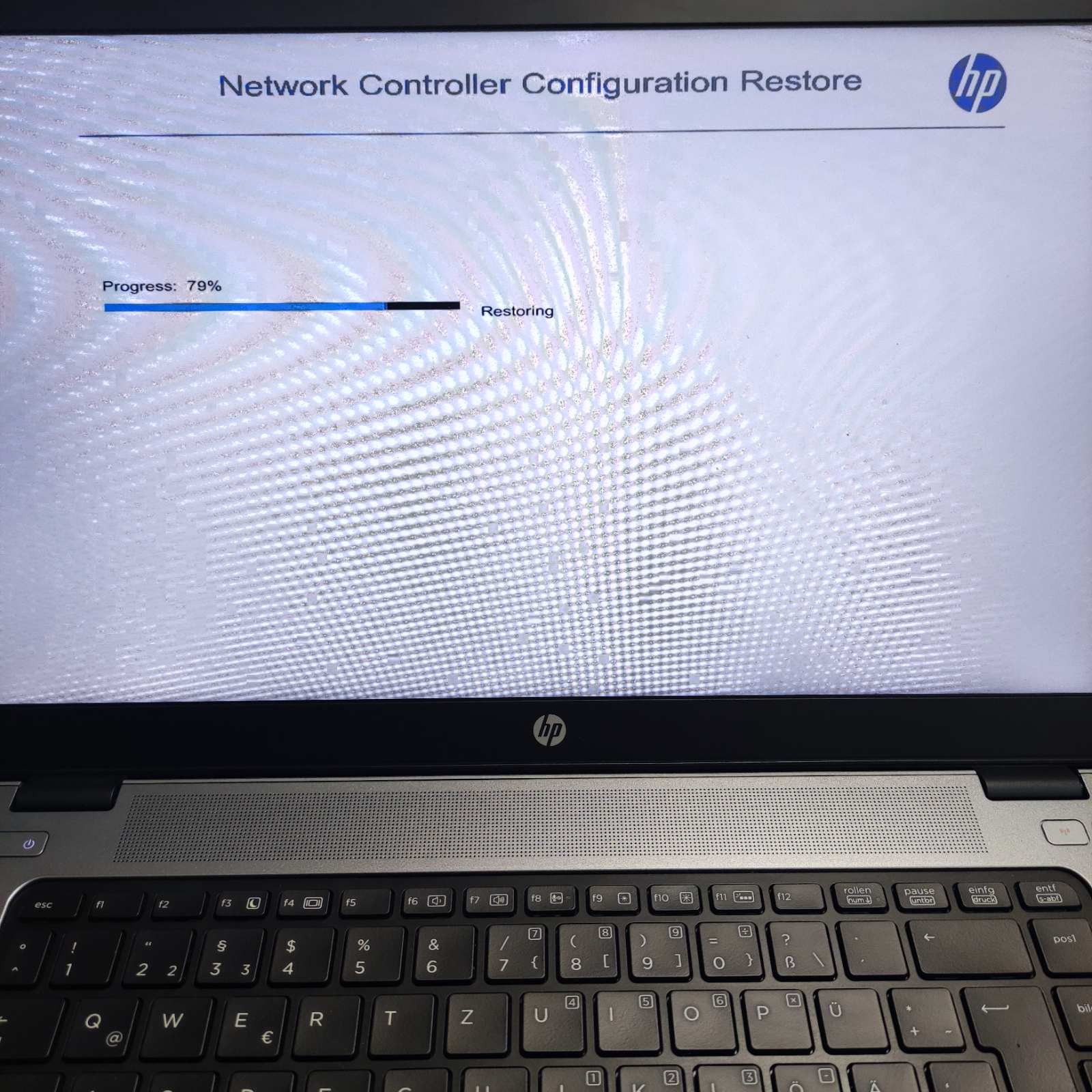

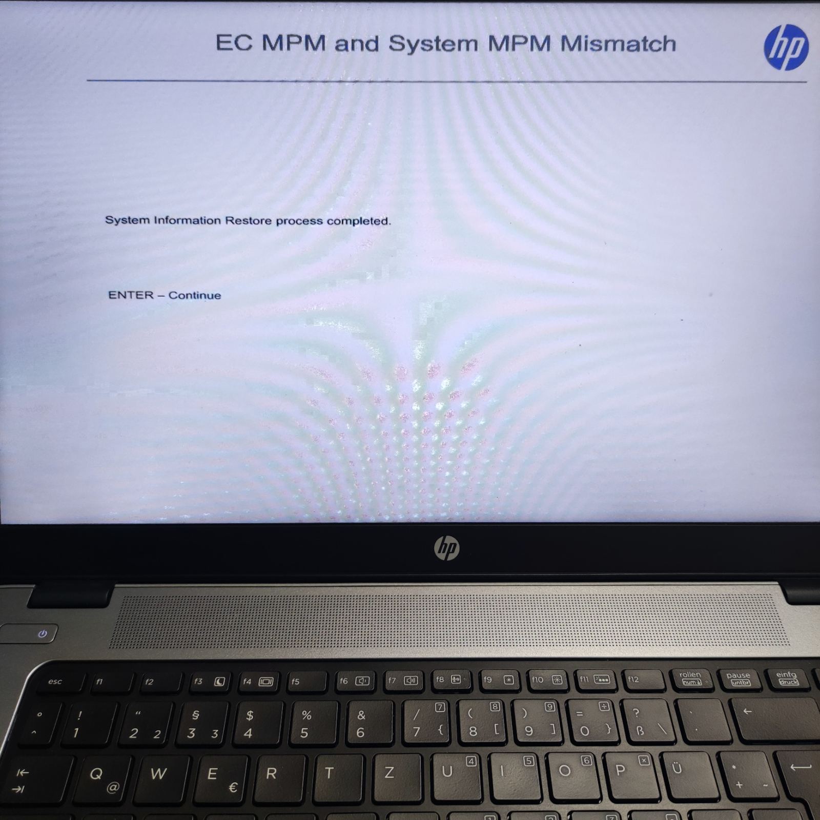

          It automatically did something , first time i see something like that. In restore.
          But we keep missing , serials etc. and Windows key from the embedded chip.
          The good side,is the boot to windows, and that the options are not grey anymore.

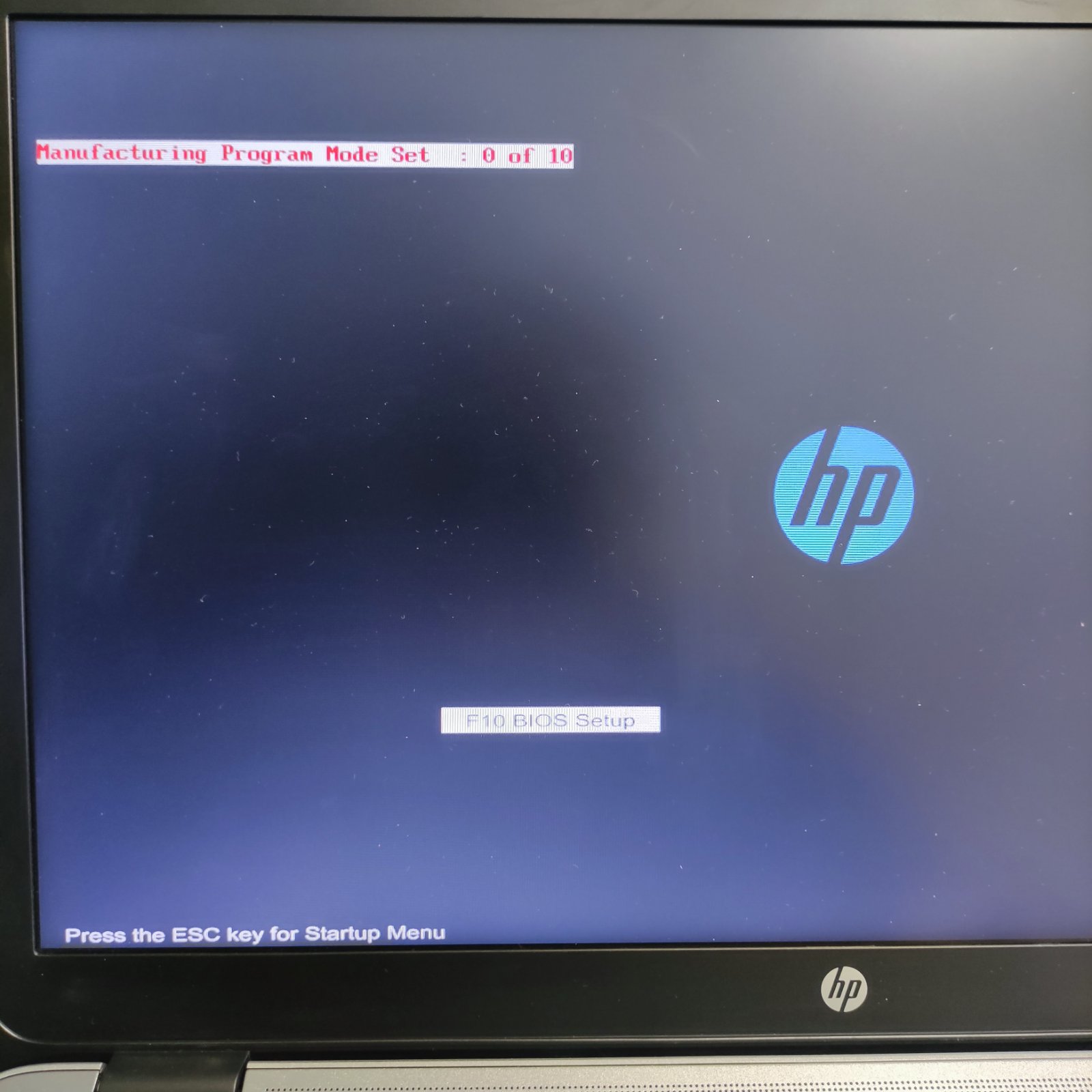

                Originally posted by AccountSaver
                Didn't try it. Because i already had results with the file of @peste.
                try the file @imranromi if it is Ok, you will not have to enter the DMI information, if it does not work, write again the bios sent by me and enter the DMI information ... here is the video ..
