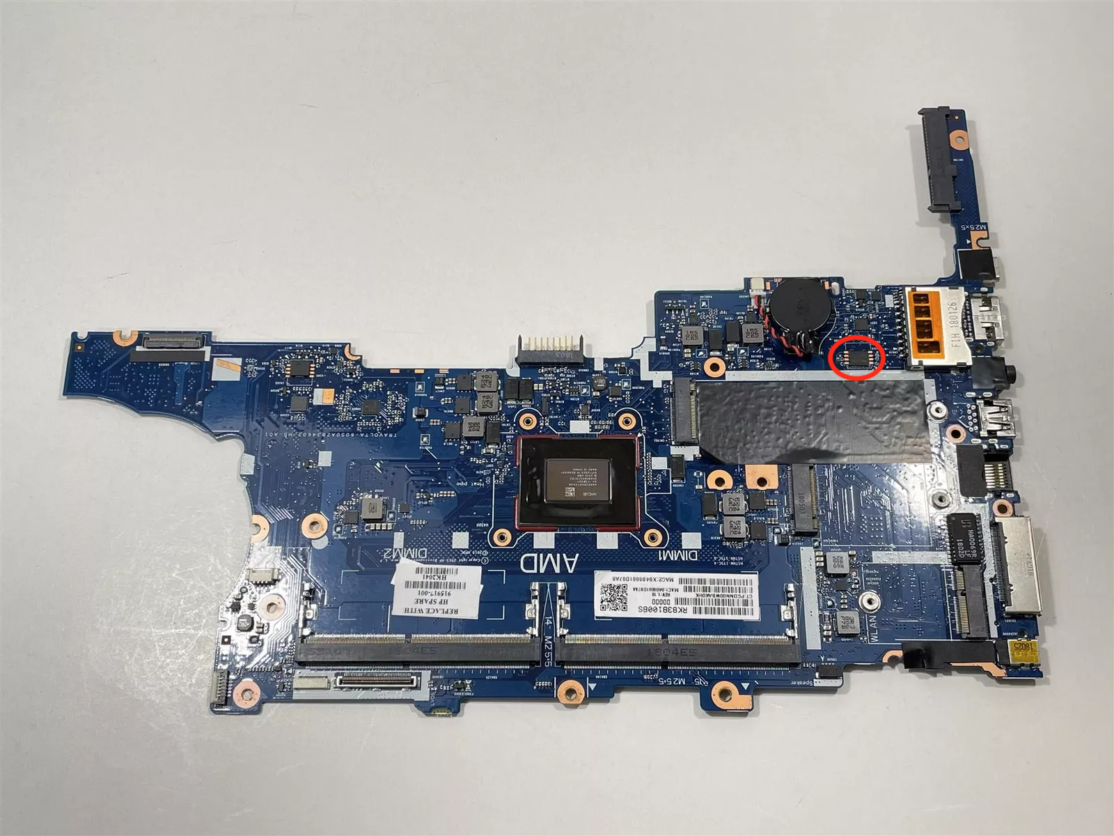

    Hi everyone, I have a HP EliteBook 755 G4 with a Biuos password.
    I've read the 16MB chip and patched using ​RCUnlocker_v_1_0 but seems it didnt worked, password is still there.
    Can you please help to remove the password?
    after first boot, there was an message thet firmware is restored, dont know if was suppose to happen.
    HP EliteBook 755 G4
    ProdID: W5Q98AV
    SN: 5CG7524BY4

    Read U366 (64Mb) and use RCUnlocker

      Thanks, I've read the 8MB chip used the RCUnlocker but gives the following message "Missing unshockable Content"
      Attached both chips content

        read it again and compare results. It has errors. "unshockable" or unlockable?
          will try again
          is says unlockable
          • moshu
            • Oct 2024
            • 66
            • Ireand
            in the end the 16MB chip had the password. Tried again to read, patch and write back and it worked.
            It seems there were some issues with the t48 programmer and this motherboard but managed to do this with ch341 in the end.
