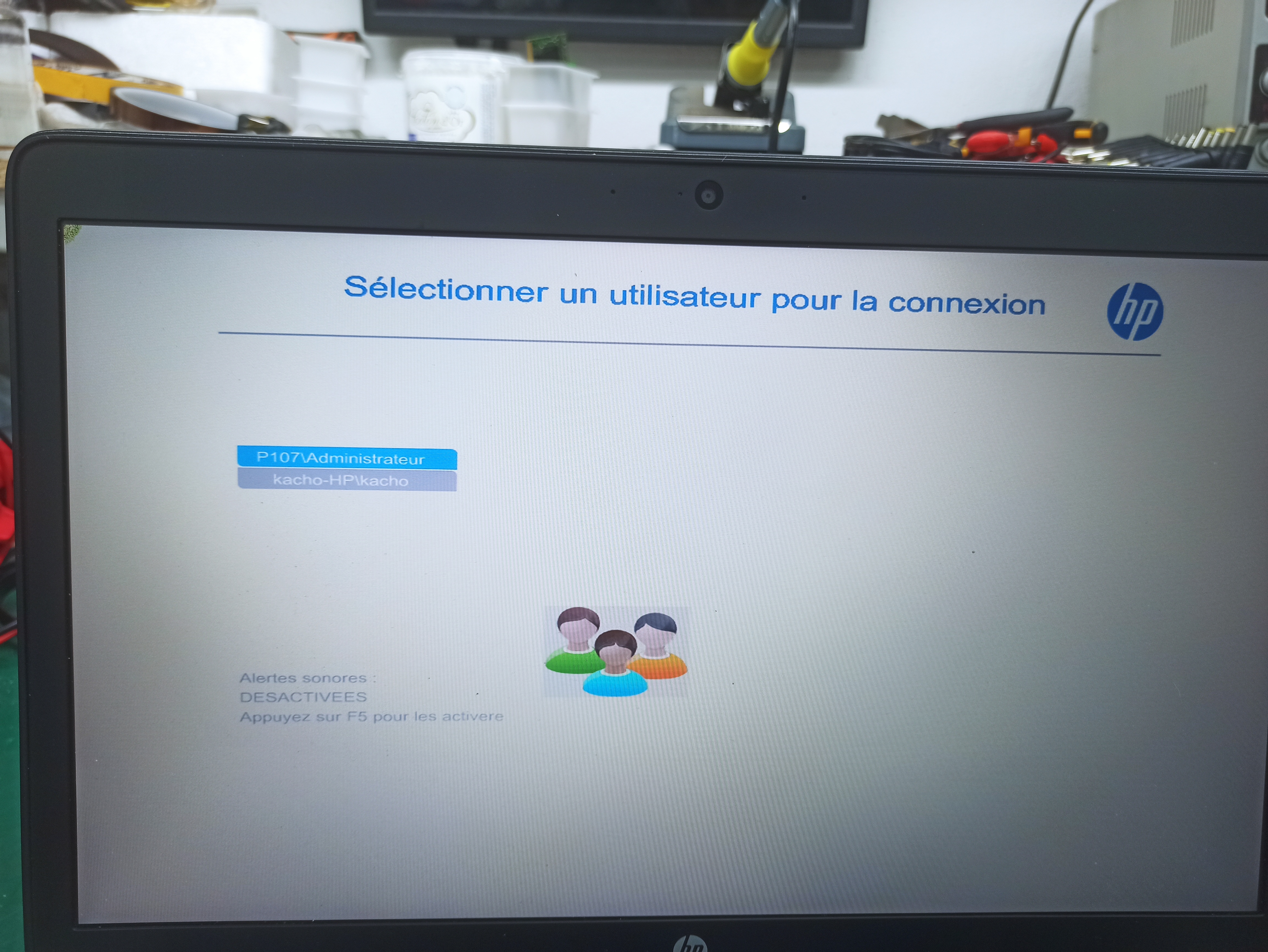

                      #50
                      Originally posted by hoaca388
                      Take a screenshot so I can see it.
                      VOILA
                      • hoaca388
                        Badcaps
                        • Jan 2022
                        • 11402
                        • Viet Nam
                        #51
                        Originally posted by mehdiab17
                        VOILA
                        Try
                        • mehdiab17
                          • Oct 2017
                          • 56
                          • algerie
                          #52
                          Try
                          thanyou freind bios is unlocked
