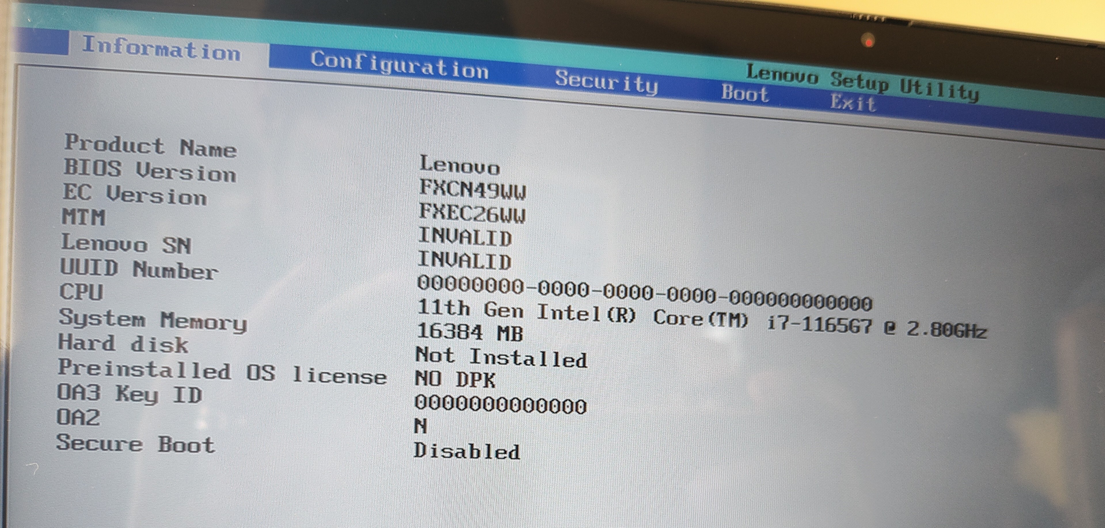

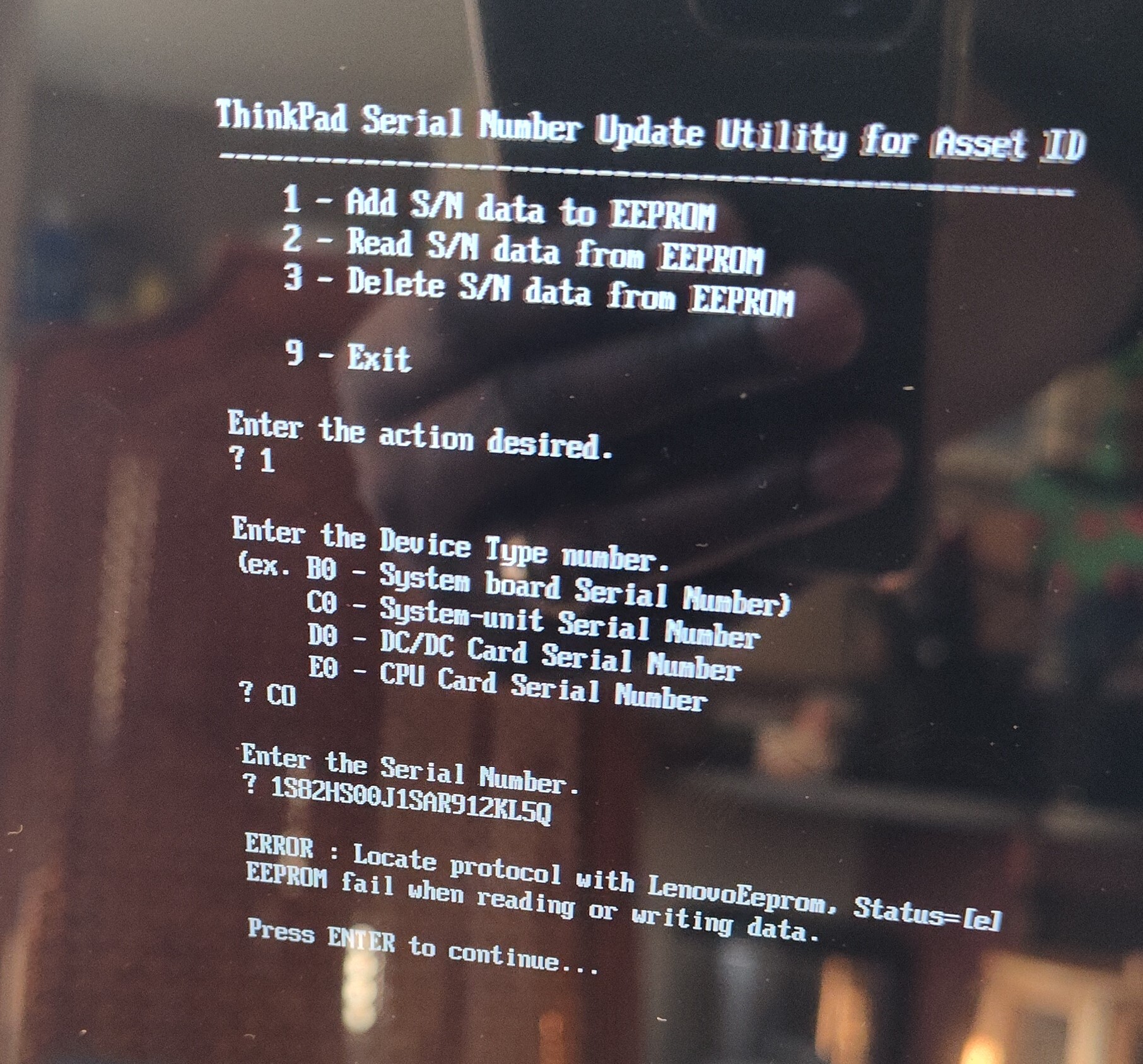

lenovo Flex 5 bios need
  • peste
    replied
    Originally posted by Lukosiukas View Post
    Hello, i need bios rebuild or dmi and widnows key trasfered. Turns on, black screen, no post. Tried dump with no dmi (from #3 post) computer turns on, works perfectly.
    IDEAPAD FLEX 5 14ARE05
    SN R9121R2B
    MTM 81X2009JLT
    BOARD LC55-14A 19793-3
    now you have everything you need at post #3...transfer DMI AND KEYWIN yourself...
    the bios from post # is virgin, use the HxD program (it's free on the internet), enter both bios into the program (your laptop and the virgin one),
    select that interval mentioned in both bios, copy the interval in your bios and pass it to the virgin bios (copy - paste)....and that's it...
    Leave a comment:
  • Lukosiukas
    replied
    Hello, i need bios rebuild or dmi and widnows key trasfered. Turns on, black screen, no post. Tried dump with no dmi (from #3 post) computer turns on, works perfectly.
    IDEAPAD FLEX 5 14ARE05
    SN R9121R2B
    MTM 81X2009JLT
    BOARD LC55-14A 19793-3
    Leave a comment:
  • redoxy
    replied
    Originally posted by qayyum786 View Post
    flash old bios and check dose it turn on
    I received the new BIOS chip and flashed the old BIOS. It still does not turn on.
    Leave a comment:
  • redoxy
    replied
    Originally posted by qayyum786 View Post
    flash old bios and check dose it turn on
    I ordered new BIOS chips. I'll try and report back once I receive it.
    Thanks.
    Leave a comment:
  • qayyum786
    replied
    Originally posted by redoxy View Post
    Thanks, qayyum786. I made a rookie mistake in my haste to flash the BIOS. I forgot the battery was still when I was placing heat tapes on resistors and capacitors around the BIOS chip to prepare for desoldering the BIOS chip. I ended up shorting the BIOS chip (it burned). I replaced it with the same part number from a donor board and flashed your bin file but now there's no power. The laptop doesn't turn on anymore. I tried with battery only, power adapter only, and battery with power adapter with the same results, no power. I guess I might have damaged other components besides the BIOS chip
    This is the end of this repair for me.
    Thanks, everyone for all the help.
    Cheers!
    flash old bios and check dose it turn on
    Leave a comment:
  • redoxy
    replied
    Originally posted by qayyum786 View Post
    try
    Thanks, qayyum786. I made a rookie mistake in my haste to flash the BIOS. I forgot the battery was still when I was placing heat tapes on resistors and capacitors around the BIOS chip to prepare for desoldering the BIOS chip. I ended up shorting the BIOS chip (it burned). I replaced it with the same part number from a donor board and flashed your bin file but now there's no power. The laptop doesn't turn on anymore. I tried with battery only, power adapter only, and battery with power adapter with the same results, no power. I guess I might have damaged other components besides the BIOS chip
    This is the end of this repair for me.
    Thanks, everyone for all the help.
    Cheers!
    Leave a comment:
  • qayyum786
    replied
    try
    Leave a comment:
  • redoxy
    replied
    Thanks, Hoaca388 and Shiyab for the files.
    I tried Hoaca388's file and it worked. I have display.
    However, I lost DMI info (S/N, Model #, UUID and Windows Key) as shown in the picture.
    I tried using the Lenovo Uone tool to write the DMI info but I get an error "Locate protocol with LenovoEeprom, status [e]"
    "Eeprom fail when reading or writing data."
    Is there a way to fix the DMI tool error? I'd like to try that first if possible since I'd prefer not to desolder the BIOS chip again.
    shiyab does your file retain the DMI information so I should go ahead and try that if I'm unable to write the DMI info with the tool?
    Thanks, again for the help.
    Cheers!
    Leave a comment:
  • shiyab
    replied
    Originally posted by redoxy View Post
    Hi everyone!!
    Could you please help me fix my BIOS?
    Lenovo IdeaPad Flex 5-14ITL05
    S/N: R912KL5Q
    Motherboard: LC65-14T 203013 448.0K121,0011
    Issue: Laptop powers on but no display. It appears the LCD backlight turns on but no image.
    Thanks, in advance.
    hi try
    Leave a comment:
  • hoaca388
    replied
    Originally posted by redoxy View Post
    Hi everyone!!
    Could you please help me fix my BIOS?
    Lenovo IdeaPad Flex 5-14ITL05
    S/N: R912KL5Q
    Motherboard: LC65-14T 203013 448.0K121,0011
    Issue: Laptop powers on but no display. It appears the LCD backlight turns on but no image.
    Thanks, in advance.
    Flex 5-14ITL05 Laptop (ideapad) - Type 82HS
    Leave a comment:
  • redoxy
    replied
    Hi everyone!!
    Could you please help me fix my BIOS?
    Lenovo IdeaPad Flex 5-14ITL05
    S/N: R912KL5Q
    Motherboard: LC65-14T 203013 448.0K121,0011
    Issue: Laptop powers on but no display. It appears the LCD backlight turns on but no image.
    Thanks, in advance.
    Leave a comment:
  • Osmarperez
    replied
    Hi everyone, it`s me again this time with a question: is there a method to upgrade/flash the BIOS of the Lenovo Ideapad Flex 5-14ITL05 Laptop - Type 82HS using a bootable pendrive?
    I`ve search the Internet but I haven“t found a way to do it in Lenovo laptops. Thanks.
    Leave a comment:
  • Osmarperez
    replied
    Originally posted by hoaca388 View Post
    S/N: R912W5LD
    Thank you very much !!
    Leave a comment:
  • hoaca388
    replied
    Originally posted by Osmarperez View Post
    Hi everyone!!
    Could you please help me fixing this BIOS? Thanks in advance
    Lenovo Ideapad Flex 5-14ITL05 Laptop - Type 82HS
    S/N: R912W5LD
    BIOS VERSION: FXCN49WW
    Issue: after a bad upgrade laptop won`t recognize SSD NVMe, other than that everything is ok.
    Thank you very much
    S/N: R912W5LD
    Leave a comment:
  • Osmarperez
    replied
    Hi everyone!!
    Could you please help me fixing this BIOS? Thanks in advance
    Lenovo Ideapad Flex 5-14ITL05 Laptop - Type 82HS
    S/N: R912W5LD
    BIOS VERSION: FXCN49WW
    Issue: after a bad upgrade laptop won`t recognize SSD NVMe, other than that everything is ok.
    Thank you very much
    Leave a comment:
    commented on 's reply
    Post the laptop model number and Type and post the laptop serial number..........
  • shiyab
    replied
    Originally posted by pokyss1 View Post
    BONJOUR
    no display issue
    LC55-14A
    19793-3
    448.0K104.0031
    post snid
    Leave a comment:
  • pokyss1
    replied
    Originally posted by pokyss1 View Post
    BONJOUR
    no display issue
    model number in the bord:
    LC55-14A
    19793-3
    448.0K104.0031
    model number in the bord:
    Leave a comment:
  • pokyss1
    replied
    Originally posted by ub6ib969 View Post
    Re: lenovo Flex 5 bios need
    Hi Peste,
    used the bios in post 3 however same result. Can the DMI information, windows key and serial number be transferred to the new bios if possible. thanks again
    hello you found a solution I have the same problem as you on the same computer and the same motherboard thank you.
    Leave a comment:
    commented on 's reply
    Provide the full machine model number, serial number (or Service tag, SNID) and the board model number (see https://www.badcaps.net/forum/showthread.php?t=88758 ) ,The serial number, make, full model number, motherboard model and revision (except QR codes) must be written/typed at your request as per the rules. Not as a picture, part of the file name and so on.
