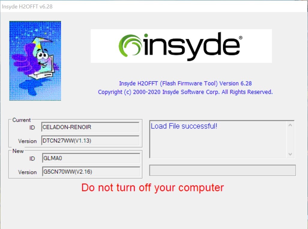

                      Hello. Could you please tell me if it's possible to update the BIOS on a Lenovo IdeaPad 5-14ARE05 (81YM) MP1XG5KX laptop from the current version DTCN27WW (v1.13)? The last update is dated May 30, 2022, and no newer versions have appeared on the official website since then. The platform is LNVNB161216.
                      I would like to understand the following:
                      – Are there any alternative ways to update it (for example, via engineering BIOS versions, unofficial sources, or using a BIOS from a similar model like the 14ALC05)?
                      If I try to flash the BIOS from the 14ALC05, will the laptop be immediately bricked, or is there a chance it will work? The flashing process seems to go through, but I'm a bit nervous.
                      Thank you!
                          Why would you do that? If the last version is DTCN27WW from 2022 stick with it, not always newer=better
                          Thank you!
                          Different CPU type, yours is Renoir (Ryzen 4000 series), 14ALC05 has Lucienne CPU (Ryzen 5000), high chance of a brick; AGESA (the equivalent to CPU microcode on AMD) only supports 1 CPU type on laptops, unlike desktop PCs which support several CPU types on the same socket
                          Even if the motherboard is exactly the same (same board number, but fitted with a different generation of CPU)
                          Don't know what you did to force flash as the updater should have stopped you from doing it, but as long as you didn't restart, flash original BIOS
                            With other laptops, the BIOS doesn't go through - it immediately throws an error. But with ALC, it calmly even offers to install and restart. xD. If this weren't my main laptop, I would've clicked install just out of curiosity.
