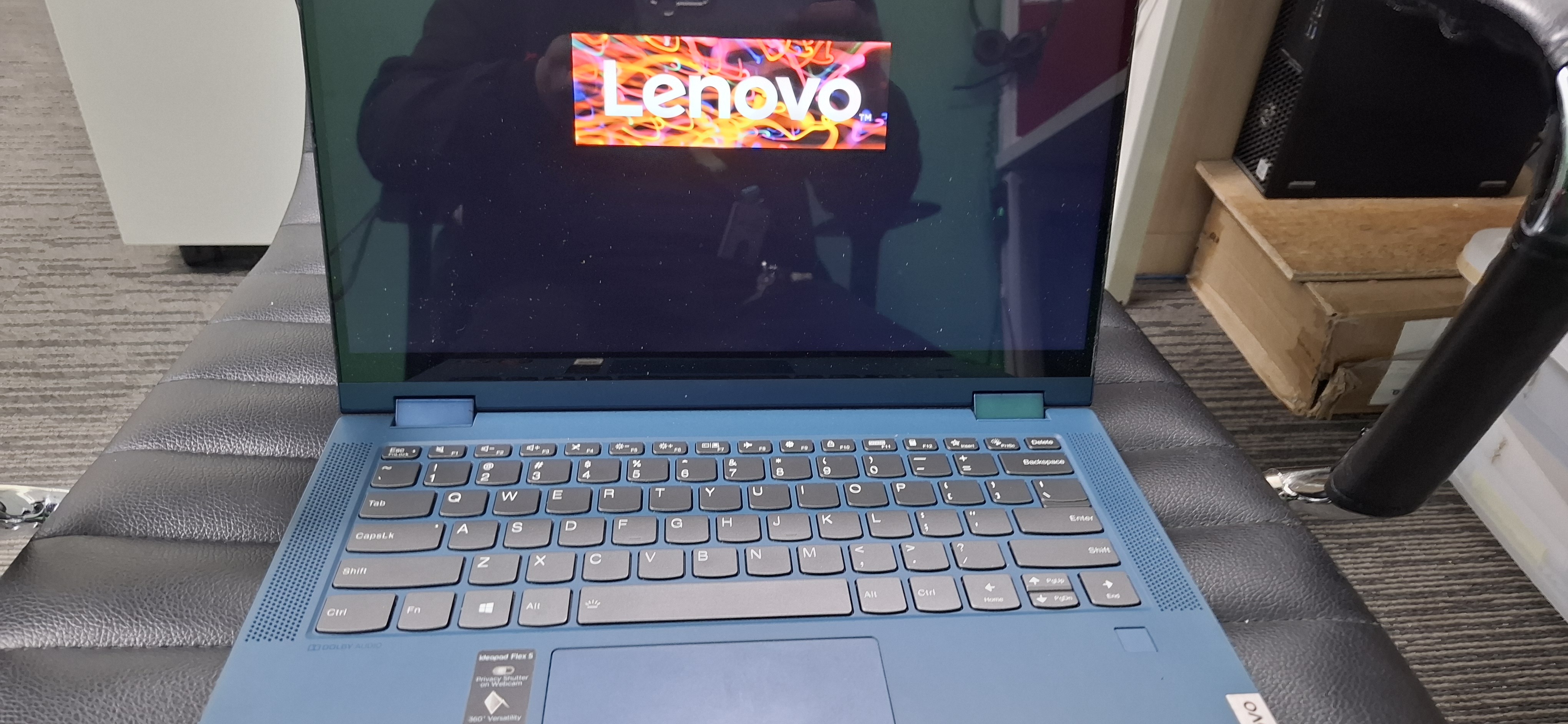

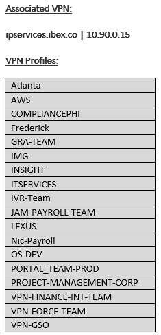

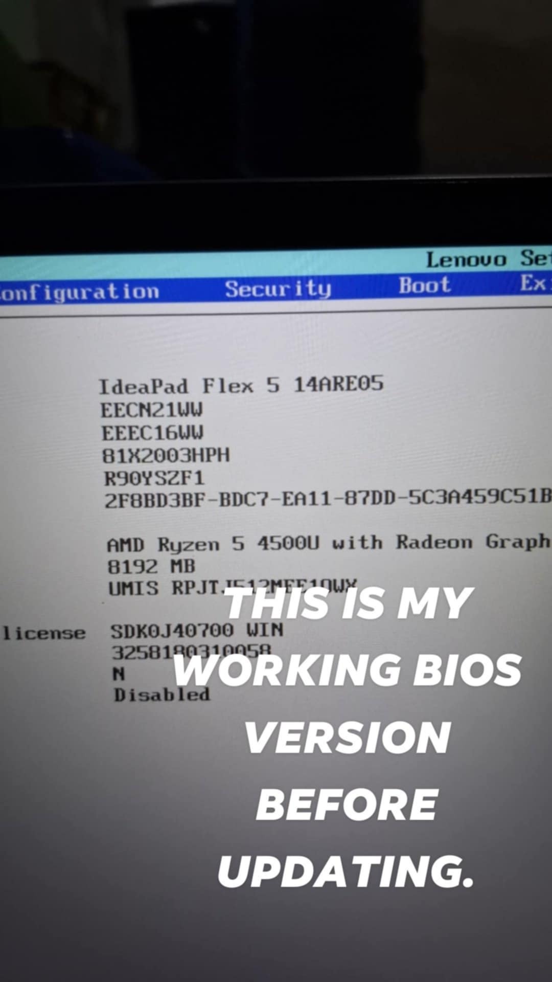

lenovo Flex 5 bios need
Yes, is doing the same , black screen , keyboard lighted , then only caps and esc on (with light ) and it seems is repeating this, keyboard light then only Caps and Esc , so on -
I see , thank you, I was think to do it via reboot FN+R or FN+B. in this case i need to go to specialist ..Leave a comment:
Leave a comment:
I cannot enter to bios , when the laptop starts, the fans starts to work then stop , the keyboard light is on then all the lights are off excepts the Caps and Esc, the Esc can be turn off with win key+ esc . all this time the display is off
ThanksLeave a comment:
Hi, Can some body help me with the bios
Lenovo
5-14IILO5 Laptop (ideapad) - Type 81X1
Serial Number R90Z1N6B
MO R9N0B080600K
MTM 81X1009URM
Thanks in advanceLeave a comment:
You DMI addedLeave a comment:
can you help ? thanksLeave a comment:
Yes, it is very important, the DMI of a machine is to differentiate it from another machine.You just flash it and then add DMI later.Last edited by hoaca388; 04-20-2025, 08:20 AM.Leave a comment:
Leave a comment:
Hello good day brother.
I would like to ask for your assistance. I'm still encountering an issue with my Lenovo Flex 5-14ARE05 Laptop (Ideapad, Type 81X2, Serial: R90YSZF1, MTM: 81X2003HPHI). The problem began after I attempted to update the BIOS by double-clicking the EECN44WW.exe file downloaded from the Lenovo website. I also installed chipset drivers and other system drivers.
After the BIOS update, the laptop rebooted but now only shows a black screen. There is no POST, no display (not even on an external monitor), and the battery indicator does not show charging. The keyboard lights up, but I cannot access BIOS or use the Novo button. The device uses AMD architecture.
I tried flashing a fresh BIOS from Lenovo's official support site and also restored the DMI and Win key. Now, I am able to access the BIOS. However, when set to UEFI, the screen remains black with only backlighting. When switched to Legacy Boot, it gets stuck on the Lenovo logo. Secure Boot is already disabled. The system can detect the SSD and USB devices, and the Novo button works, but it won't boot from any bootable device—not even for OS installation or system recovery. I also attached my working BIOS version It's all working before I update also the current BIOS now with stuck black screen and stuck lenovo logo issue.
Thank you for the help..
Leave a comment:
Hello good day brother.
I would like to ask for your assistance. I'm still encountering an issue with my Lenovo Flex 5-14ARE05 Laptop (Ideapad, Type 81X2, Serial: R90YSZF1, MTM: 81X2003HPHI). The problem began after I attempted to update the BIOS by double-clicking the EECN44WW.exe file downloaded from the Lenovo website. I also installed chipset drivers and other system drivers.
After the BIOS update, the laptop rebooted but now only shows a black screen. There is no POST, no display (not even on an external monitor), and the battery indicator does not show charging. The keyboard lights up, but I cannot access BIOS or use the Novo button. The device uses AMD architecture.
I tried flashing a fresh BIOS from Lenovo's official support site and also restored the DMI and Win key. Now, I am able to access the BIOS. However, when set to UEFI, the screen remains black with only backlighting. When switched to Legacy Boot, it gets stuck on the Lenovo logo. Secure Boot is already disabled. The system can detect the SSD and USB devices, and the Novo button works, but it won't boot from any bootable device—not even for OS installation or system recovery. I also attached my working BIOS version It's all working before I update also the current BIOS now with stuck black screen and stuck lenovo logo issue.
Thank you for the help..
Leave a comment:
hi
please help me with a bios
Flex 5-14ARE05 Laptop (ideapad) - Type 81X2
R912X34C MTM 81X20002US
board id: LC55-14A 19793 1M
thanksLeave a comment:
Hello Sir, Thank you for the effort. I can see the Bios settings now and Novo button is working. Unfortunately it stucks in Lenovo logo when I set to Legacy boot..if EUFI boot only black screen with backlight. Can't detect also any bootable media. I've tried too install an Windows 10 OS. with another driver but the issue still thesame. Please help me with this sir.. Thank you.That is my BIOS IC. Im using Neoprogrammer ch341a programmer with 1.8V converter.it's and AMD Rizen 5. thank you sir.Leave a comment:
Leave a comment:
by claws77my laptop is lenovo flex 5 14ITL05
recently my power supply for this laptop developed a fault.
which caused a short in my usb c port -- verified with a new charger.
rant: so, i went to the repair tech in my country, he asked for a huge repair cost when i decided to get it done someplace else this "great person" nicked my bios chip, asked me to be aware for repair scams lol.
I was stupid and unable to find the flaw at the moment. Another repair tech told me that my bios chip was stolen and an 8mb bios chip is in place of that. he told me that a 32... -
by lucaszmn
Summary of BIOS Whitelist Removal Problem
Problem:
I am attempting to remove the WWAN card whitelist from my Lenovo ThinkPad T560.
Initial Findings:- My current BIOS version is N1KET58W (1.45).
- I have a CH341A programmer and have successfully created two full backups of my BIOS.
- I have the ability to use command-line tools on a Linux machine.
- I attempted to use several automated and manual patching methods on my N1KET58W (1.45) BIOS, including using hex strings. These attempts all failed.
- I concluded that the
Channel: BIOS Requests ONLY!
08-12-2025, 03:01 PM -
by WahazHello,
I found 3 bios chips on the board, which I read with a bios programmer: two XMC model bios chips and a Winbond model bios chip. Each XMC model bios chip has two partitions named XM25QH128A [3.3V] and XT25F128A [3.3V]. And the Winbond model bios chip has three partitions named W25Q80BL 3.3V, W25Q80xV 3.3V and W25Q80DV 3.3V....-
Channel: BIOS Requests ONLY!
by grimacelordHello there.
I am working on a Lenovo Legion T5-26AMR5 desktop that currently has a corrupt BIOS and I have been unsuccessful thus far in trying to fix it myself.
History:
1. This computer came to me initially with an error message that said "BiInitializeLibrary failed 0xc0000001" or "0135 fan error". It would always be one of the two errors. It should be noted that when it produced the fan error, there was no physical problem with the fans. They were all spinning just fine.
I searched for this error online and discovered...-
Channel: BIOS & Schematic Requests!
by SMDFleaThese models use the same bios: Lenovo IdeaPad C340-15IML/FLEX-15IML/S340-15IML/S340-15IML Touch/S340-14IML Lenovo XiaoXin-15IML 2019/XiaoXin-14IML 2019
Backup bios used for this tutorial https://www.badcaps.net/forum/showthread.php?t=97978 Post #13
Extract & Edit.
Download the lenovo update from - https://download.lenovo.com/consumer...s/crcn17ww.exe
Extract the first exe using innoextract - https://constexpr.org/innoextract/#download
Extract the second exe using 7-zip or winrar - https://www.7-zip.org/download.html
Channel: BIOS Requests ONLY!
- Loading...
- No more items.
Leave a comment:
