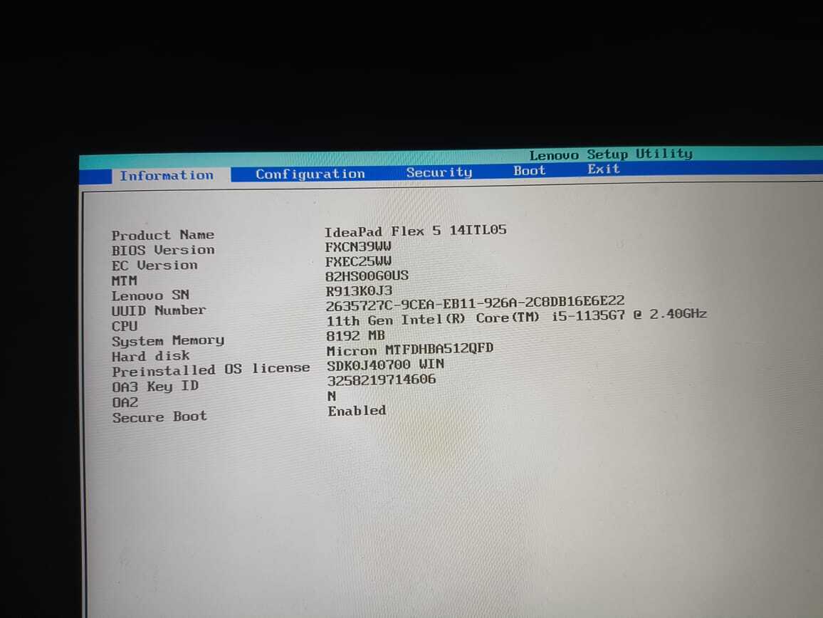

    the laptop works, charges, atleast i cannot detect the flaws. but once i shut down it does not powerup like it should . it takes a long time to show lenovo logo. sometimes keyboard flashes several times.

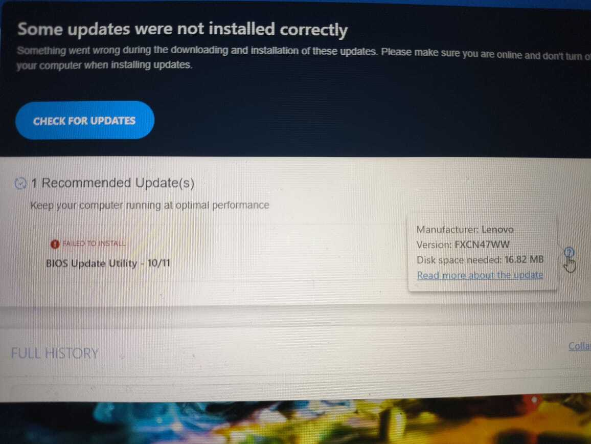

    using lenovo vantage i thought of updating the bios as he (2nd guy) told he had to flash bios he had difficulty finding it.
    the lenovo vantage cannot update the outdated bios. stating that 16 mb space required
  • claws77
    • Apr 2024
    • 103
    • India
    help me make sense of this error
    I am sure the bios chip has the right size 256 mb and the same part number W25R256JVEIQ as in the schematic. i have checked personally.
    why does it say 16 mb disk space needed.

        when i use this .exe file i do not get any log or error. PC just restarts later checking reveals no updation has taken place.
        when i use the lenovo vantage app to update my bios this error is visible after restart
