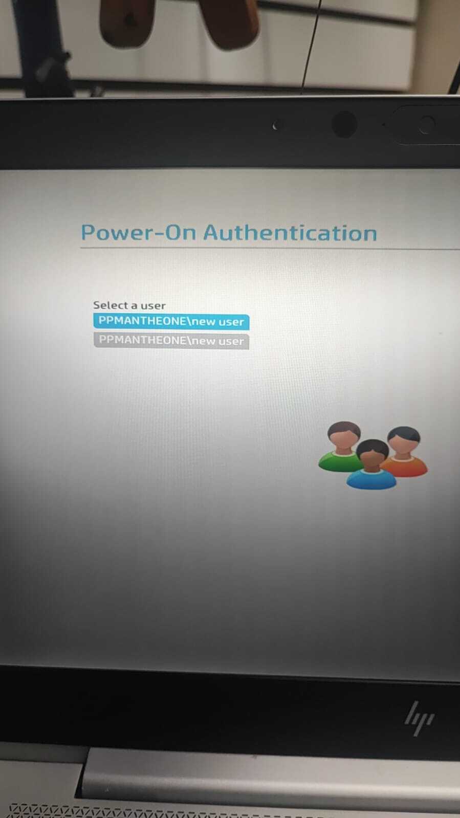

    Originally posted by nuevomorfeo
    I understood that I had to put my W25Q128JV through the RC Unlocker program, I learned how to do it with a video that another user uploaded in the forum but I get that error message that appears in the image
    Can someone help me please??
    Unlocked

      Originally posted by hoaca388
      Unlocked
      Thank you very much, I will do the tests and let you know how it goes, any idea why it didn't work for me? I would like to learn the procedure to not bother with this type of requests
      • nuevomorfeo
        • Oct 2017
        • 6
        • Chile
        #263
        Unlocked
        It didn't work, the same users are still there

          #264
          Try and give feddback
          First boot load bios factory defaults, save and exit and then at the next boot disable security options
          You must fill your DMI manually.​

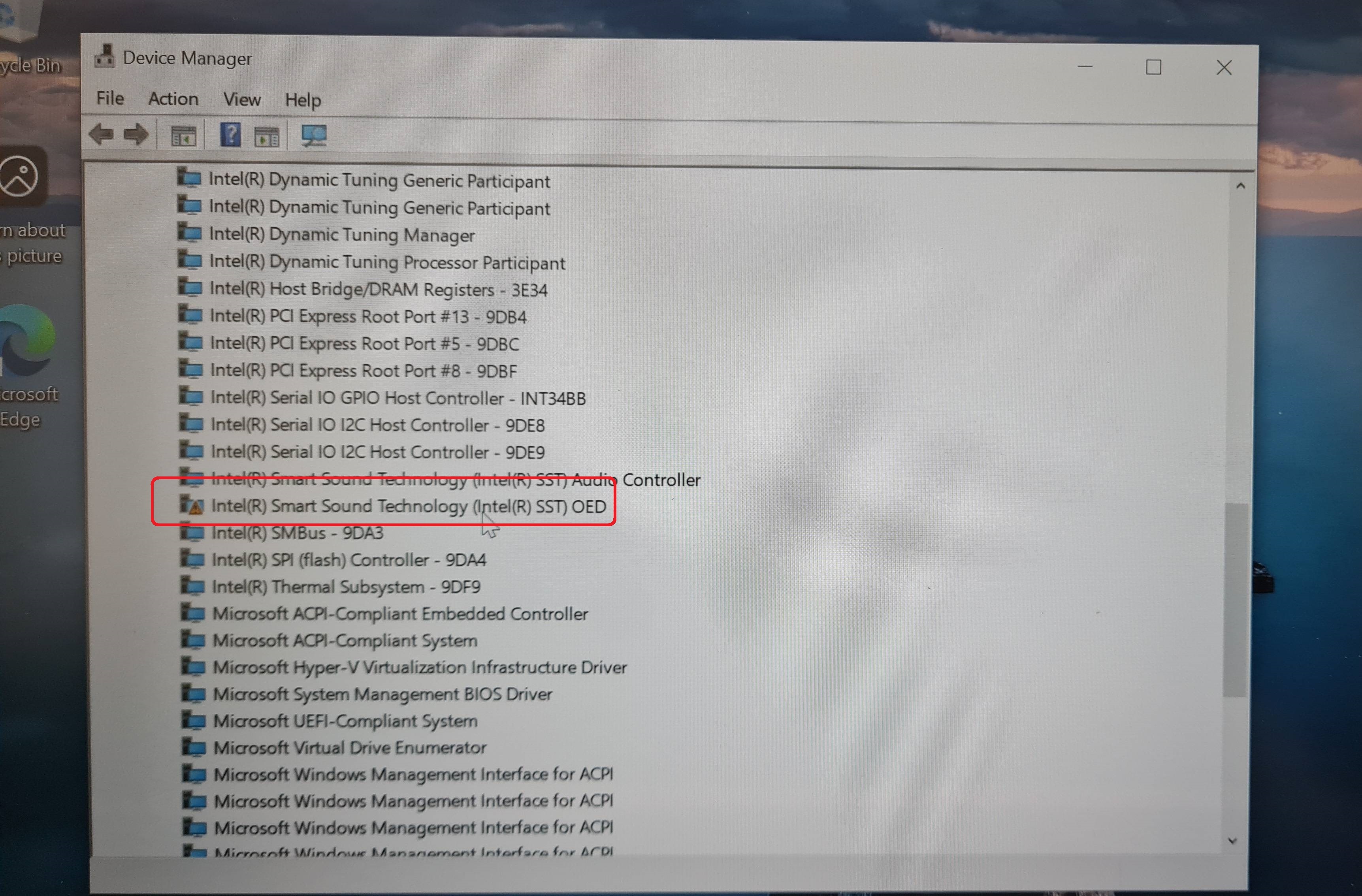

                                    #277
                                    Try older version.
                                    this Bios error "sound OED"

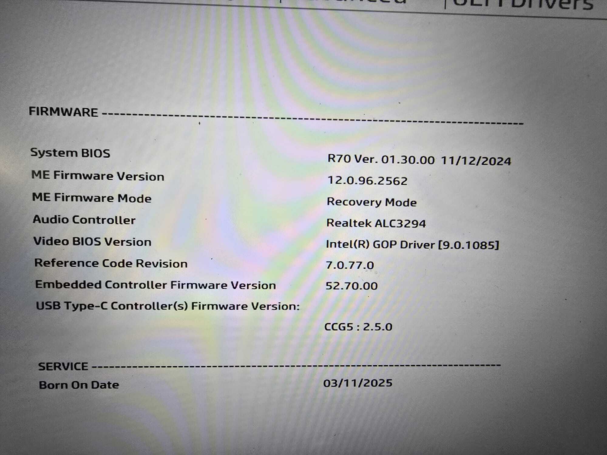

                                    hello, i have a elitebook 830 g6 with no sound working (in windows os) after a bios update from windows update. i also noticed that in bios it shows:
                                    Me Firmware Mode: Recovery Mode (attach picture)
                                    i tried:
                                    driver update/reinstall
                                    windows 10 clean install + driver
                                    windows 11 clean install + driver
                                    cmos reset
                                    reset with power+mute button
                                    bios upgrade/downgrade
                                    bios recovery from usb and key shortcut on boot
                                    but still no audio...
                                    so i tried to dump bios for flash a clean me fw, but in FIT.exe tool (tried various versions) i gave some error opening the dump:
                                    Error 9: failed to decompose image
                                    Error 42: failed to open with processed commands
                                    Unable to open file c:\users..... Reverting to default configuration.
                                    i attach the 32mb dump
                                    notebook info:
                                    HP ELITEBOOK 830 G6
                                    4WE10AV
                                    S/N: 5CG015D4V8
                                    can anyone help?
                                    thank you​
                                        i tried:
                                        cmos reset
                                        notebook info:
                                        HP ELITEBOOK 830 G6
                                        4WE10AV
                                        S/N: 5CG015D4V8
                                        can anyone help?
                                        thank you
