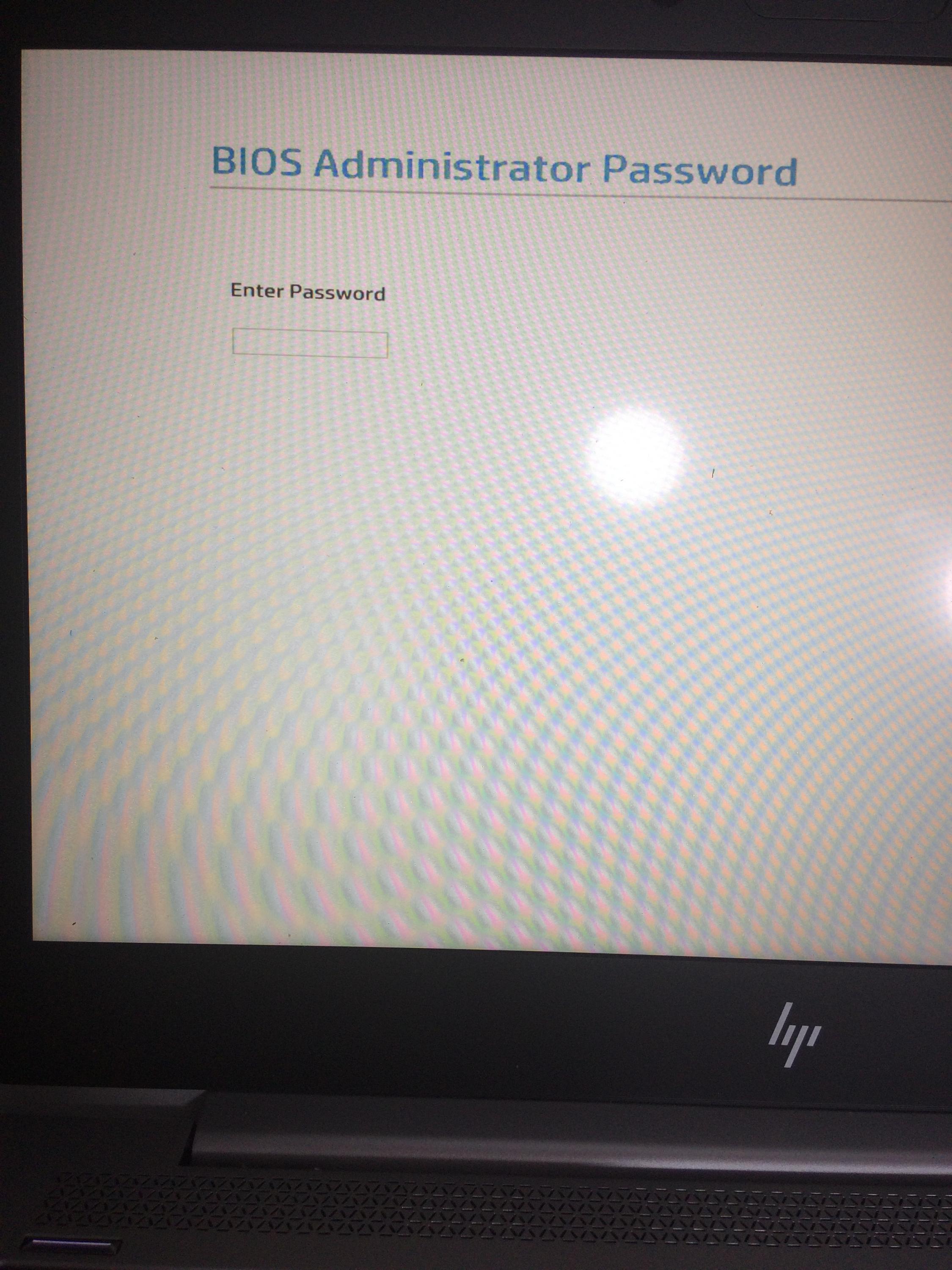

    I have a problem unlocking the bios of an Elitebook 830 G6, i used the HPUNLOCKER tool, but the bin remains locked after writing it back.
    Can anyone clear it for me? or if there is new tips for the 8th gen, it would be appreciated
    Thanks in Advance.

    Just tested. Unlock tool worked fine on it.
    Send the unlocked file, I will check if it is the same.

      Re: HP Elitebook 830 G6 BIOS Failed to unlock
      Here you Go
      PS : I forgot to remove the CMOS battery during the process, could it be the reason why it is still locked?
            Same issue! it is still locked
              So try this repaired file and report if it remove the password.
              Before write new bios, post a screenshot with required password asked by notebook.
                The laptop still locked, but this time I got a bios update message, after that it finished, a message displayed "The bios data was recovered....from the controller something....! i do not really remember what was written exactly, if this is needed, i will program the bios again.
                  So if still ask for a password, you need to program a SIO chip with attached file. The password was stored on mec chip.
                  Backup you mec first and write new file.
