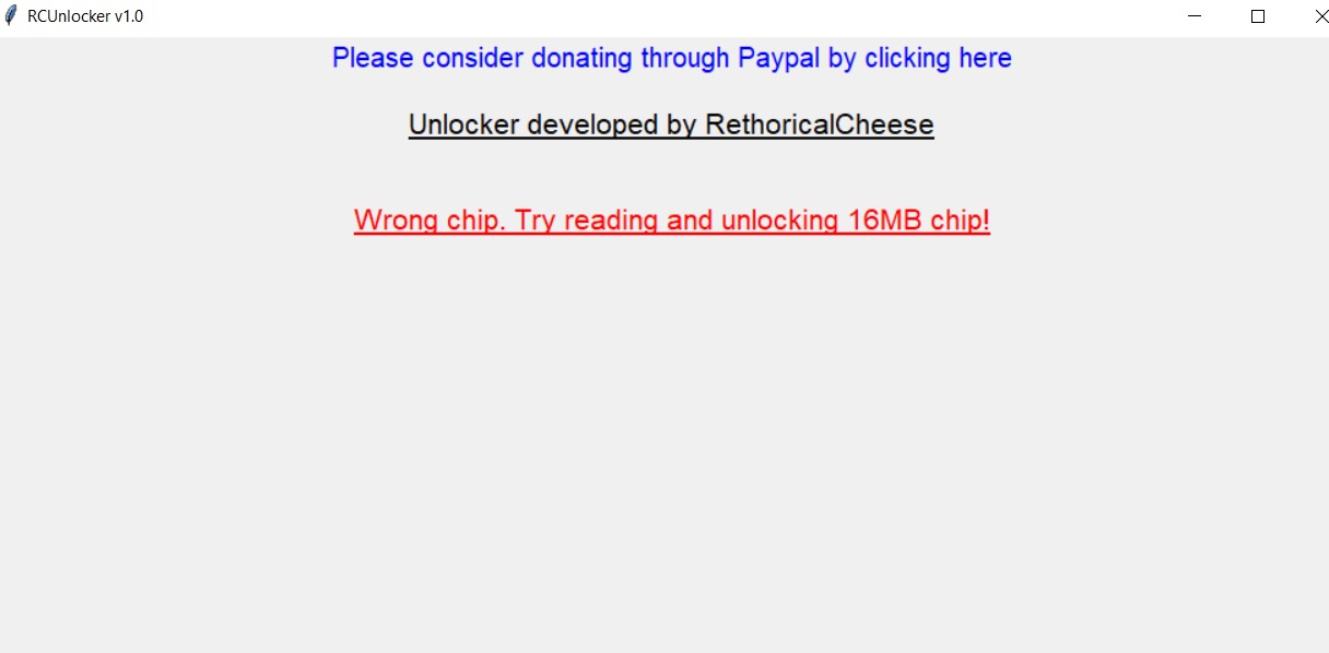

                                #155
                                plz remove password hp x360 830 g6

                                  • houcine4500
                                    • Jun 2015
                                    • 62
                                    • morocco
                                    #157
                                    Re: plz remove password hp x360 830 g6
                                    yes but not working
                                    RCUnlocker give this error in picture
                                    HPUnlocker work but the password not removed

                                      #158
                                      Originally posted by houcine4500
                                      yes but not working
                                      Do you speak English? Look at the picture again, it is quite clearly stated:
                                      "Wrong chip. Try reading and unlocking 16MB chip! "
                                      Which of the written is not clear?

                                        #159
                                        Re: Need unlock HP elitebook 830 G6
                                        thx, i reading the chip 16 Mb with laptool beeprog+ then i save it, i drag it to RCUnlocker but give this error *wrong chip try reading and unlocking 16 mb chip*
                                        • Vesko356
                                          VIP Moderator
                                          • Aug 2018
                                          • 4386
                                          • Bulgaria 🇧🇬
                                          #160
                                          Because your file is bigger than it should be hence the error. Extra 300h at the end musт be trimmed (Block(h): 1000000-10002FF)
