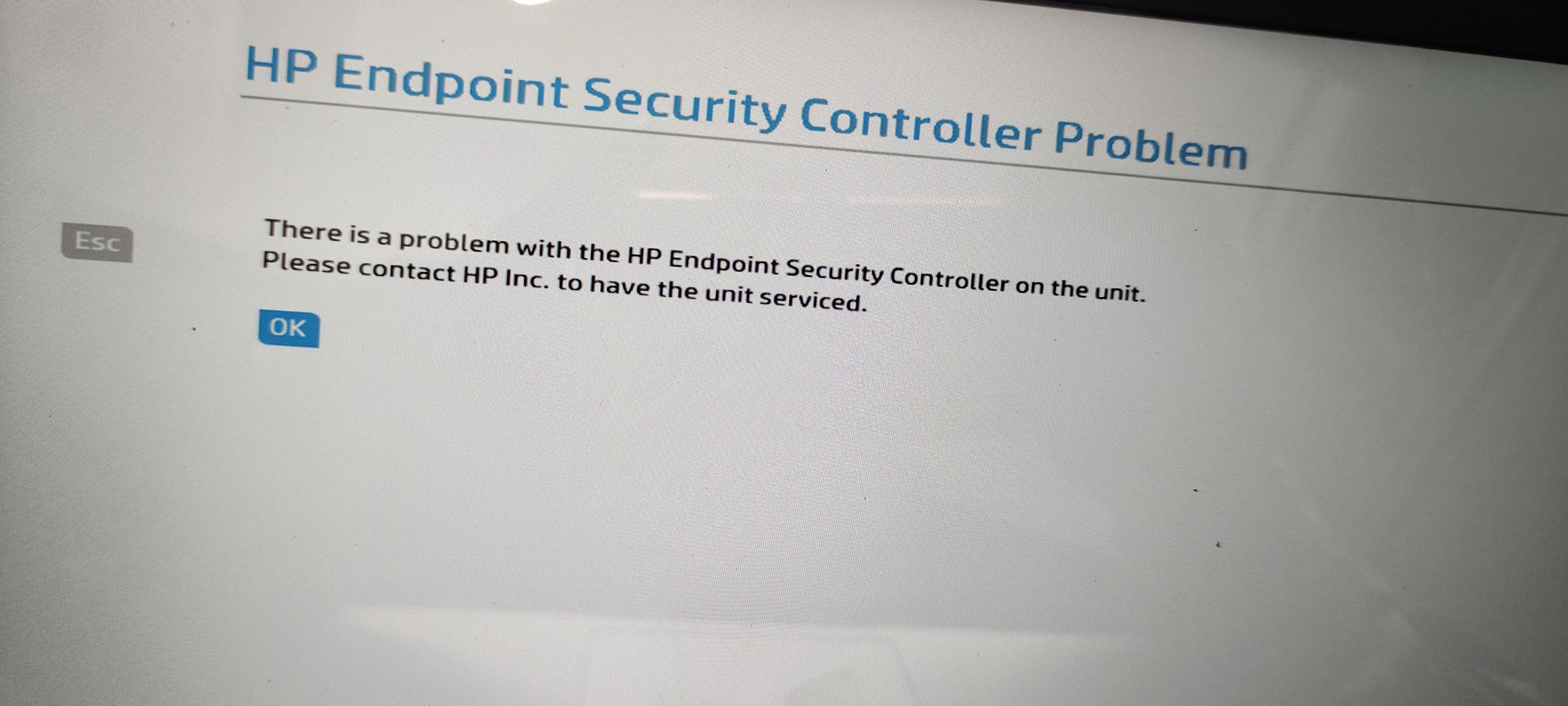

                        #171
                        Re: HP Elitebook 830 G6 bios password
                        Originally posted by peste
                        try...
                        This bios is ok but this error how to solve

                          #172
                          Re: Need unlock HP elitebook 830 G6
                          use RCUnlocker on the 16MB bios
                          I used this tool but still password

                            #173
                            Hello, you must upload your bin so that someone can repair it for you.

                              #174
                              Hi how to repair plz guide me
                              Bios region repair ?
                              Me region repair ?

                                #175
                                This motherboard 2 bios which file send 16mb 32mb?

                                  #176
                                  i solved it thank you
