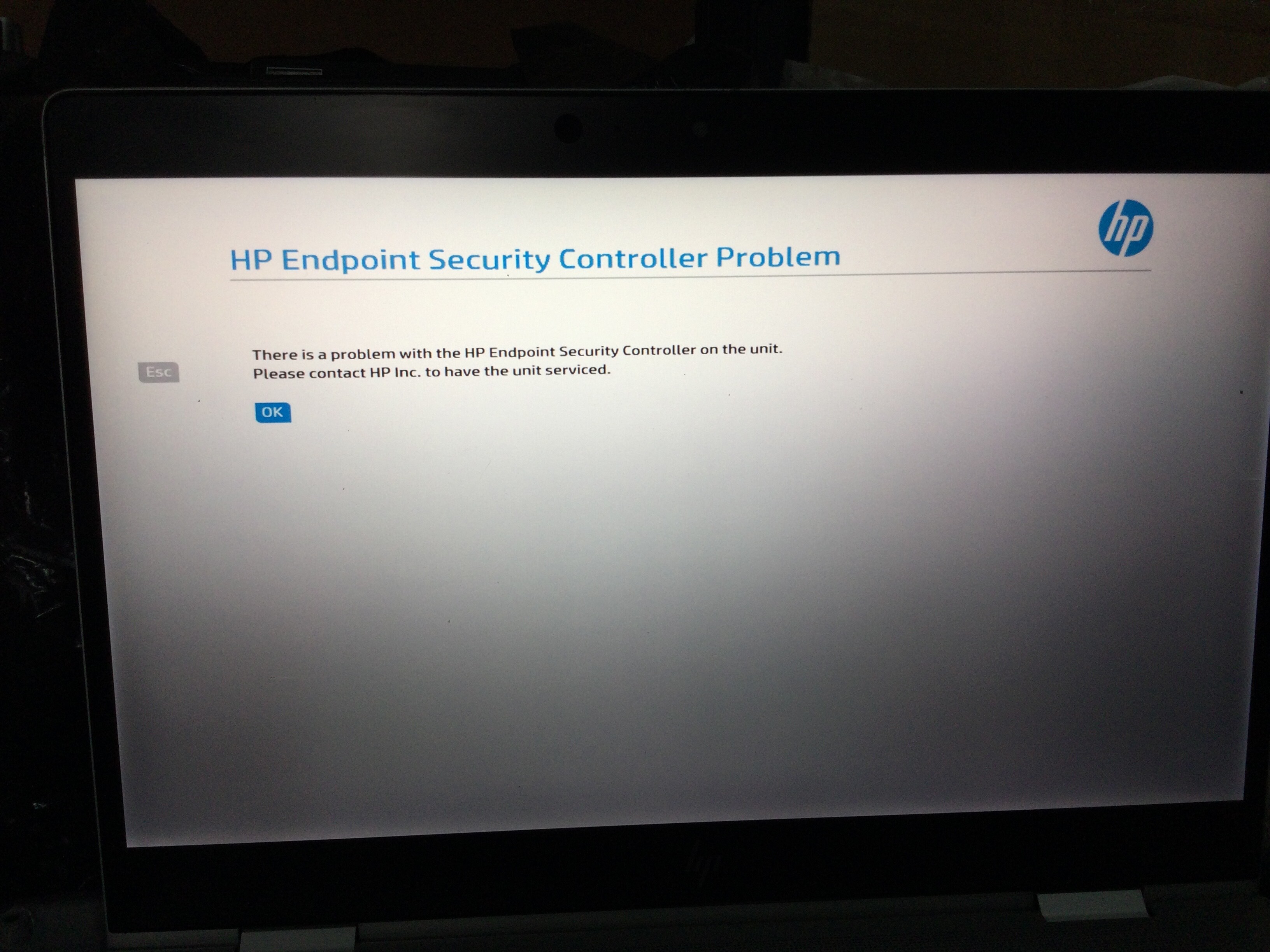

                                bios was removed by using 16mb BIOS, but it showing End point security error while starting , can anyone patch my 32MB bios which i was share at first please

                                  #239
                                  flash your Original untouched EC and this main.
                                  first boot press f10 apply factory defaults and restart, 2nd boot reset security settings to defaults and exit.
                                  use BCU
                                  here's your DMI:
                                  Serial Number: 5CG015105F
                                  Product #/SKU: 7KJ86UT#ABA
                                  CT Number: PJKJK00WBDL0A7
                                  Description: HP EliteBook 830 G6
                                  BuildID: 19WWCFBT601#SABA#DABA
                                  Feature Byte: 3X476J6S6b7B7H7M7Q7W7m7saBapaqauawb8bUbhcAdUdpdqfPhKhWhkjhk8.E7
                                  • viji90
                                    • Jul 2017
                                    • 22
                                    • india
                                    #240
                                    thanks its working now
