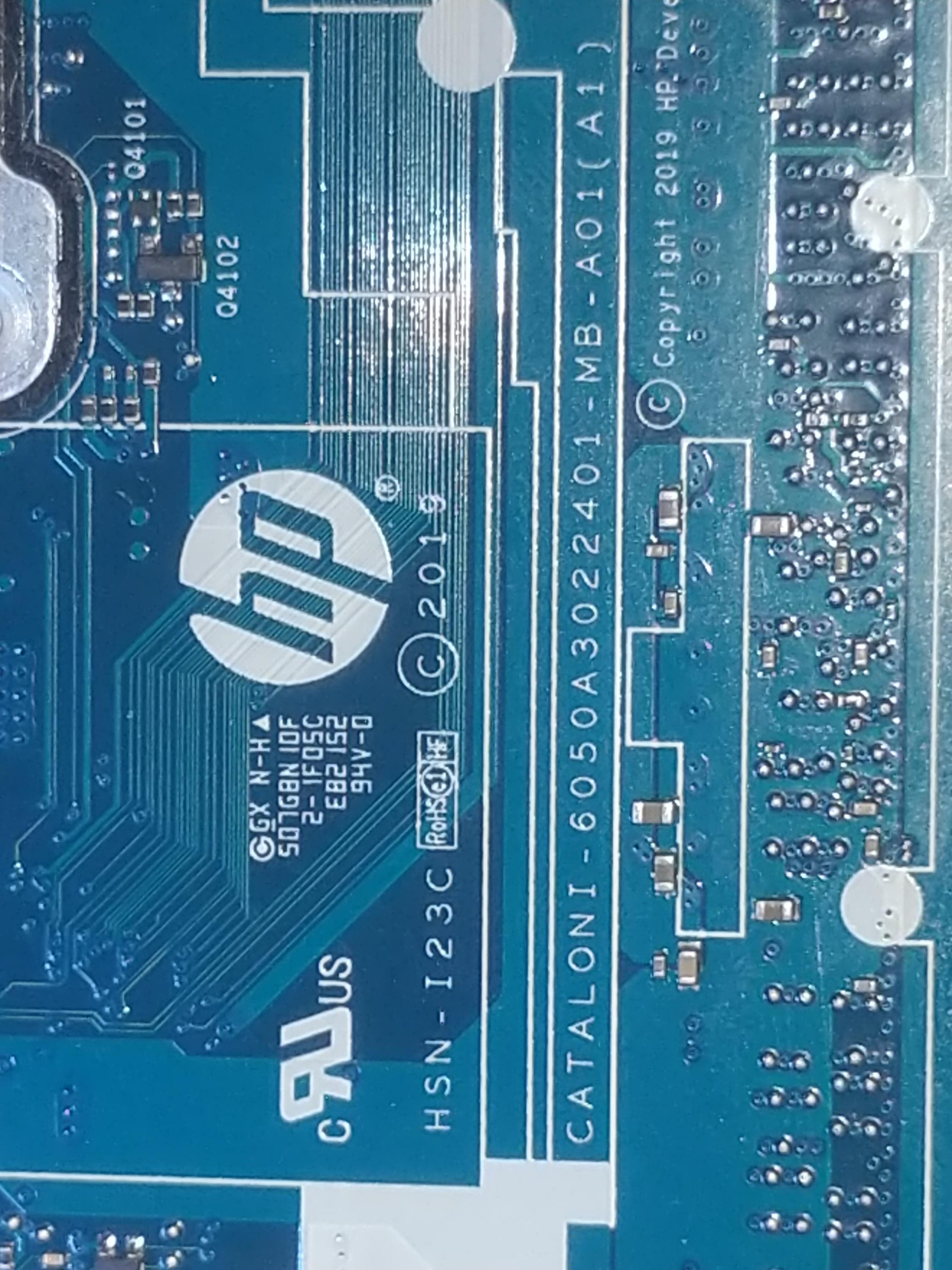

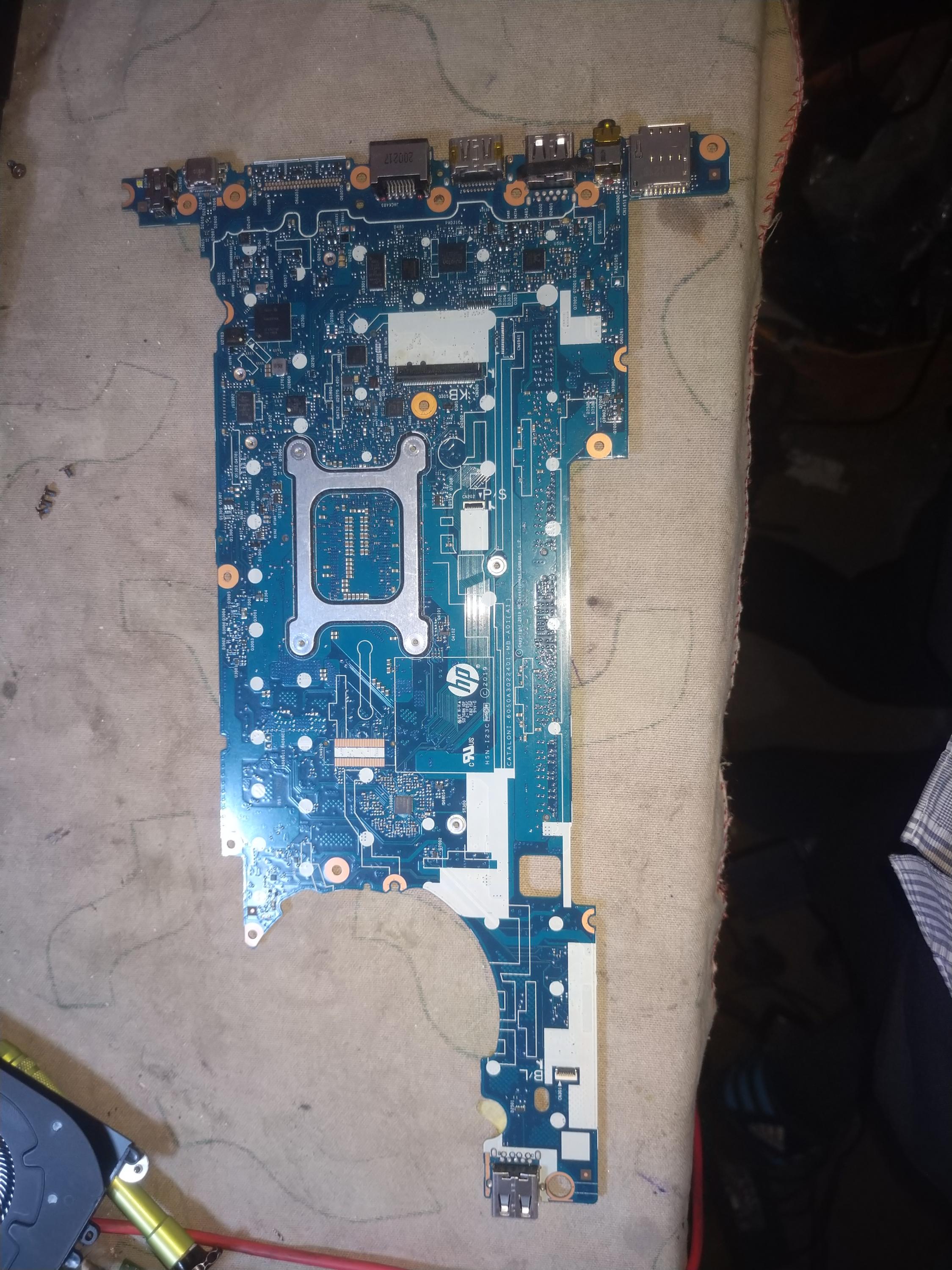

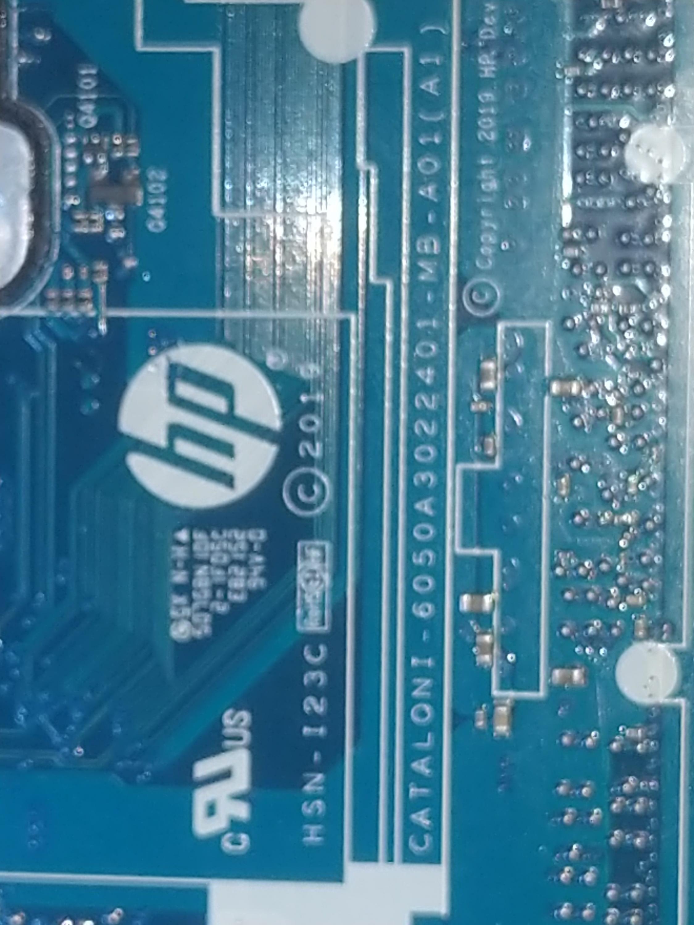

      hp Elitebook 830 g6 cataloni 6050A3022401-mb-A01-(A1)
      please i need hp elitebook 830 G6 bios bin file with S/N 5CG014D3BB.
      i mistakenly did not save the one i extracted.
      i have attached images of the motherboard
