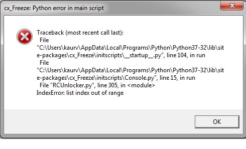

      • coumcoum
        • Dec 2015
        • 36
        • algerie
        #123
        Re: Need unlock HP elitebook 830 G6
        Originally posted by peste
        use RCUnlocker on the 16MB bios and unlock it yourself
        hi not work its give me error !!
        • peste
          • Dec 2016
          • 13335
          • ROMANIA
          #124
          get over the error, write the chip like this, and try...don't forget to have a copy of the original bios..
          • coumcoum
            • Dec 2015
            • 36
            • algerie
            #125
            not understand sorry i try on 2 computer same error !!!!
            soft not give me unlcked bin
              • 21582
              #126
              What version do you have, 2 or 3 and 32bit or 64bit. try installing a different version
              • peste
                • Dec 2016
                • 13335
                • ROMANIA
                #127
                after using RCUNlocker even if this error appears, don't take it into account... still use the resulting content... your bios will work and you won't have a password..
                • coumcoum
                  • Dec 2015
                  • 36
                  • algerie
                  #128
                  PESTE
                  im sorry i forget to add extention .BIN
                  its ok rcunlocker work and laptop is inlucked also many thankssssss for support
