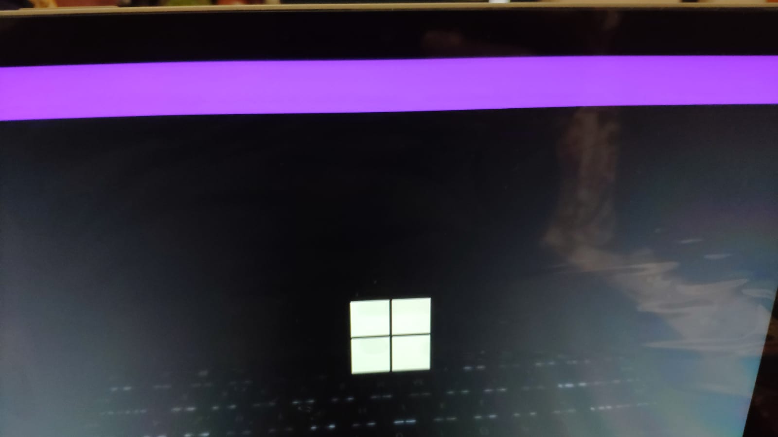

                                    On my Pro 7 device, the purple stripe appears at startup. Also, the charge level does not exceed 65%. Multitouch does not work. Could it be a bios issue?
                                      Clean ME file

                                        #79
                                        Re: Microsoft Surface Pro 7 NEED BIOS. HELP!
                                        Originally posted by hoaca388 View Post
                                        Clean ME file
                                        Unfortunately it's stuck in the logo.
                                          #80
                                          Please help me.
