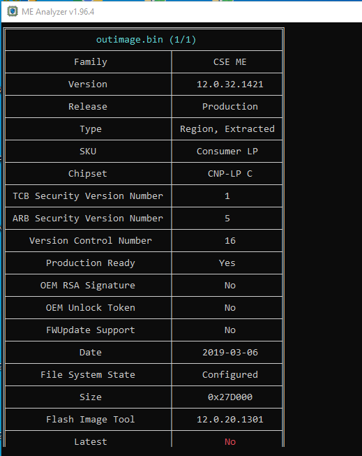

                          please i need flash image tool V 12.0.32.1421
                            • 22186
                            #53
                            Re: ME Firmware Cleaning Guide
                            The FIT tools version doesn`t have to match exactly, as long as its version 12 its ok (version 12 ME firmware,use version 12 of FIT). The link to the tools is in the first post, along with the win-raid guide

                              #54
                              i do it with version 12 but the hdd becomes not detectable in setup
                                • 22186
                                #55
                                Post a picture ,i don`t understand what you mean
                                • hayt
                                  • May 2021
                                  • 16
                                  • tunisia
                                  #56
                                  i do clean me region to the bios and i flash pc but hdd becomes not detect in setup and when i flash with the old bios the hdd is detected
                                  the new bios cleared is in the picture
                                    • 22186
                                    #57
                                    Maybe you did something wrong. Post your original bios backup in a new thread,not in this thread please - https://www.badcaps.net/forum/forumdisplay.php?f=40
