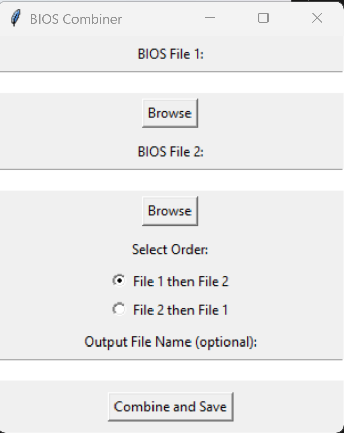

            Hi all, want to shere a python scrip i made to combine and seperate laptop with 2 bios chip,
            might be usefull, theres a python scrip (source code ), portable and installer version all work and function the same, use 1 you like
