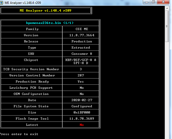

            If the bios update image is a full bios including the ME firmware and not just a bios update which is the bios region then yes.Once the laptop is booted the ME will be married to the chipset and become initialised. For more info see the ME cleaning guide at win-raid section A. ,B. , C. https://winraid.level1techs.com/t/gu...lization/31277
            Hi, this guide is very valuable and i am currently reading it and trying to understand these methods .On the other hand i am sharing an image of ME analyzer reading the file bios bin and it has state configured but i am not able to understand Chipset status , SKU is Consumer H which is valid but chipset name i am not getting it.
            Thanks in advance.

            • oscars
              • Oct 2013
              • 4
              • Turkey
              Re: ME Firmware Cleaning Guide
              what do you think about "Intel Easy Clean Me"? i use this before and it worked for me.

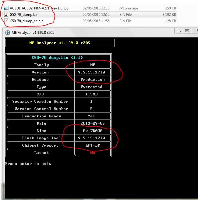

                  when i try to open bios file i get this error
                    • 21889
                    #29
                    The bios is corrupt.Post it in the bios requests for fixing .
                    • ktmmotocross
                      Boardkiller
                      • Feb 2014
                      • 3627
                      • slovakia
                      #30
                      but it show me even on known good bios
                        • 21889
                        #31
                        You should open the bios with ME Analyzer first and check what ME firmware version you have,then you need the FIT tools version that matches. You`ve been trying to open a G50-70 bios that has an ME FW version 9.5 with FIT 11 . Each ME firmware version has its own set of tools.There`s a link in the first post to all the tools, and the full ME cleaning guide at win-raid .
