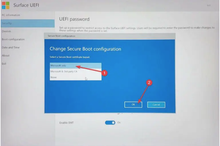

                            #133
                            Re: Need UEFI Password Removed from my Surface Pro 5 BIOS DUMP
                            I have a surface pro 5 (8/256) 1796,M1007506-015
                            Bought it second hand from a shop, it works, I can reinstall it from usb, but when the system loads, a red bar with opened lock appears on top, which is annoying. (Also, I can't change the security, Tpm, secure boot settings in the Uefi menu) I made dump and attached from original rom.
                            Atm i flashed with OEMCA, SN.:789789789 without UUID. (Attached picture)
                            The touchscreen and TP works in Uefi, everything is fine until reinstall windows, what i thought without uuid: Surface app closing, and can't install drivers.
                            Anybody can help to unlock my original bios?
                            Thank you

                              #134
                              Thank you
                              try

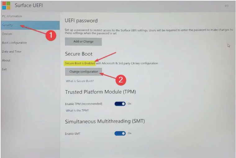

                                #135
                                try
                                Wow, nice work, thank you.
                                Only one thing remained: the red bar with padlock on top.
                                I tried to set new password then cleared, without luck. Any idea?

                                  #136
                                  found this on net:
                                  Solution: Turn on Secure Boot
                                  To turn on Secure Boot to help make your Surface more secure:
                                  Shut down your Surface and wait about 10 seconds to make sure it's off.
                                  Press and hold the volume-up button on your Surface, and, at the same time, press and release the power button.
                                  The Microsoft or Surface logo appears on your screen. Continue to hold the volume-up button until the UEFI screen appears.
                                  Select Security.
                                  Under Secure Boot, select Change Configuration.
                                  Select a Secure Boot certificate keyset (for example, Microsoft only).
                                  Select Exit > Restart now to save your changes and restart your Surface.

                                    #137
                                    found this on net:
                                    Select Security.
                                    Works perfectly Thank you again.
