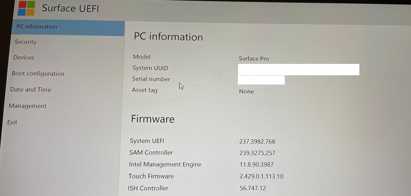

      Surface Pro 1796
      Hi
      I have a Surface Pro 1796 (Gen.5). A bios password is set. I know the password but I can't change it. I can't change all the other options either, such as Security, Secure Boot, m TPM SMT etc..
      It also says "some settings are managed by your organization"
      Is it possible to flash the bios again so that I can use all options? Are there other solutions so that I can use the device to its full extent?
      note the attachments.

        #103
        Re: Surface Pro 1796
        Originally posted by t000
        Hi
        Regards
        post the original bios ..

            #105
            Where can I find instructions on how to save the bios?
            Regards
            you need an SPI programmer ...
            you can find more videos on the internet >>
            https://www.youtube.com/watch?v=DWWigscuQDY

                #107
                Re: Need UEFI Password Removed from my Surface Pro 5 BIOS DUMP
                Hi, I have a Surface Pro 5 with a lost system password Can you help me to clear it?
                Cheers
                  • 20990
                  #108
                  Cheers
                  Compare a locked and unlocked bios with a hex editor,there is only one thing to change.

                    #109
                    When I compare the two posted files in this thread on page 4, my compare tool finds a few scattered diffs and a huge block which is different. I can't figure out which diff is the significant one.

                      #110

                      • SiO2
                        • Apr 2022
                        • 24
                        #111
                        Great, now I see the byte that matters Thanks, will try it!
                        Update: My Surface is alive again and running a recovery. Thanks a lot!!! You saved my day
