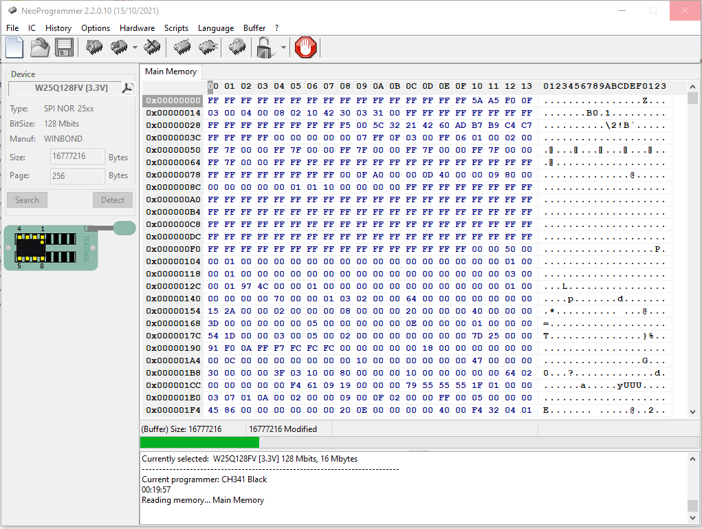

                          I got my t470 20HE corrupted in a bad flash (no boot).
                          The winbond is a 25Q80JV 8Mb chip, but all I see here is 16Mb files for this bios.
                          I used Neo programmer and a ch341 to read the bios.
                          Am i missing something?
                          is there a way to extract a bin file from a bios update?

                            #53
                            Re: T470 bios needed
                            101.4 KB is far away from a good read. Try again be more careful.

                                #55
                                I found an other one ; 25Q128FVSQ
                                seems to be the right size, but the read freezes (neo 2.2.0.10)
                                Current programmer: CH341 Black
                                SPI ID: EF4018
                                Currently selected: W25Q128FV [3.3V] 128 Mbits, 16 Mbytes
                                i'm reading on board, the chip gets detected

                                  #56
                                  "25Q80JV" size is (1MB/8Mbit/1024KB) and it's a Wrong chip, search for another chip on the Motherboard (Both sides).
                                  25Q80JV is the most famous spi chip around here.
                                  I don't understand why rookies likes him the most, probably because of the number 80 on the marking.

                                      #58
                                      Edit:
                                      Yes it is, that's the right one. Are you using a clip to read the chip?
                                      Yep, the full aliexpress package.
                                      Freezes sometimes in the beginning, sometimes halfway.
                                      desolder?

                                        #59
                                        They probably assume it will be 8MB. Also sometimes it has the same package as the BIOS chip (SOP8/SOIC8).
                                        Yep, I bet that's exactly why.
                                        Maybe it's time to put in my signature - "Do not touch the 25Q80xxxx chip"
                                        Edit:
                                        desolder?
                                        Absolutely.
