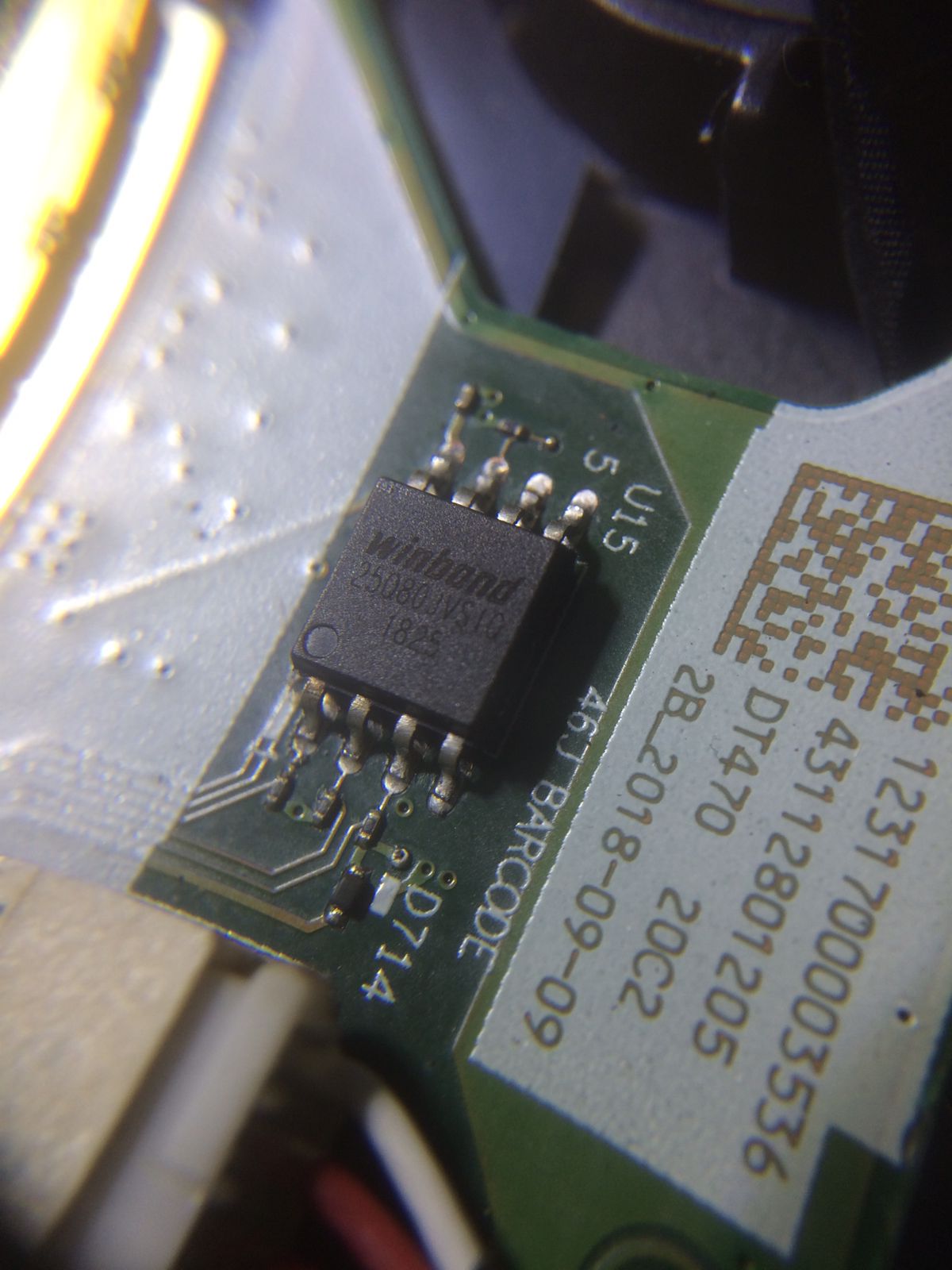

    Originally posted by Jetro007
    it was sitting next to the cmos battery, smiling at me

      Re: T470 bios needed
      Originally posted by Vesko356
      I'm not sure my solder skills are up to it.
      isn't the fact it starts reading a sign the spi communication is ok?
      Can the reason be it hangs, it is corrupt?
        No, if it was "corrupt", the laptop wouldn't turn on.
        It's just the crappy chinese clip doesn't make a good contact at some of the chip legs, or/and the cable has become unsoldered on one of the pins (the cable is also thin and crappy), that's why.
        Edit; You have to read the chip, then erase it, then program it with the patched dump, then erase it again and program it again with the original dump. I just don't see how it's going to happen with that crappy clip...
          Yeah, i get mixed reactions from different usb ports. Maybe the chip is drawing to much power. got a 90% read one time.
          The laptop doesn't realy turn on.
          The keyboard illumination and power button briefly turn on, then everything shuts down.
          I'll try to desolder it tomorrow.
          If i get succesfull reads, schould i flash the bios posted in the beginning of this thread?
          Thx for the advice so far
            Oops my mistake - I did not read the whole your first post because of the obviously smaller archive, thought the goal was unlocking but that doesn't change the meaning of what I said, the chip very rarely happens to defect, the much more likely cause of your problems is what I already told you.
            BTW what do you mean by "corrupted in a bad flash" - during the Windows update, or something else?
              yes, during a windows 'system' update.
              when i saw it reboot into a flash, i scrambled for my charger, because i didn't want the battery to die, but i must have bumped it or so.
              It's my old work laptop, but the password was already removed. was running perfectly until the windows update went wrong.
                OK everything is clear, there is no way the chip to get damaged because of this, you just interrupted the update, and it turned out to be the cause of the issue, but that doesn't mean the chip is already defective.

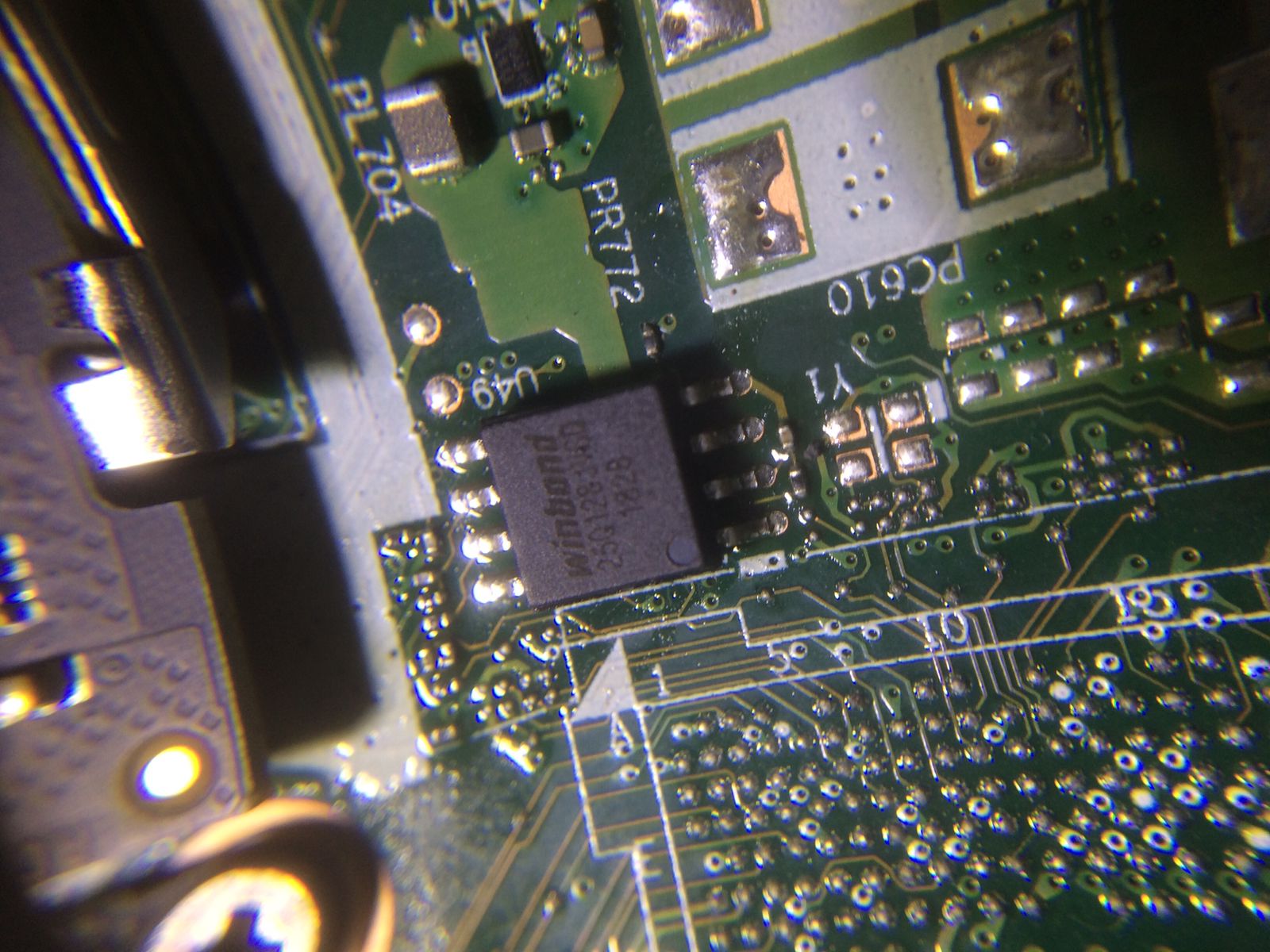

                  Hello Everyone,
                  I need BIOS for My Lenovo T470 20JN-S0L303 S/N: PF-151WQL
                  which is IC U49 code WINBOND 25Q128JV
                  and I also need BIOS for for IC U15 code WINBOND 25Q80JV
                  My Lenovo T470 condition now is black screen after softstart, Lenovo Logo doesn't appear after backlight keyboard was dimmed.
                  Thank you
