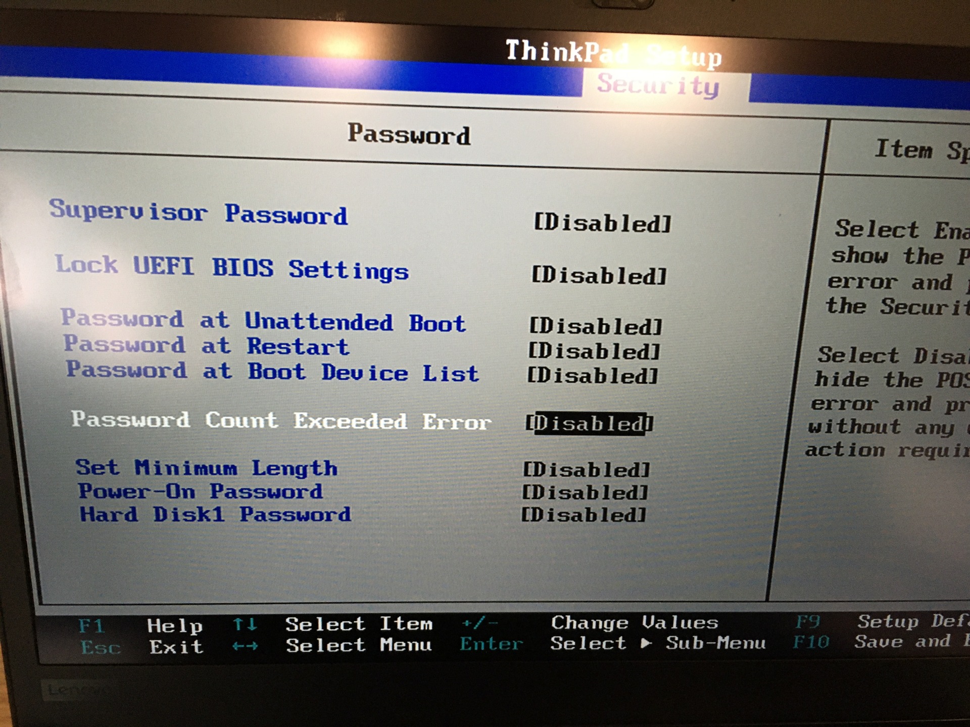

              • Verlengsnoer
                • Sep 2016
                • 110
                • Netherlands
                #1947
                Re: LENOVO BIOS AUTO-PATCHER for Supervisor Password Removal
                Originally posted by Markus1741
                Hello, the autopatcher only works on 4th to 8th generation Lenovo notebooks. Everything after that doesn't work.
                Your notebook is 9 generation.
                hi markus, thanks for your response, but the machine is gen 8 core i5, not gen 9
                here a picture of the bios, the original bios you can access the bios, but cant change anything because of the password
                • exe557
                  • Jan 2021
                  • 24
                  #1948
                  It's not related to CPU Generation.
                  T590 is 9th generation of ThinkPad. Autopatcher just works until 8th Gen T580,T480,X280...
                  For T590 you need Vertyanov or SVOD to remove password from MEC chip

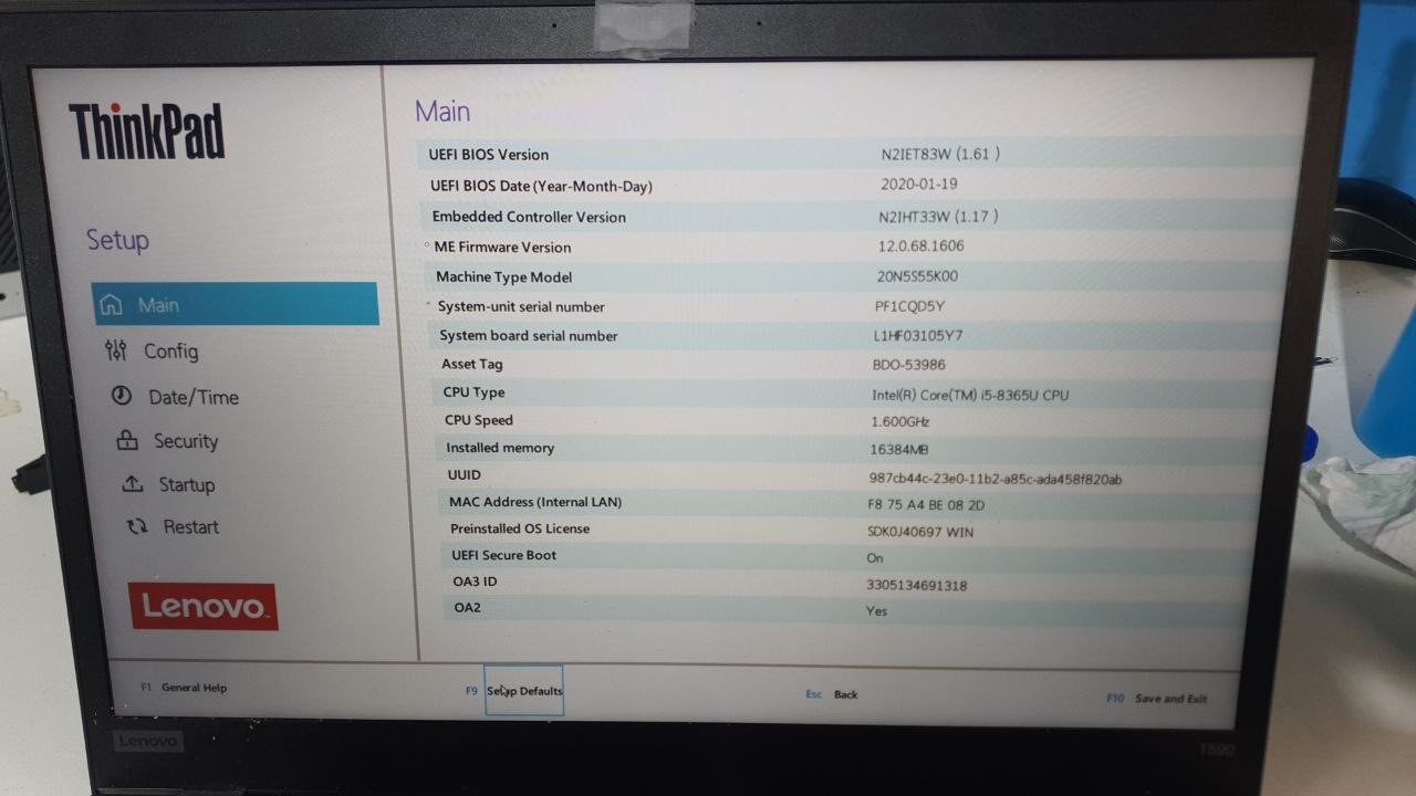

                  • ronaldopdias
                    • Jul 2015
                    • 95
                    • United Kingdon
                    #1949
                    Hi. Can anyone help me with this?
                    Right after patching the file and the command terminal disappears the Patched file just deletes itself.
                    Can someone patch it for me or find the password on this bin file?
                    I will really appreciate it, please.
                    • hardware1
                      • Sep 2021
                      • 2949
                      • N/A
                      #1950
                      Maybe you can't use DXE method, because your device is 10th Gen.

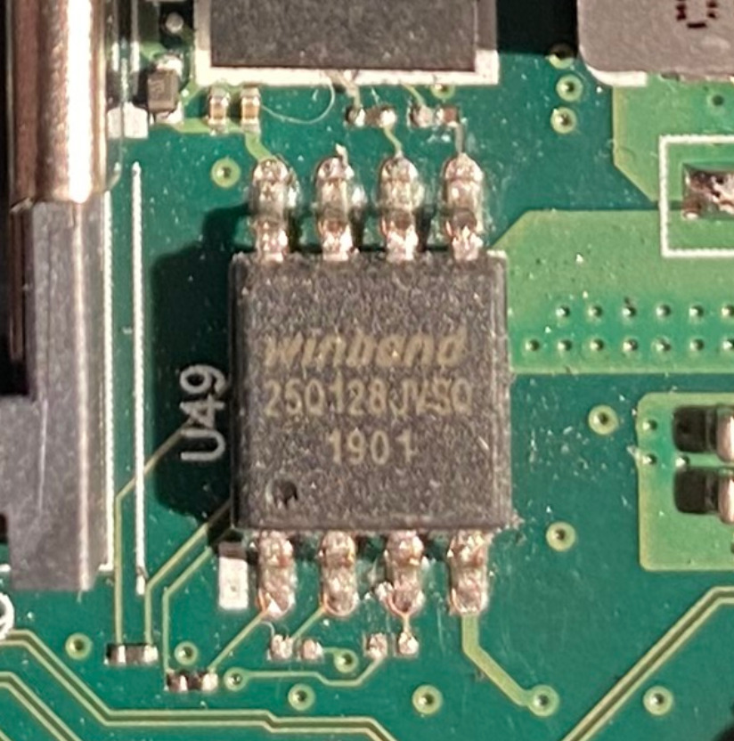

                              Problem: Lenovo x250 that only beeps on startup after autopatcher.
                              Winbond flash chip "W25Q128.V" (16384 kB, SPI) on ch341a_spi
                              This is my first time so be gentle...
                              I studied this thread and other resources very carefully but I must have missed something. I wonder if it was because I did it on M1 mac? Other than that I have no idea. Please help this poor computer come back to life 🙏
                              Method
                              Patch the dump
                              1. read BIOS chip -- Flashrom compiled on M1 mac
                              2. create dump file
                              3. do it again 2-3 times
                              4. compare
                              1. diff 1.bin 2.bin
                              5. Patch the dump (used python 3.10 on M1 mac using Parallels)
                              autopatch file_you_want_to_patch.bin
                              Flash and Restore the BIOS
                              1. Flash and replace current BIOS with the generated patch file-- tried renaming to 1.bin-- tried using a patched BIOS from this thread — https://www.badcaps.net/forum/attach...4&d=1604423061
                              2. Disconnect HD
                              3. tape down anti-tamper switch
                              4. hold BIOS button and Boot the machine — machine won't boot with button pressed, had to press it afterward
                              Result: GETTING ONLY BEEPS for my trouble
                              ————— couldn't go further ———————
                              5. press enter for BIOS settings
                              6. Enter any character when asked for Supervisor Password
                              7. Press enter when it shows Hardware ID
                              8. Press space bar 2x when asked
                              9. Turn off machine
                              10. Restore original BIOS
                              11. Reset BIOS settings to factory default
                              **Original dump old1.bin attached
                              **Patched file 1.bin attached as well

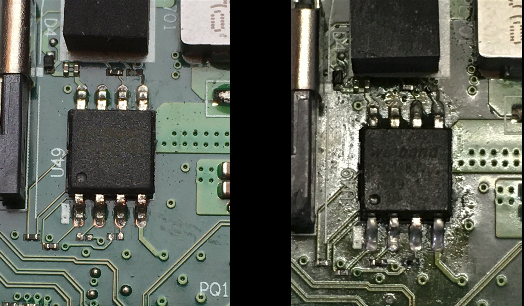

                                • another_one
                                  • Oct 2022
                                  • 7
                                  • Switzerland
                                  #1956
                                  could this libusb message relate to my problem?
                                  Code:
                                  $ flashrom -p ch341a_spi -r bad-1.bin
                                  flashrom v1.2 on Darwin 22.1.0 (arm64)
                                  flashrom is free software, get the source code at [url]https://flashrom.org[/url]
                                  Calibrating delay loop... OK.
                                  libusb: info [darwin_claim_interface] no interface found; setting configuration: 1
                                  Found Winbond flash chip "W25Q128.V" (16384 kB, SPI) on ch341a_spi.
                                  • another_one
                                    • Oct 2022
                                    • 7
                                    • Switzerland
                                    #1957
                                    Things have gone from bad to worse. I wrote the original bios file back to the chip and now I can't even get the machine to turn on...

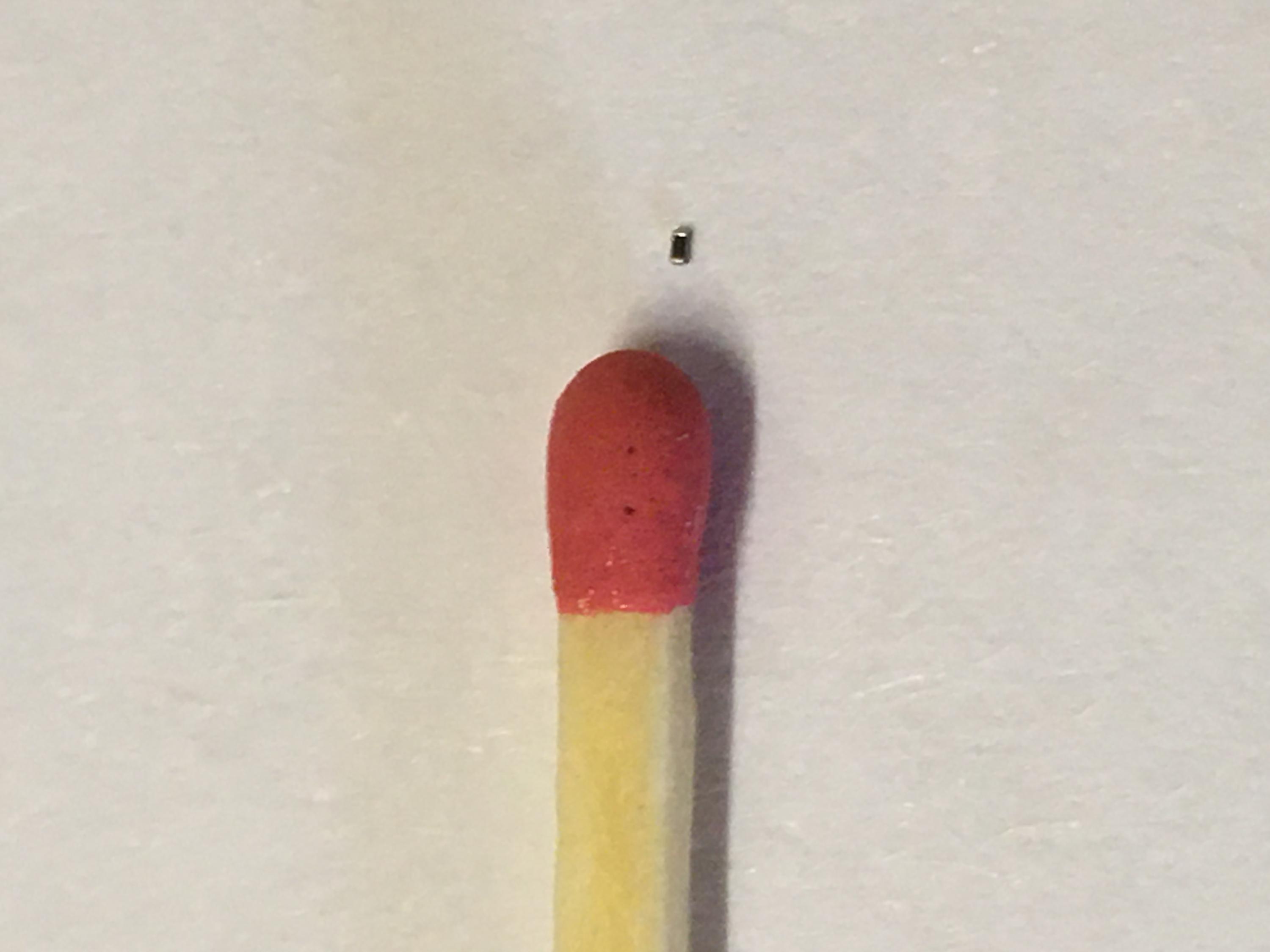

                                        • Markus1741
                                          • Sep 2020
                                          • 967
                                          • N/A
                                          #1960
                                          Are the resistors that lead away from the chip okay? Not that it looks like it. A photo of the current chip would be very helpful.
