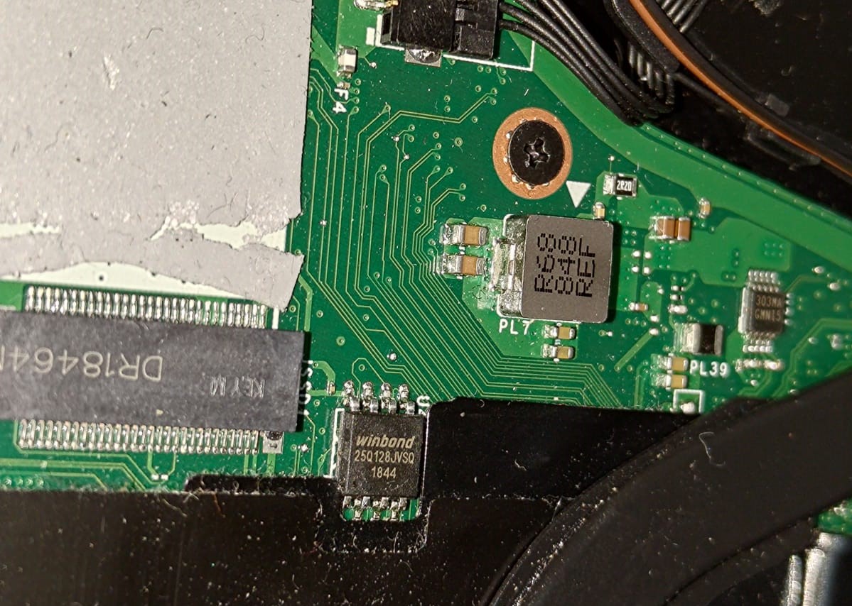

    found out already that it is the 25q128jvsq
    could u help me to know which chip i should backup and flash?
    i have two winbonds on my X380 Yoga:
    1 - winbond 25q80dvsig 1844
    2 - winbond 25q128jvsq 1844
    thanx in advance ^_^

      25q128

            it saved my locked lenovo x380 i bought it with locked bios and then tried to tamper with the setting with a tool used in windows(i wanted to install ubuntu alongside windows). then i got locked out of my laptop for good saying too many attempts for the supervisor password i could not even boot.
            then bought the CH341A programmer
            removed every battery and power source
            did multiple backups of the winbond 25q128 chip
            did an erase and then flashed the patched one and did as advised
            then turned off and ERASED the chip again(at first i did not reset which resulted in black screen and melody beep sound)
            then flashed the original backed up bios again and did reset as advised
            and voila!!! thanx again

                  Worked perfect for our Lenovo ThinkPad T480s and its MX25L12873F chip [1], flashed from a Raspberry Pi with a simple SOIC-8 clip from ebay ☺️ Thank you very much for this great tool!
                  [1] T480s has a second chip, a Winbond 25Q80DVSIG, so make sure to read/write the right chip!
