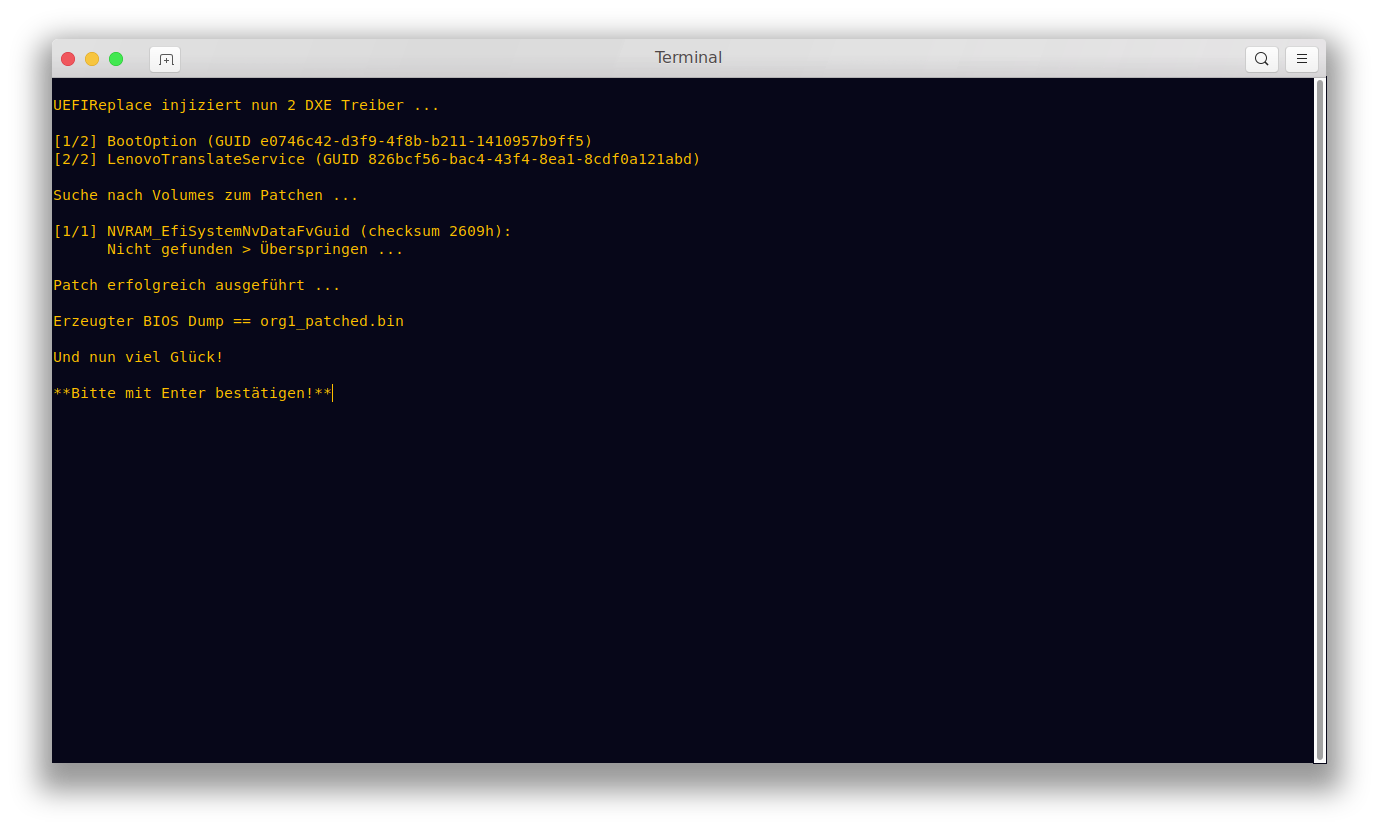

                                      Re: LENOVO BIOS AUTO-PATCHER for Supervisor Password Removal
                                      I've patched many and never had any problems, bu now I have T550 adn I have a problem with patching my file. I got:
                                      Using UEFIReplace to inject 2 DXE drivers...
                                      [1/2] BootOption (GUID e0746c42-d3f9-4f8b-b211-1410957b9ff5)
                                      [2/2] LenovoTranslateService (GUID 826bcf56-bac4-43f4-8ea1-8cdf0a121abd)
                                      Looking for volumes to patch...
                                      [1/1] NVRAM_EfiSystemNvDataFvGuid (checksum 2609h):
                                      Not found... Skipping.
                                      Done.
                                      PATCH FILE: T550_oryginal_PATCHED.bin
                                      Good luck.
                                      Using autopatcher_0.3
                                      Tried drag and drop inot the "Autopatch.py".
                                      Laptop stops on "ThinkPad To interrupt normal startup, press Enter", but when I press Enter nothing happens. Any solutions?

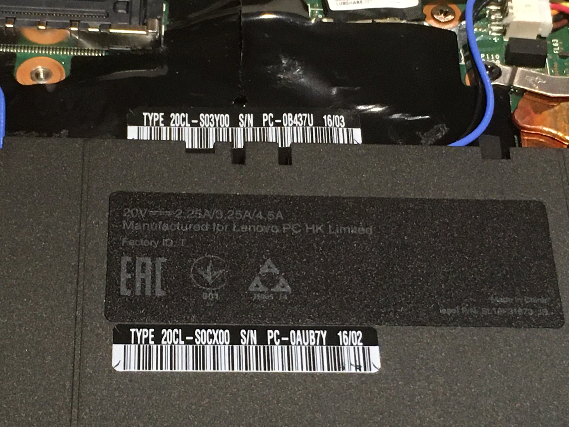

                                        Hello, I had the exact same problem with the same model.
                                        I think it is due to a corrupted ME region in the original BIOS file.
                                        At that time nobody wanted to help me either, I'll try it once.
                                        Greetings to Poland.
                                        https://www.badcaps.net/forum/showpo...postcount=1278
                                        • zerbatin
                                          • Feb 2021
                                          • 9
                                          • Poland
                                          #2100
                                          Unfortunately it didn't change anything, it's still hanging on a black screen.
                                          Anyway, thank you very much for your efforts/time and greetings to you my German neighbor.
