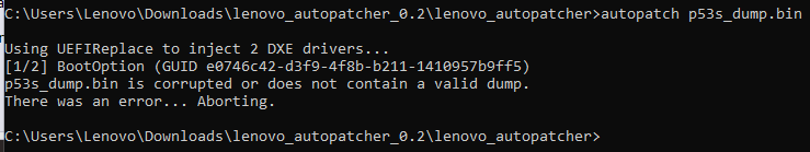

                              • MMbacon
                                • Feb 2022
                                • canada
                                #1815
                                Re: LENOVO BIOS AUTO-PATCHER for Supervisor Password Removal
                                I'm not sure if anyone is following this Thread. But I'm stuck like many. The autopatcher isn't working on my computer. It starts then crashes. I've attached my bios dump for a P53s. If someone could patch i would be very greatful.
                                • RethoricalCheese
                                  • Mar 2013
                                  • 1519
                                  • Estonia
                                  #1816
                                  You are stuck like many for the exact same reason - failed to read the dump properly.
                                  But doesnt matter too much because autopatcher is unable to unlock P53s anyway. You need svod3, rt809 or vertyanov to read/write MEC chip instead.

                                    • rednax
                                      • Aug 2022
                                      • 4
                                      • Philippines
                                      #1818
                                      Your dump file seems to be invalid.
