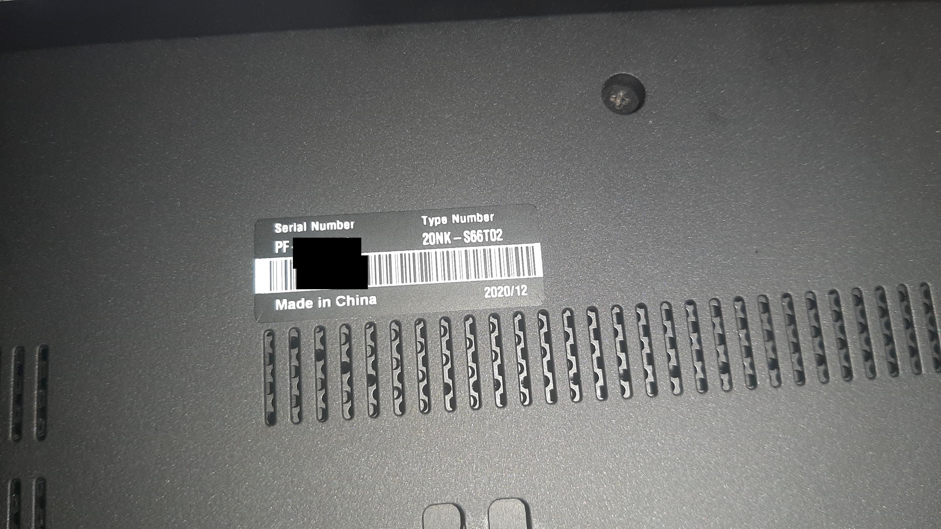

            • esprugodoys
              • May 2018
              • 6
              • Philippines
              #1786
              Re: LENOVO BIOS AUTO-PATCHER for Supervisor Password Removal
              Originally posted by AAAC
              There are a few exceptions, I have this T495 on my list of compatible models:
              ThinkPad T495 (TYPES: 20NJ and 20NK)
              @esprugodoys
              Have you tried to flash back Original BIOS in order to check that you have a “good” backup?
              @AAAC
              yes. my backup dump is good, the one i attached on my previous post that is the backup that i used. laptop is back to its original state now which has a Power-On/bios password using that dump.
              this particular model is Type 20NK as indicated on the sticker at bottom cover.

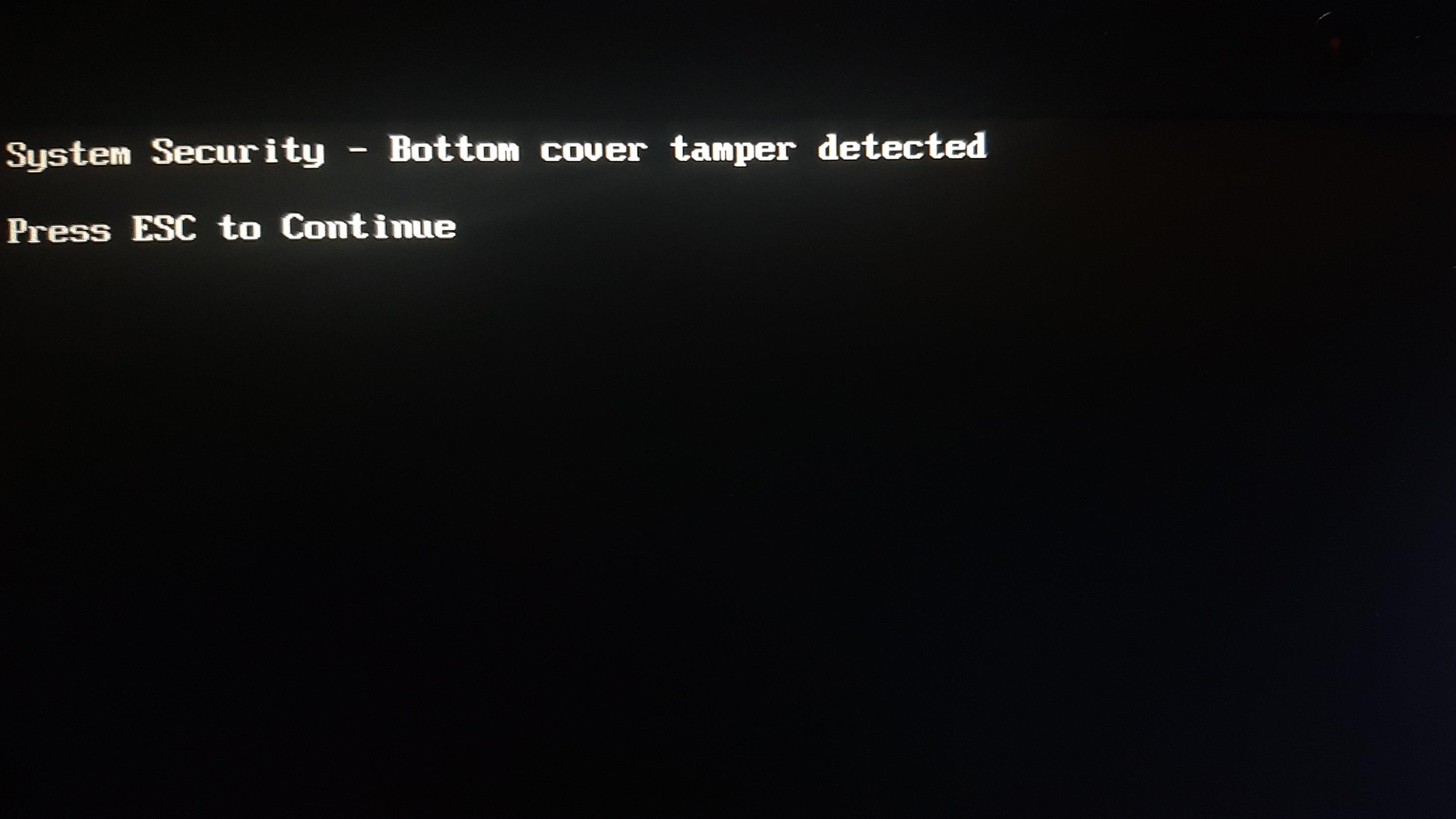

                  • esprugodoys
                    • May 2018
                    • 6
                    • Philippines
                    #1789
                    @esprugodoys
                    Can you go into Setup/BIOS? Power-on the laptop, press F1 key to go into Setup, when asked for password just press ENTER key, if it lets you get in (in read-only mode) go to Security and check Supervisor Password status.
                    I am not able to get in SETUP/BIOS (read-only mode).. as soon as I power it On, the "Bottom cover tamper detected" comes up after the Lenovo logo shows up.. which then prompts for a Fingerprint scan or the Power-On password.
                    Laptop just shuts down after 3 incorrect attempts on the password prompt.
                    since the Power-On password is enabled, it would be safe to assume that Supervisor Password is Active or Enabled?
                    • AAAC
                      • Jan 2020
                      • 458
                      • Mexico
                      #1790
                      @esprugodoys
                      Most probably it's the Supervisor Password Active, unless you haven't reset CMOS by disconnecting all source of energy and also disconnecting CMOS battery.
                      So if you Original BIOS is good and safely stored, have you tried to look for a T495 patched BIOS to try? This patched bios is only used for the unlock, after that you will use the Original BIOS.
