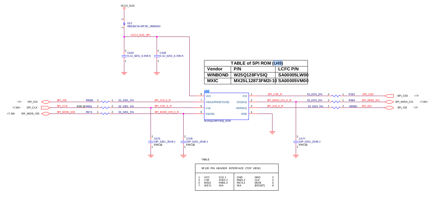

                                  Hi folks,
                                  I have a locked Lenovo T470 (20HE-S7DW03, TP00088A). I desoldered and dumped the eeprom (25Q128) – three times, just to be sure that the dump is OK. I patched it with autopatcher – it succeeded. After patching the new binary into the eeprom (and reading it back to verify) and soldering it back, the laptop doesn't start. Power button blinks three times after connecting the power supply, and pressing the power button doesn't have any effect.
                                  Could anyone help?
                                  Here's the dump, if someone could help…
                                  Thanks in advance.

                                      Hello, please check if all capacitors and resistors around the chip are ok. Not that a resistor was moved when unsoldering.

                                        Thanks. I loaded it, but it didn't help, because:
                                        You're right. Resistor and capacitor on the DO line went away. They're so tiny and so close to the chip I didn't notice it even with a loupe…
                                        I shorted R694 and it started working. I guess I just got rid of some ESD protection, but I probably couldn't solder a resistor that tiny with my tools anyway…
                                        The laptop works, there's no password, but next time I think I'll try the clip approach first…
                                        Thank you!

                                          Hello, nice that it works. I know the resistor is type 0201 and is very difficult to solder without a microscope.
                                          This happens very often in this forum that the resistances are broken off, and then suddenly nothing works.
                                          In such a case it is often better to solder fine wires to pin 1,2,4,5,6,8 it is much safer.
                                          Greetings to Poland
