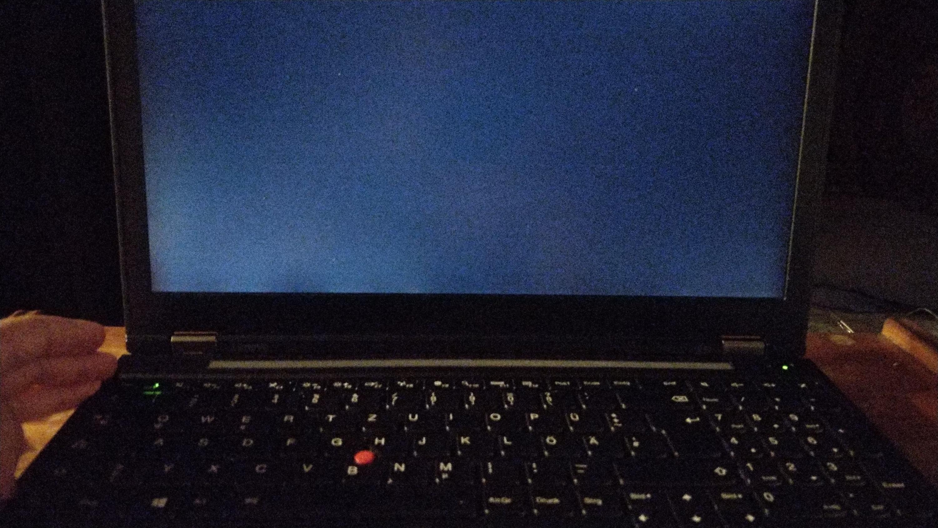

                        • Merlinox
                          • Jul 2022
                          • 5
                          • France
                          #1712
                          Re: LENOVO BIOS AUTO-PATCHER for Supervisor Password Removal
                          I have successfully patched the BIOS dump and flashed it. Steps 1-7 went smoothly,
                          I was told "TPM certificate changed. Turn it off." during the process.
                          @AAAC pointed out that this means that the laptop is unlocked.
                          After rebooting, the laptop posts, I can press enter to enter the setup, then the laptop beeps 4 times and shows the following messages:
                          "0271: Check date and time settings
                          0183: Bad CRC of security settings in EFI variable
                          Press F1 to enter setup"
                          Upon pressing F1 the screen stays backlit and the keyboard works (num lock toggle + fn lock toggle).
                          It stays like that indefinitely.
                          The issue persists with or without SSD plugged in.
                          What more can I do ? Did I miss a crucial step ?
                          I scrupulously proceeded with data integrity checks at every possible step.
                          edit (solved):
                          STEP 8: Restore original BIOS
                          means reflashing the first BIOS dump
