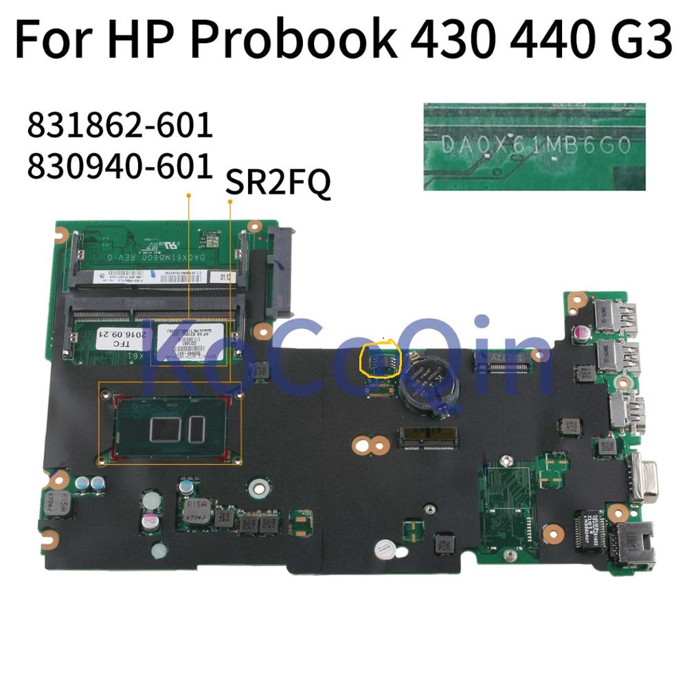

    Originally posted by lapfix
    empty one , you waste your time .
    your bios is near bios battery ...the only one .
    https://ae01.alicdn.com/kf/HTB1_D3nb...3-I7-6500U.jpg
    this is chip im using. circled in yellow. isnt this the correct one??
    • lapfix
      • Mar 2020
      • 2765
      • my workshop
      Re: BIOS REQUEST HP 430 g3
      yes

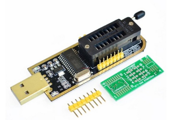

            Thnx but I have desoldered the chip and soldered directly to the programmer as advised earlier in the thread.
            What could be the cause of the empty reads.?
                What are you attaching your programmer to ? ,maybe it isn`t proving enough amperage
                  Well im using one of these with the bios chip soldered to it.
                  Attaching it to my ACER laptop.
                  Maybe its the installation thats the issue.?
                  I assume my laptop will provide enough voltage?
                        I think I was using the wrong version for the black pcb programmer and also the driver with windows 10 had issues.
