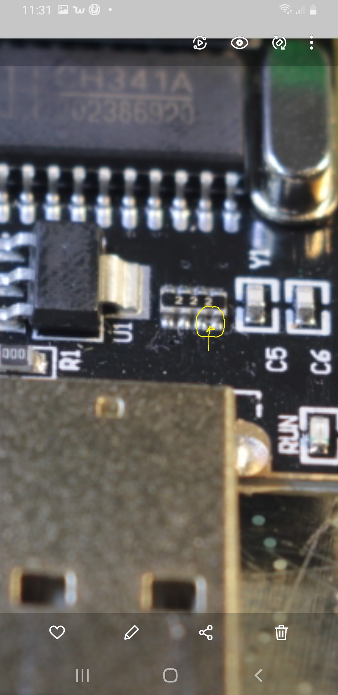

                      #50
                      Re: BIOS REQUEST HP 430 g3
                      Guys,
                      so I just soldered the chip to the larger adapter board.
                      while reading the chip I saw a thin wisp of smoke coming from the chip.
                      I unplugged the programmer and checked closely under the scope.
                      Can anyone tell me if the two pins circled and meant to be connected.?
                      There is a solder link between them.It doesnt look like a track.
                      • vikivng
                        • Feb 2019
                        • 228
                        • uk
                        #51
                        I tried it again and it didnt overheat.
                        pls check this..
                        I did hear that this chip needs Asprogrammer 1.4 or ch341 1.18.
                        • vikivng
                          • Feb 2019
                          • 228
                          • uk
