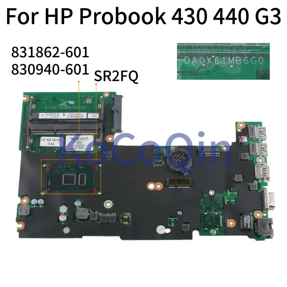

                          Can someone show a pic of where the correct chip is on the HP 430 G3 LAPTOP?
                          • servis_null
                            • Oct 2014
                            • 82
                            • Croatia
                            Re: BIOS REQUEST HP 430 g3
                            Should be next to bios battery..
                                        empty one , you waste your time .
                                        your bios is near bios battery ...the only one .
                                        https://ae01.alicdn.com/kf/HTB1_D3nb...3-I7-6500U.jpg
