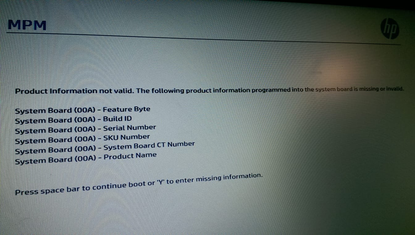

        HP ProBook 640 G2 MPM
        HP ProBook 640 G2 MPM.How to solve this problem

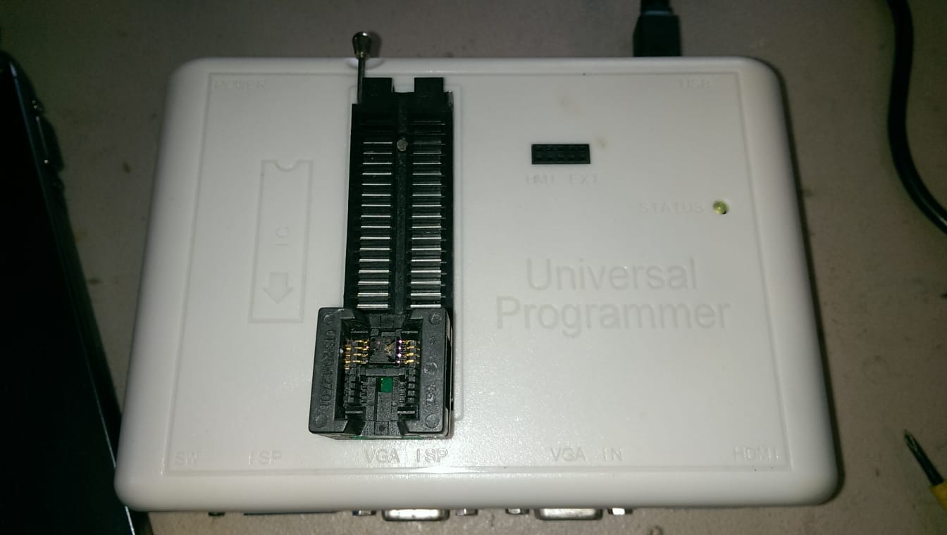

                  • Japanac
                    • Aug 2014
                    • 95
                    • Serbia
                    #29
                    Re: HP ProBook 640 G2 MPM
                    Here I read it again
                    • peste
                      • Dec 2016
                      • 13599
                      • ROMANIA
                      #30
                      same thing ..remove the bios chip from the motherboard before reading or writing ..
                      • Japanac
                        • Aug 2014
                        • 95
                        • Serbia
                        #31
                        This was read with RT809H
                        • Japanac
                          • Aug 2014
                          • 95
                          • Serbia
                          #32
                          • peste
                            • Dec 2016
                            • 13599
                            • ROMANIA
                            #33
                            if the bios is ok, try entering the DMI information

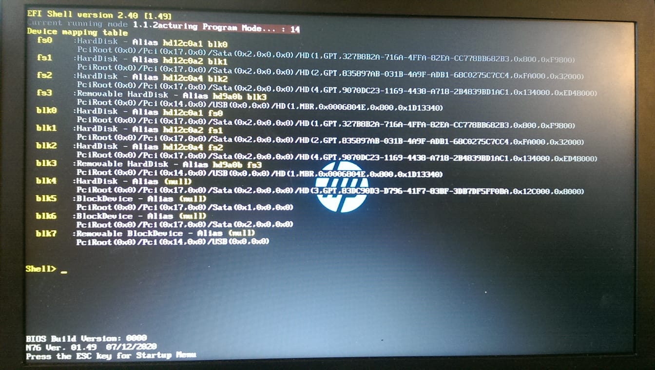

                              #34
                              All I get when I boot from usb flash is this.
                              • peste
                                • Dec 2016
                                • 13599
                                • ROMANIA
                                #35
                                what motherboard code do you have ???
