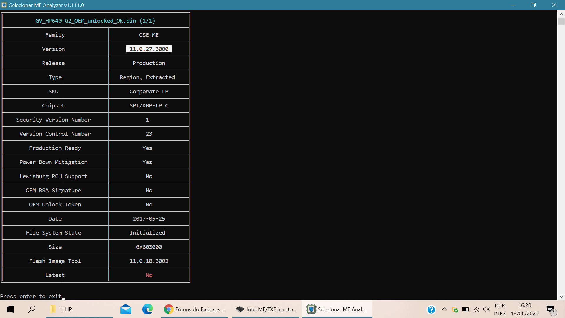

          Slow Start HP 640 G2 Probook - Bios
          I understood.
          This is the original Bios file that was unlocked with the tool posted here on the forum.
          Could someone clean it for me?

            I tried to use the "Intel Easy Clean Me" program, but it doesn't recognize my notebook's bios.

              [QUOTE=GValdameri;967761]I tried to use the "Intel Easy Clean Me" program, but it doesn't recognize my notebook's bios.
              It does not work,there are videos on youtube that show how to clean me.you must use flash image tool.

                  • GValdameri
                    • Apr 2020
                    • 24
                    • Brasil
                    Re: Slow Start HP 640 G2 Probook - Bios
                    Originally posted by peste
                    try..
                    I did the test, but it doesn't start.
                    The LED on the numlock and capslock keys flashes 5 times
                    Attached is the updated bios that was working.

                        I identified that the bios chip I was using for testing was defective.
                        So I saved the new BIOS settings on the original chip.
                        I tested it with the two versions that you modified and with an older one that I had saved.
                        The notebook turned on, but the charging time is the same.

                              The loading time is the same.
                              It is stuck in the BIOS loading for 30 seconds and after you start to load the system.
                              Only a few times did it start quickly with the previous bios, but these were rare cases.

                                  Hello friends.
                                  I did the tests with these BIOS images, but it didn't work, the startup time is the same and ended up disabling some motherboard peripherals.
                                  So I decided to leave the original configuration.
                                  Thank you for your help.
