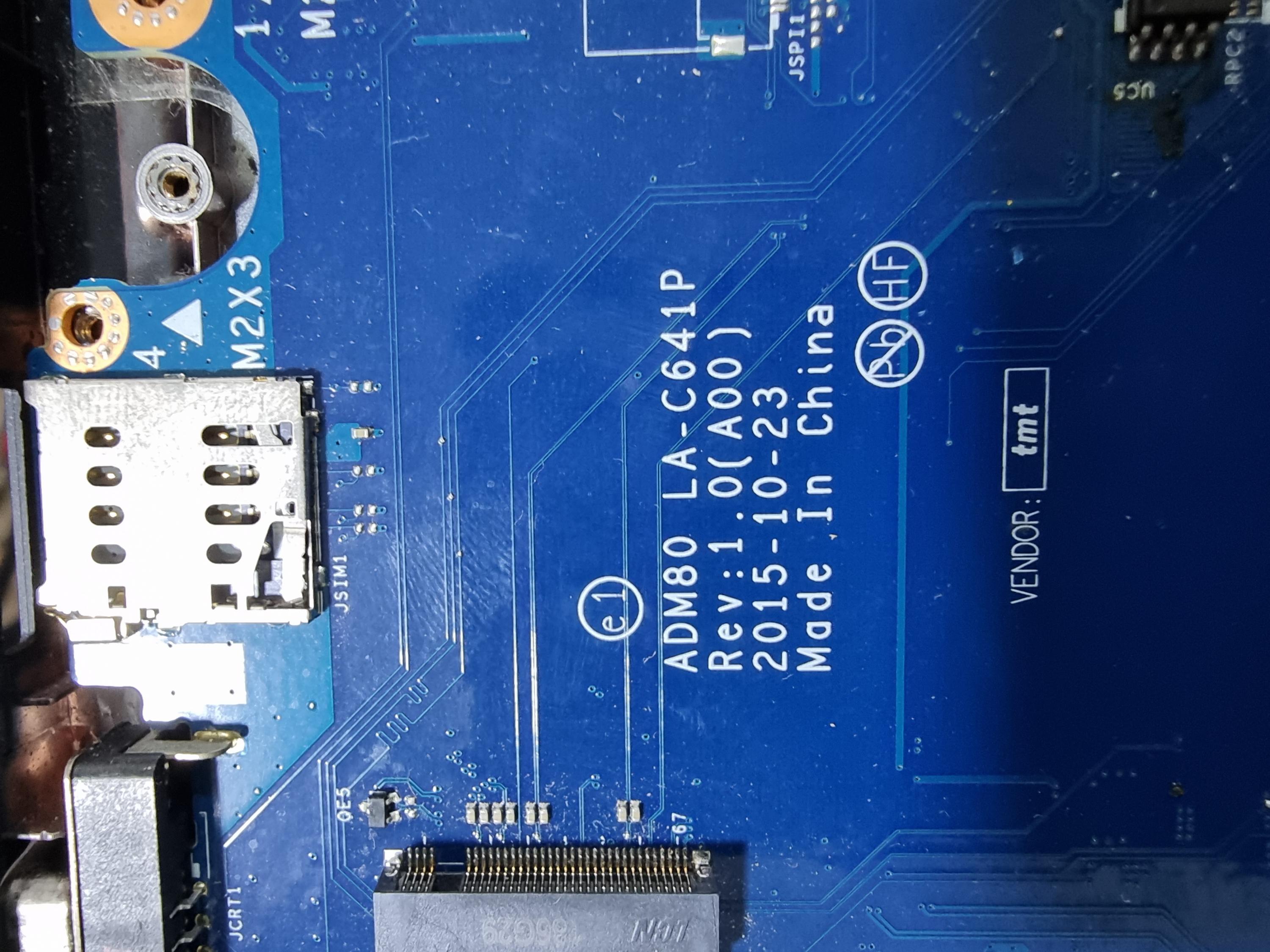

      Re: Dell E5570 - Bios / Clean ME ADM80 LA-C642P R1.0
      My Motherboard No. Is ADM80 LA C641P Rev 1.0 (A00) 2015-10-23. No display Sir pls help.

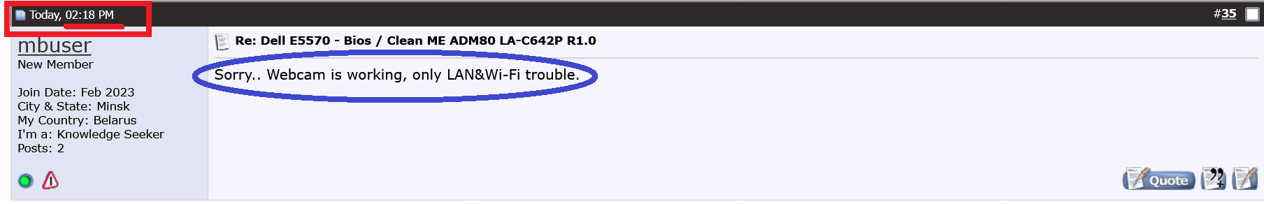

                              Hello.
                              I have a problem with Dell E5570 (La-C 641 PREV. 1.0(A00).
                              At the beginning laptop has no answer to power button.
                              Then I flashed W25Q128 with clear ME firmware from #2 post.
                              Laptop began start and work normally.
                              After installing Windows10 - LAN (I219-LM) can't installed, Wi-Fi device is no visible.
                              I tried to flash another firmware with clear ME, but nothing changed.
                              Could it be relate with incorrect firmware or it's a hardware problem?
                              Original dump is attached, please help to repair it, if it possible.
                              In addition. I got laptop without hard drive, Windows 10 was installed on new SSD.
                                  Originally posted by mbuser
                                  Hello.
                                  At the beginning laptop was no answer to power button.
                                  Then I flashed W25Q128 with clear ME firmware from #2 post. Laptop began start and work normally. After installing Windows10 - LAN (I219-LM) can't installed, webcam and Wi-Fi device is no visible. I tried to flash another firmware with clear ME, but nothing changed.
                                  Hello try this me clean file and let me know what happen ...
                                    Sorry.. Webcam is working, only LAN&Wi-Fi trouble.
                                    If you want to edit or add something just use the edit button and do it, there's no need to make new posts one after the other!!!
                                    Markus1741, Lan/Wi-Fi troubles are indeed indication of ME Firmware problems but usually when the bios is not working at all (no boot) bios region gets corrupted rather then the ME region (or at least more often) so the bios rgn must be repaired/replaced first (before the ME Firmware cleaning) to make sure the bios will be OK at the end.
                                          Thank you very much, trouble is solved.
