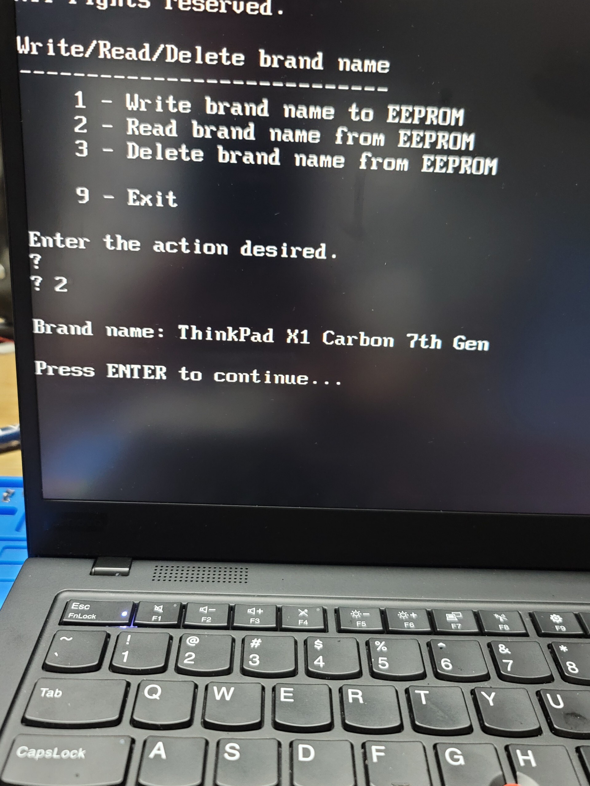

      Originally posted by wangbreeze
      did you update the product brand to thinkpad T**?
      Sure. I have successfully entered the brand name. Just like in the photo.
      But every time I start up, the laptop still reports error 2202.
      I don't know what to do anymore​
        not 7th gen just 7th
        Click image for larger version  Name:	Nouveau Image bitmap (2).bmp Views:	0 Size:	1.14 MB ID:	3220764
        otherwise use planar service with your serial
        https://www.badcaps.net/forum/troubl...id#post3220825

            #405
            Thank you so much.
            I have been trying to enter Brand name for 1 week but without success. With your guidance, I succeeded the first time.
            Thank you so much.

              #406
              Originally posted by noktabiz
              Change the ec you use. and write another one and enter your information again
              I followed Maxpower3's instructions and it worked. Follow him, you will also succeed.
              Let's thank Maxpower3.​

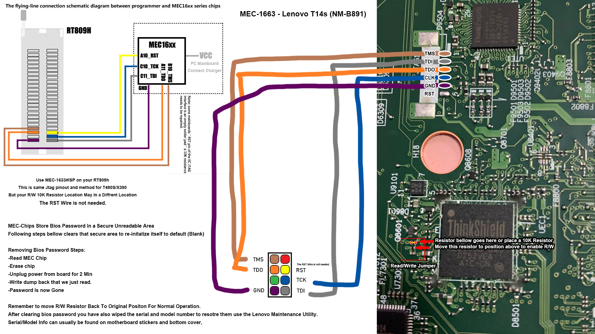

                            I have RT809F and a damaged Thinkpad T490 board (M2-Connector was damaged and is removed). I use it for testing the procedure of removing the SVP from MEC-Chip. (Yes, I have the SVP.) I do this test because we received Thinkpads T490 donated for our school but they have SVPs. At present they are used. But during summer holidays I hope to remove the SVPs this way.
                            Typ 20N3001EGE
                            Serial PF1DTJNC
                            Bios N2IET99W (1.77)
                            The MEC chip is recognized correctly. I can read and write the MEC using MEC1633_256. My problem is that erasing of the Chip doest not work.
                            Does anyone have an idea what the cause could be?

                                #416
                                My laptop has bios password.
                                Thinkpad T490S FT491/FX390 NM-B891 REV 2.0
                                S/T: MJ-0C3ABP
                                Here is bios dump. Please unlock it.
                                Thanks,...​
                                  S/T: MJ-0C3ABP
                                  Thanks,...​
                                  Hi !
                                  There is no difference between your uploaded MEC content and the factory one (attached)...they are identical.
                                  The password is stored in the 2K EEPROM inside the MEC.
                                  There are programmers (like SVOD 4) that can read the eeprom content separately and then you can delete the password.
                                  If you don't have such a programmer you can simply erase and reprogram the whole MEC1633 and after that reinsert the DMI info.
                                  This is my opinion.
                                  SS

                                    #418
                                    Originally posted by Stefan Steff
                                    Hi !
                                    This is my opinion.
                                    SS
                                    I read the Mec file, erased the chip. Reload the original file (do not edit). Password is removed. This is how I did it successfully for the T490S and T14 Gen 1.
                                    Thank you very much​
