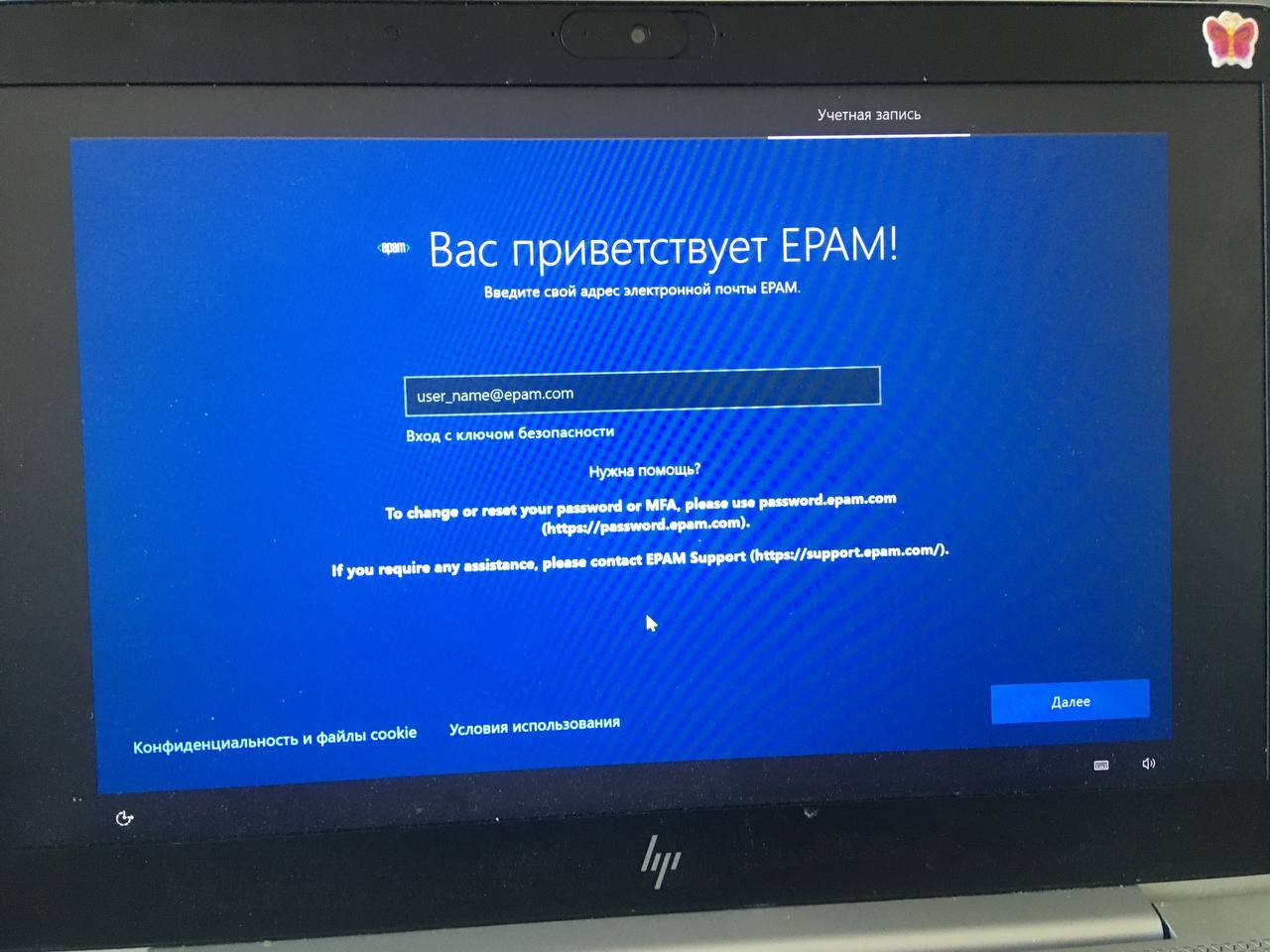

    Originally posted by SMDFlea
    RULES UPDATE for BIOS requests/offers AVOID BANNING, READ BEFORE POSTING
    RCUnlocker can delete computrace lock? Sorry, this is my first time encountering this. The laptop was blocked for organization; the laptop was scrapped. I was able to fix it, it did not turn on, but I see a blockage when installing windows.
    mb: computro 6050a2945601-mb-a01(1a)
    HP Elitebook 840 G5
    sku 2FA66AV
    UID 9B7337C7-0033-9973-5E10-38362DDAF283
    BIOS Q78 ver. 01.22.00 09/15/2022​

    • hoaca388
      Badcaps
      • Jan 2022
      • 11889
      #262
      HP Elitebook 840 G5
      sku 2FA66AV
      sn 5CG83260G2
      Install windown 10 home.

        • deeptenk
          • Sep 2023
          • 10
          • Belarus
          #264
          Originally posted by rex98
          upload your main bios. and serial number here.
          I already did it, look up please. sn 5CG83260G2

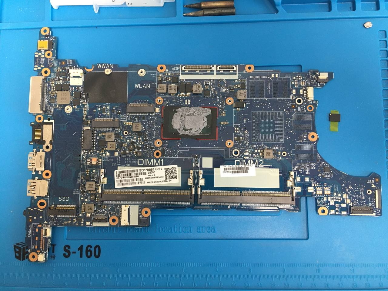

            • deeptenk
              • Sep 2023
              • 10
              • Belarus
              #266
              Originally posted by minhdigital
              Send to you
              What changes have you made?
              As I understand it, "Windows Autopilot" is sitting in my dumps.​

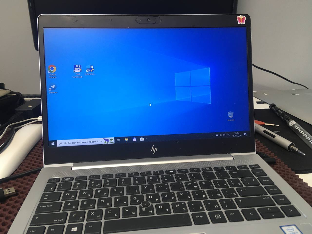

              • deeptenk
                • Sep 2023
                • 10
                • Belarus
                #267
                Send to you
                Many thanks to you. With the help of your dumps and BIOS Configuration Utility (SP100599), I won the battle with Windows Autopilot Lock. Everything works fine!
                • deeptenk
                  • Sep 2023
                  • 10
                  • Belarus
                  #268
                  No results. Only programming spi chips made effect.
